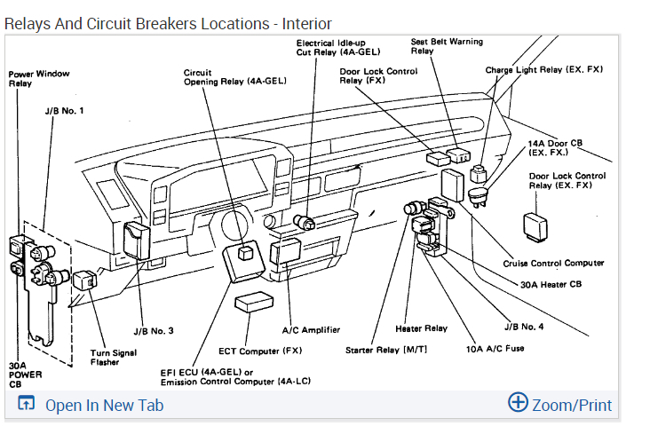

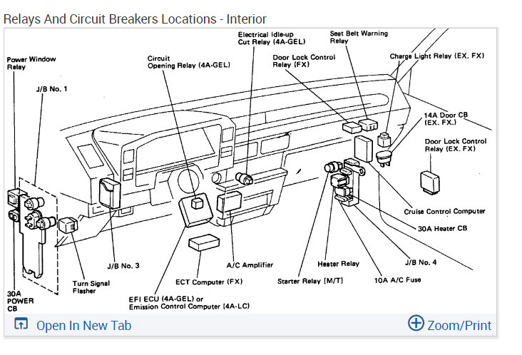

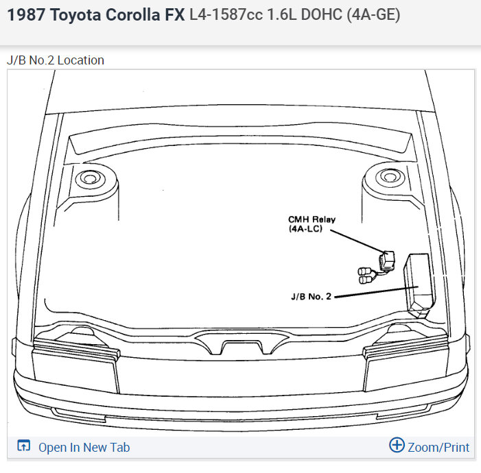

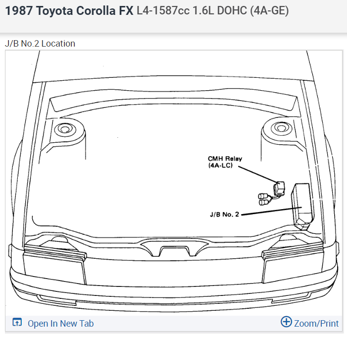

This is the same as a 1987 Toyota Corolla in the US. Did you have spark before the coil change? If so, change the coil out to the old coil because that was not the problem, and you may have a defective part. If you have spark and compression, I would try starting fluid to see if it runs that way you can say the fuel system is the problem. Also, check all system fuses here is a guide to help:
This guide can help as well:
https://www.2carpros.com/articles/car-not-running-advanced
Can I ask what the compression was on each cylinder? The more information you give us the better as can help you. Check out the images (below). Please upload pictures or videos in your response to the problem so we can see what's going on.
