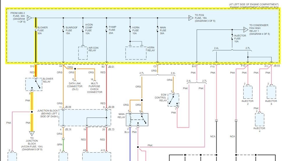

I have wiring issue if you can help. driver side front quarter panel area was damaged before I had. Need to replace inner liners that protects wiring there, I did wrap and cover.This may have happened before I taped and covered wiring in wheel well area while I was fixing a shorted etacs and a/con issue or even removing and replacing battery hitting against harnesses, I am not sure. this I am not blowing fuses but I have no power now to three 10A fuses under dash: START, A/CON SW and RR HTD IND. It started and ran before now the car now does not start of course and shifter won't move, but after I turned steering wheel back and forth I did get shifter to move, steering wheel doesn't lock. Not sure where to start with this, perhaps I touched or moved wiring that was already weak or damaged. Is that A/CON SW fuse related to issue I thought was fixed or start fuse and not sure what RR HTD IND is? Any help you can offer is appreciated. Thanks
Jan 7, 2020 at 10:19 AM
Good afternoon,

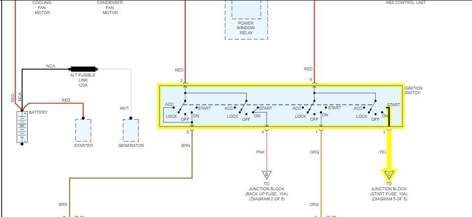

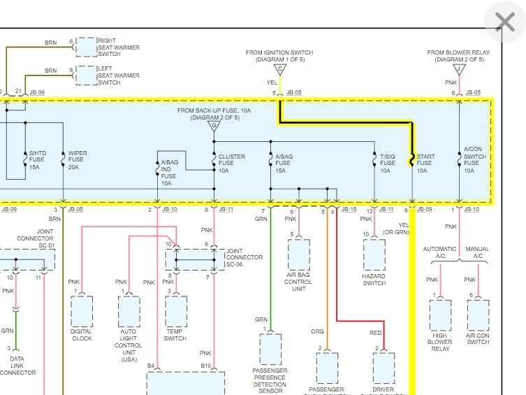

The power for the start fuse comes directly from the ignition switch. It is a yellow wire at the switch. Test it for power in the start position. I have attached the diagram showing the wire at the fuse block as well as from the switch.
The HTd fuse is fed from the ignition switch as well. in the fuse block under the hood. You will need to check that relay for power.
The A/C is fed from the blower relay under the hood in that fuse block.
Let me know if you have any other questions.
Jan 8, 2020 at 6:08 AM

The start fuse should only have power with the key in the start position.
Is that how you checked it?

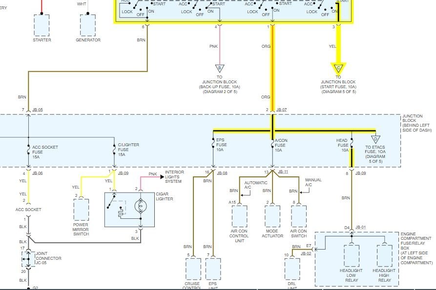

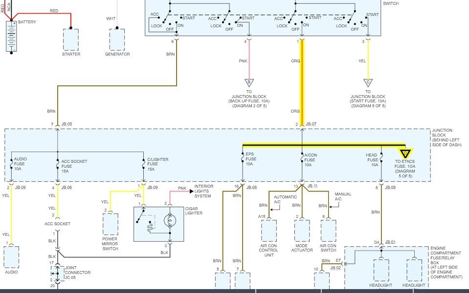

Those fuses are controlled by the ignition switch. The orange wire off the ignition switch is what feeds the power to those fuses.
Jan 11, 2020 at 3:32 AM

Okay, then it is wiring issue between the switch and the fuse block. The harness will have to be tested for the break

Hi Roy, I traced and checked orange wire to fuses. The connector was a 4 blade 3 orange and 1 black, I got continuity at black wire. Unplugged and checked out others. Now I have power to rr htd ind fuse and nothing at a/con sw fuse the start fuse meter jumped to 1300 and went down to 75. This has me baffled that when etac and a/con fuse blew all the time before I replaced blower relay, re-plugged connectors and the fan was blowing and climate control panel was lit up so put everything back wrapped wires under quarter panel and this issue started, blower quit working but climate control panel stayed lit but something seems off like it wants to change to A/C setting. and keeps going back to C from F when I reset it. It shows fan symbol as working but blower doesn't come on. Don't know if any of this helps us but thought I would mention. Thanks
Jan 16, 2020 at 12:25 AM
Okay, you have a wiring issue. It looks like somewhere in the harness is either a bad connection or frayed wire.
You will need to unwrap the harness and inspect for any damaged wires.
Jan 16, 2020 at 12:43 AM

Hi Roy, I took a break from looking at car awhile. Now I was double checking ignition wires for voltage and I had key in on position not started and got voltage from yellow wire of .78 the other 5 wires voltage was correct with battery. Is yellow only supposed to power when started? thanks
Jan 20, 2020 at 9:51 AM
Turn the key to start and see if it has battery voltage.
Jan 20, 2020 at 9:54 AM
VICKY LAMPMAN
  • 29 POSTS
Started I have .98 voltage.
Jan 20, 2020 at 10:42 AM
Not good.
Does the orange wire have power?
Jan 20, 2020 at 10:57 AM
VICKY LAMPMAN
  • 29 POSTS
yes orange has voltage , on and start. checked yellow again .41 volts this time started and .14 on position then .78 . seems voltage all over the place?
Jan 21, 2020 at 4:23 AM
It should be battery voltage. You need to replace the ignition switch.

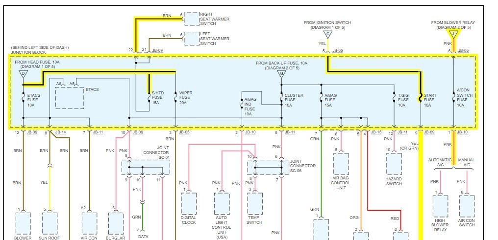

The red wire feeds the fuses, not the yellow.
I would replace the switch and then we can proceed.
Jan 21, 2020 at 10:44 AM
VICKY LAMPMAN
  • 29 POSTS
Hi, got ignition switch replaced, still have like .07 volts key turned on yellow wire at ignition when key turned to crank volts went to battery volt. On the fuses Using power probe now rr htd ind comes as grounded both points but no volts, A/C switch when applied continuity the blower came on otherwise volts like .07 and start fuse shows drop volts as well. What are your thoughts on this? thanks
Jan 26, 2020 at 3:28 PM
The yellow wire is good. It should have a battery voltage in the start position only.
The red wire needs power to the fuses. If there is no power to the fuses, the red wire is open somewhere.
