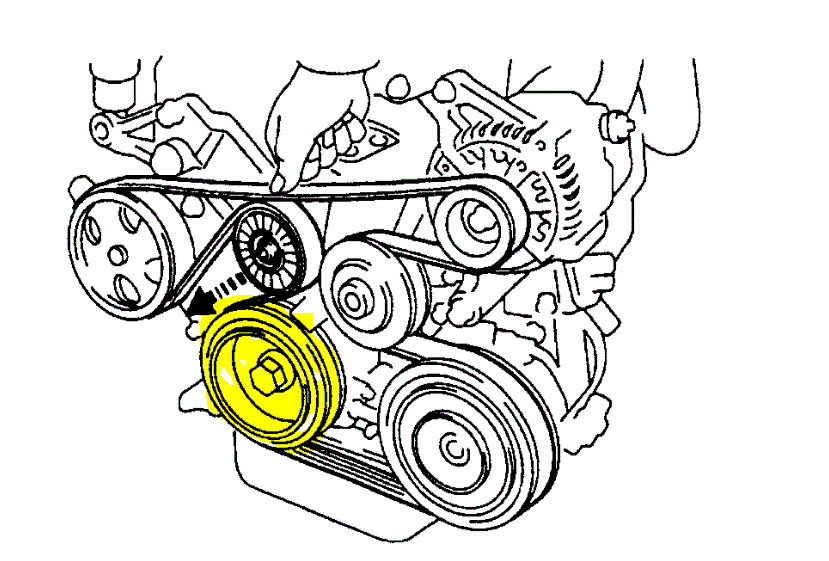

Driving, the vehicle would rev really hard while using cruise control. Going up a small hill it shut off. Jumped the car, no go. Replaced the battery, it started after pumping the gas pedal. Only drove it enough to turn it around, it shuts off again. Even then, it was very sluggish, no power.
Get it towed home. I've replaced the plugs, coils, wires, battery, battery terminals, alternator, and starter. It clicks once. Lights on the dash come up. Door open it dings. I can't hear the fuel pump engage after turning the key. I have only driven this car 30 miles. The person sold me a lemon for sure, obviously there is no warranty.
Any help?

When you turn the key to start it, you indicated only a click is heard. Do any of the other electrical components stop working and then turn back on? If so, first, confirm the battery terminals are clean and tight. Here is a link to help you:
If that checks good, we need to confirm the battery is good. Here is a simple load test you can do at home without tools:
If the battery checks good, I need you to see if the engine is locked. At the lowest pulley where the serpentine belt is run is the crankshaft pulley. You need to place a socket on it and a breaker bar. See if you can turn the engine by hand.
I attached a pic below showing the pulley and bolt I'm referring to. Also, let me know if there were any odd sounds from the engine, smoke from under the hood or exhaust, or anything you feel may be helpful.
Let me know what you find.

Battery terminals and battery are brand new. Both clean. Battery is at 13.4 volts, fully charged.
I didn't notice any smoke. We replaced the fuel filter and pump also.
Engine won't turn over manually, does that mean it's done?

Do you mean you are unable to turn the engine by using a breaker bar? If that is the case, then it is locked. Do this, remove the spark plugs and see if you can turn it.

We removed the spark plugs and tried to turn it, still nothing.

If you still can not turn the engine with the plugs removed, it likely is locked up and needs to be replaced.

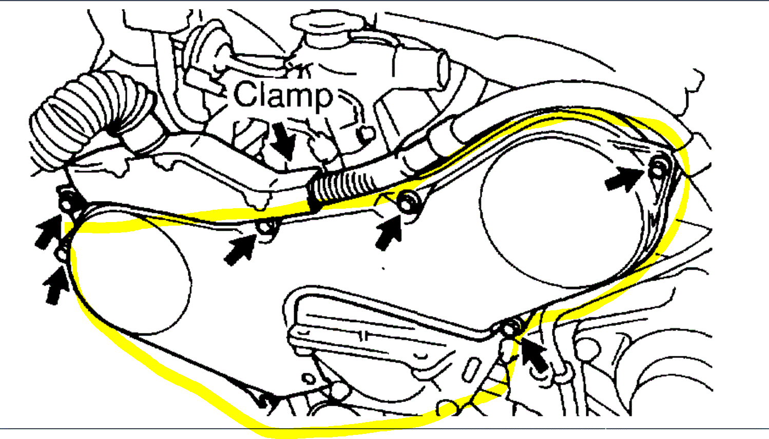

Based on everything you have described, it does sound like the engine locked up, but since there were no issues with overheating, no engine noise, and all mentioned, it doesn't make sense.
Here is one other thing to check. Remove the timing belt cover and confirm it is still properly installed and tight. See pic below. It really isn't too hard to remove. At least this way we will know if the belt somehow was jammed causing it to be stuck.
Take care. Also, I'm here to help, so don't be afraid to ask questions or let me know if there is something I can do to help.
See pic below.
