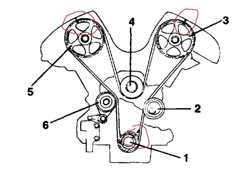

I changed the sensors of the Cam and Cram shaft- the O2 sensors (4). I cleaned the catalytic converter and I checked the timing marks. but when give start it gives explosions and it sounds like when the spark plug wires are cut. Thanks for the help.

This sounds like you might have a problem with your vehicle ignition timing. In the diagrams down below I have included a diagram of where your vehicle's ignition timing should be at. If you need instructions on how to get to your vehicle's timing belt, please let us know and we can get those right over to you.

Clean the catalytic converter? You cannot clean the catalytic converter.
Did you check the compression? I would start there to be sure the timing is correct. Backfiring is a result of a timing issue.
https://www.2carpros.com/articles/engine-backfires-while-running
Can you post a video of it cranking?
