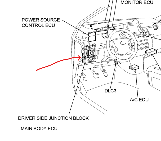

Will not start, no check Engine light, no dash lights, no multi-function display?
2008 TOYOTA PRIUS
199,000 MILES
NAVI SINGH DEOL
It doesn't lock and unlock from key fob anymore. I have changed the key fob battery. The only things that work are headlights and dome lights work when door opens. I checked voltage at front jump point n back at the battery. It’s 12v and all the fuses are good. Also tried putting in new battery but no difference. What can I do next to diagnose the problem?
Jan 15, 2023 at 3:07 AM
  • 55,394 POSTS

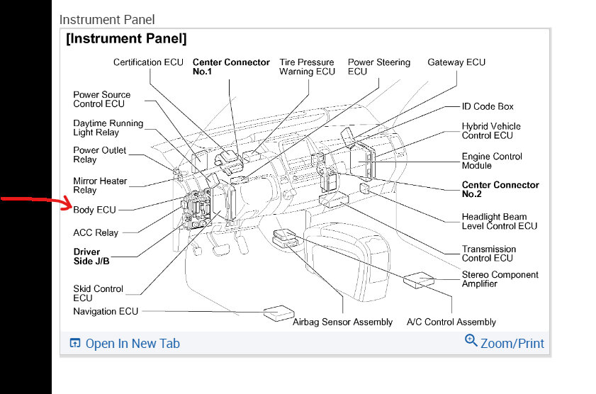

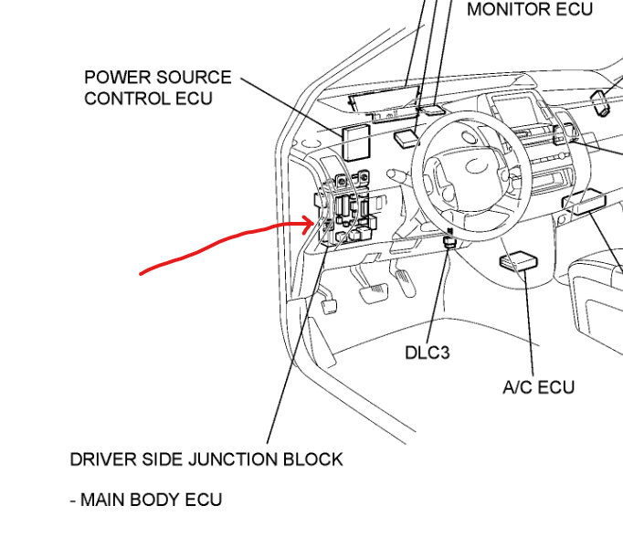

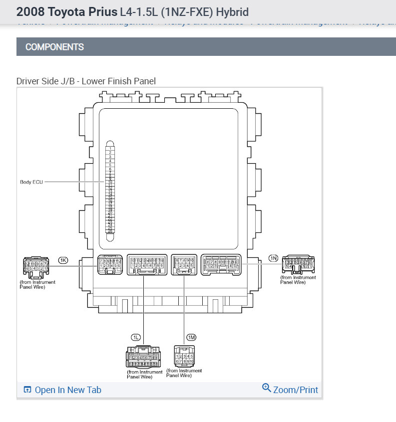

This sounds like the BCM when out, but to be sure let's run a CAN scan which is easy. You can get a CAN scanner (Controller Area Network) from Amazon for about $32.00.
here is a video to show you how:
https://youtu.be/u-4syLc-ifQ
and
Here is how to change the BCM out which you can search Google or eBay for a rebuilt unit that comes preprogrammed. Check out the images (below). Please let us know what happens.
Jan 16, 2023 at 2:38 AM

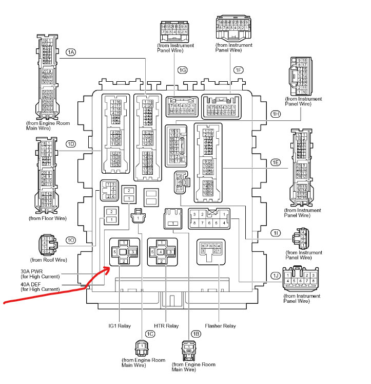

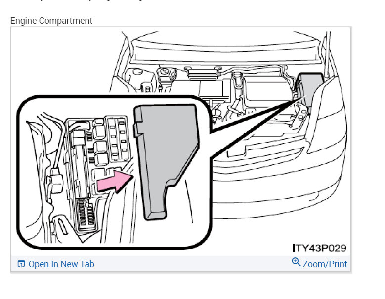

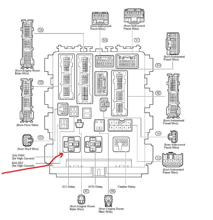

There is an IG2 relay I would swap out which supplies power to the system that is not working. The relay is located in the fuse panel under the hood on the left side.
Here is a guide to help you test it and the location in the images below:
Jan 16, 2023 at 7:53 AM
NAVI SINGH DEOL
Relays are good. I had Prius mechanic check it and he said my remote doesn’t have the smart chip inside or I lost it when replacing the battery. But the thing is I never opened that side of the remote where smart chip sits. It’s not the original key fob of the car and it’s the only one I have. Now he’s telling me I need a new key chip and he will reprogram the key. I don’t understand how the key worked before without the chip.
