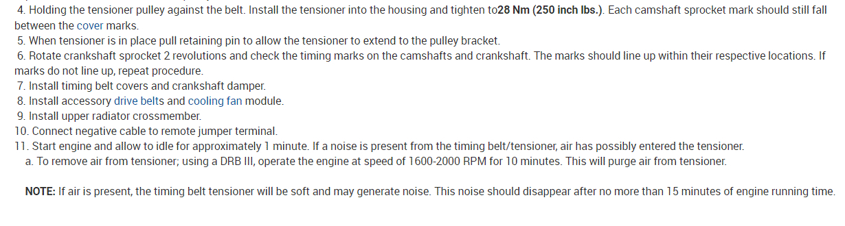

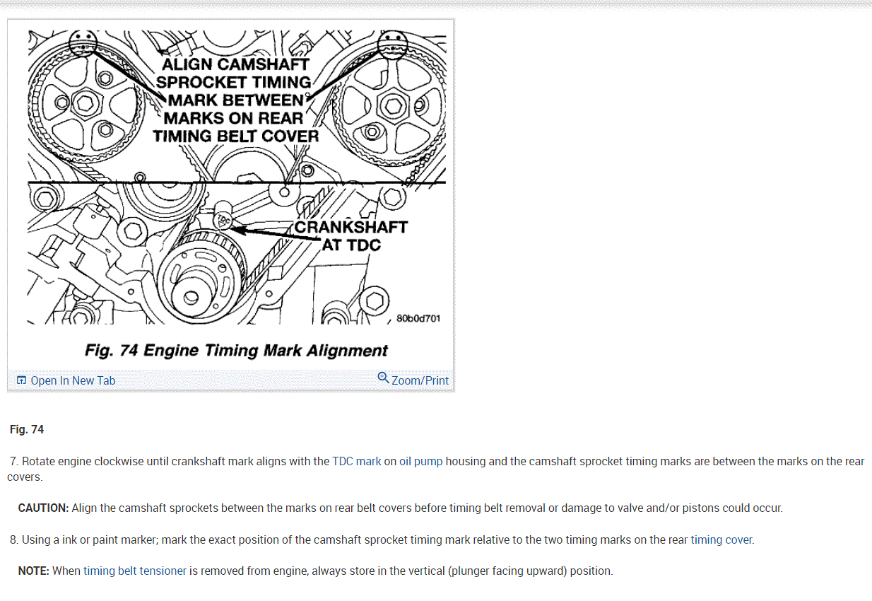

Water pump changed, TDC done before working on pump. And after. Which then affected timing. How do you retime it without pulling everything off.
Jul 3, 2021 at 1:42 AM
  • 110,244 POSTS

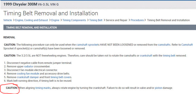

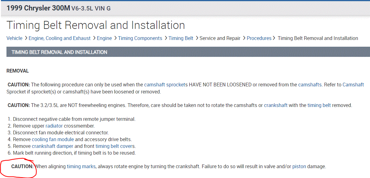

If the timing isn't correct, do not crank the engine. This is an interference engine and it will cause internal damage if the valves and pistons make contact.

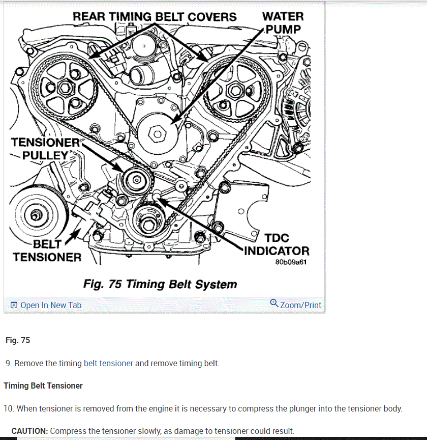

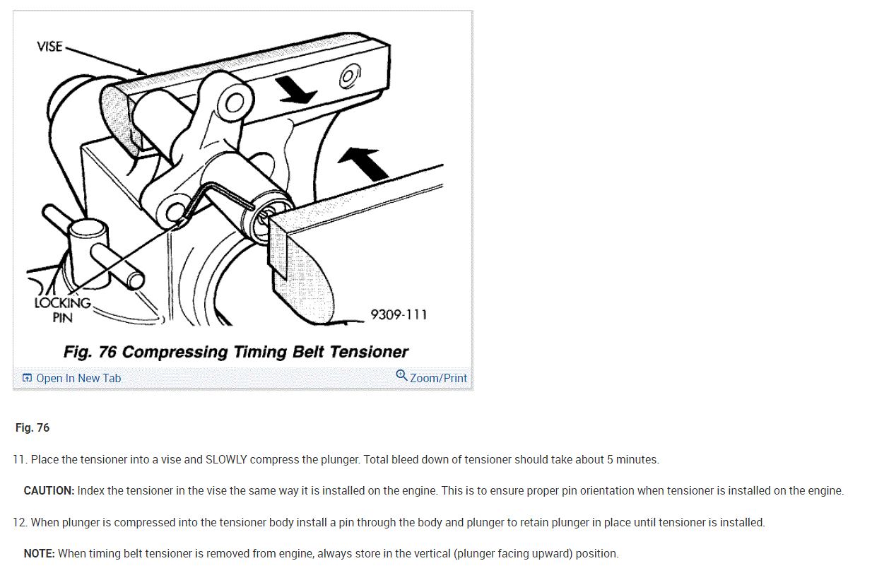

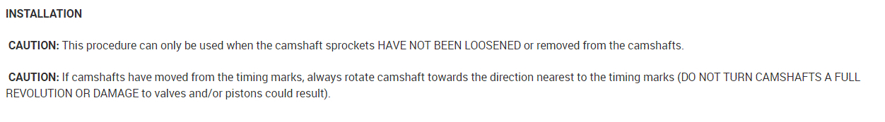

As far as timing, you need to take it apart. Otherwise, there is no way to remove tension from the belt.

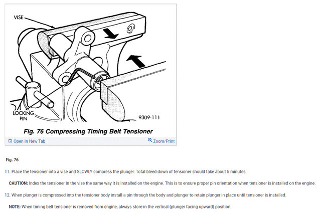

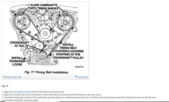

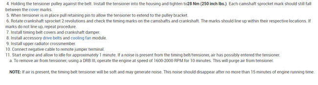

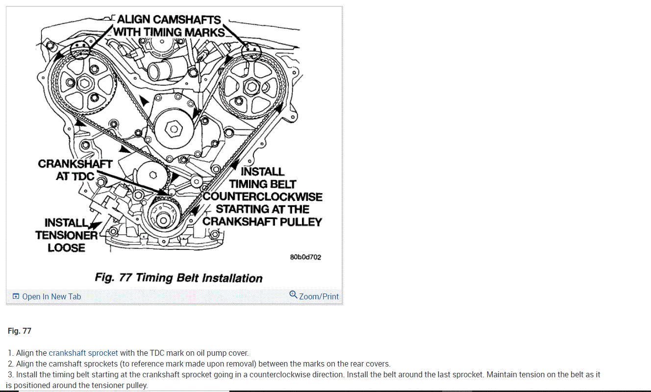

If you look at the attachments below, they provide the directions for belt replacement. Follow these directions using your old timing belt. The timing marks are indicated as well.
The directions indicate making marks when removing the belt. That won't work if it is out of time. Make sure the marks on the camshafts and the crank are aligned as indicated.
Jul 3, 2021 at 2:27 PM
SACFOX186
  • 38 POSTS
Yes, did all that. Timing marks on cams between the dots and TDC on crank was 2 lines off.. this is burning me up. Reassembled and it just crank no start. Found number 6 spark plug with lot of fuel residual...
Jul 4, 2021 at 4:07 AM
  • 110,244 POSTS
Have you been able to get it in time? If so, is it running properly now?
Jul 4, 2021 at 1:37 PM
SACFOX186
  • 38 POSTS
Yes after taking timing belt off turning crank timing by itself. Assembly of belt, tensioner, the whole thing. Did not turn it 2 times afterward. Once assembled it started and ran smooth.. now the coolant business. Iol. Will it work?
