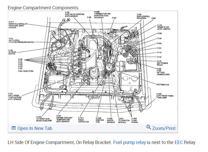

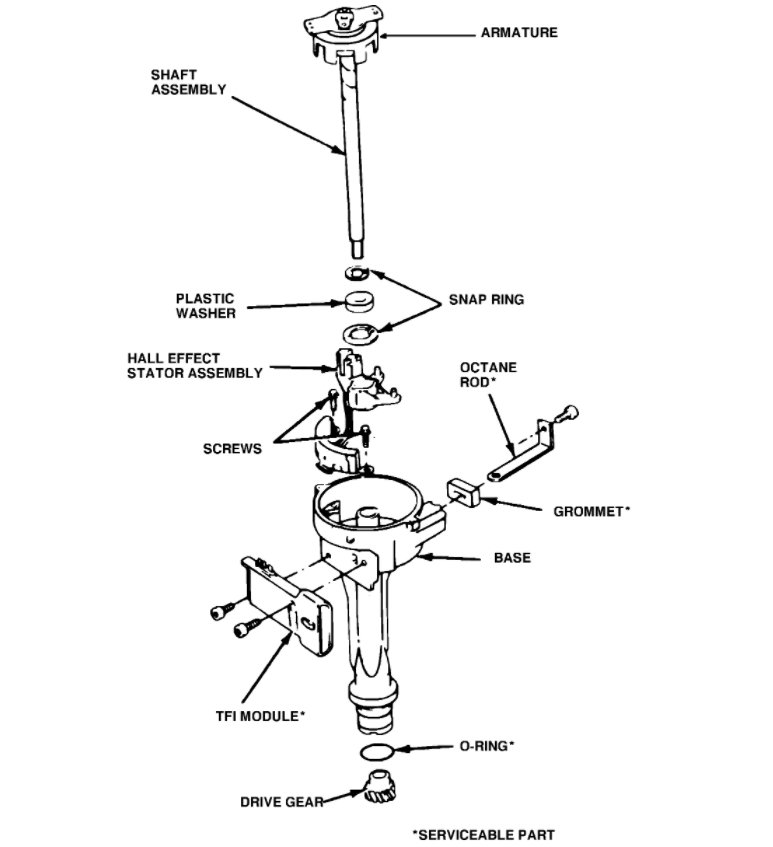

This sounds like a classic ignition module which they had big problems with. Here is the location so you can change it out to see what happens. If you did the ignition module with the distributor please test the EEC relay here is a guide to help with the location in the diagrams below:

Replaced both relays and the TFI on this distributor doesn't have the three contacts at the rear and was replaced with new distributor.

Lets try the EEC relay test or replacement. please let me know.

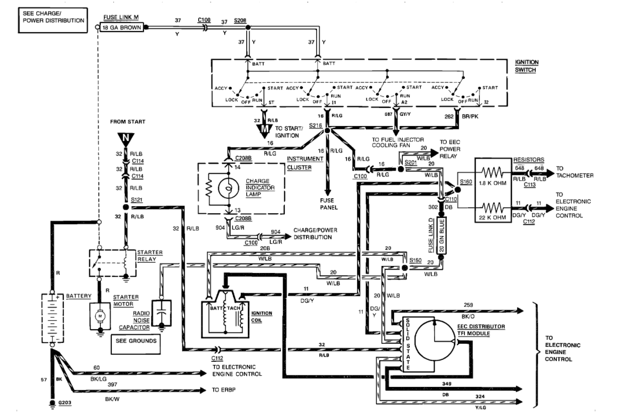

Let's check the ignition switch if one "leg of the switch is bad it will not get complete power to the ECM. here is a guide to help and the ignition switch wiring diagrams below:
