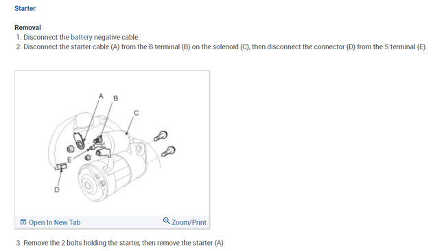

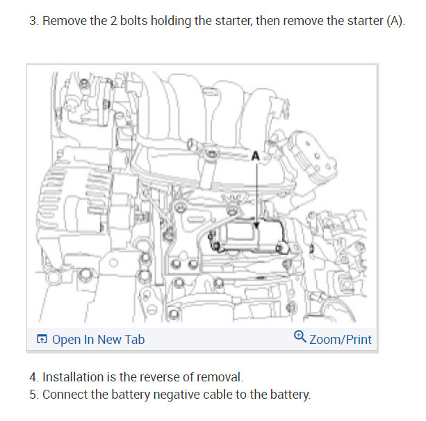

Full battery, tried to jump still won't turn on giving one click that's it.
Sunday, August 1st, 2021 AT 3:49 AM
MECHANIC
52,796 POSTS
Good morning,
What is the battery voltage? Check it with a voltmeter. I attached a guide for you to review.
You may have a bad battery but we need to start there.

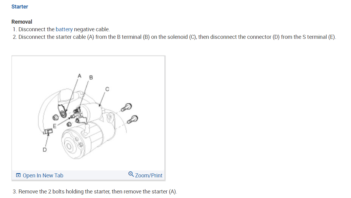

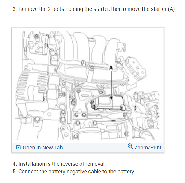

Beyond that, one single click could indicate a failed starter motor. I attached the procedure for you for the starter below.
