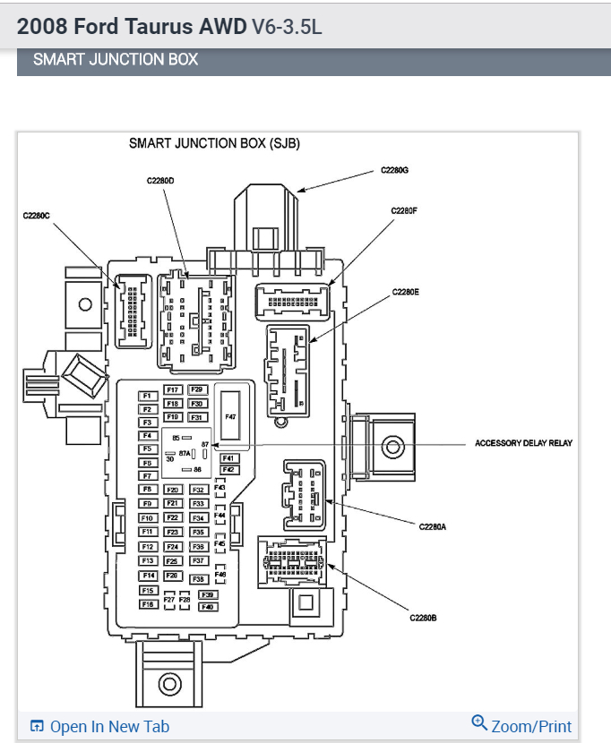

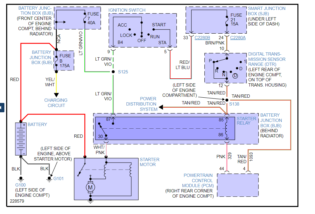

I went to start the car and it would not start, no clicking?
2007 FORD TAURUS
170,000 MILES • 3.0L • 3 CYL • 4WD • AUTOMATIC
KAUM

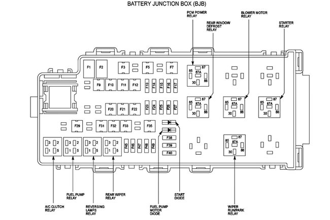

I replaced the starter still nothing, replaced battery still nothing, replaced starter relay fuse still nothing. I'm at a loss, I don't know what's going on. Any suggestions could help.

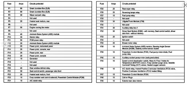

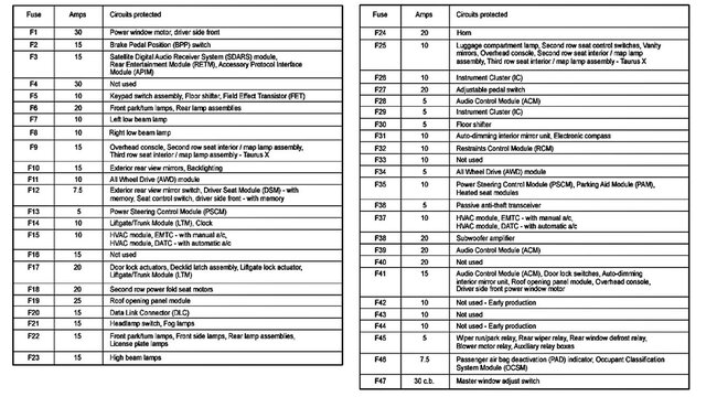

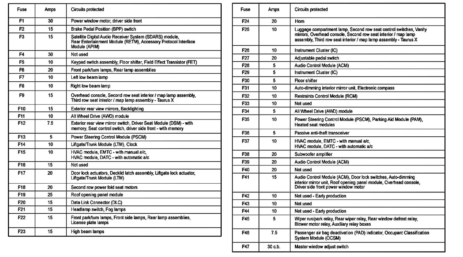

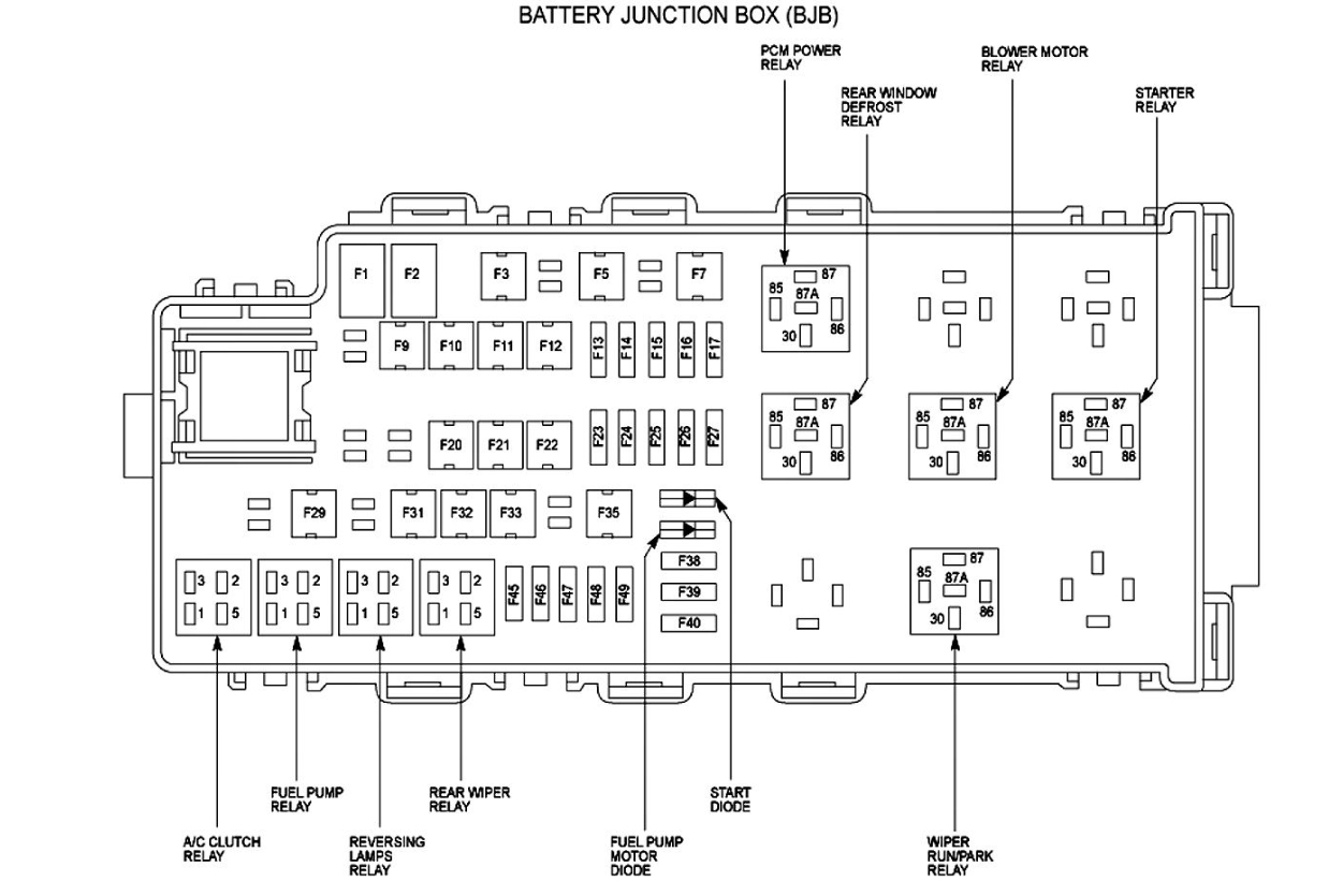

I would check for power at fuse #7 and maxi fuse B in the engine compartment fuse panel and then fuse #21 in the SJB which is the fuse panel inside the car. here is a guide to help test with the key on, also I have included the starter wiring diagrams so you can see how the system works.
This guide can help as well:
Check out the images (below). Let us know what happens and please upload pictures or videos of the problem.
