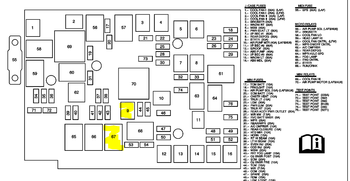

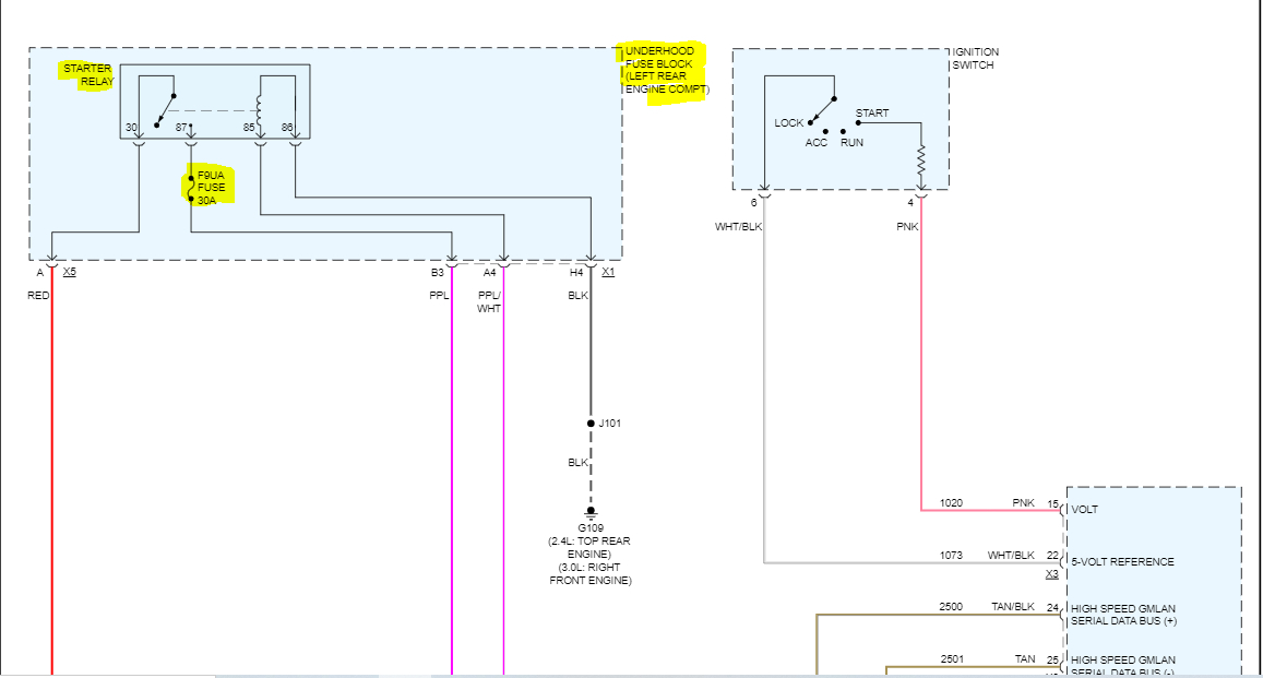

No crank no start conditions code p627 code p0315 and code p69e.
Mar 21, 2023 at 7:38 AM
  • 110,240 POSTS
Two of the codes, P0627 and P069E, are related to the fuel pump control module. The P0315 indicates the crankshaft variation relearn procedure hasn't been completed, but this will not prevent it from starting.
We need to first determine the no-crank issue. I have attached two pics below. The first is the schematic which indicates both a relay and a fuse related to the starter. First, check the fuse I highlighted in pic 2 (fuse 9) which is the under-hood fuse box.
In addition to checking the fuse, it is important to confirm power is present.
Here is a link that explains how:
Also, switch the relay (67) with a different one with the same part number to see if that makes a difference.
Start with this and let me know what is found.
