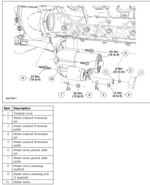

My truck when key is put in the forward position interior lights flicker and dash lights on and off. I can hear the radio changing CD's and when I try to start it just makes a clicking noise. battery is good. any idea what it might be?

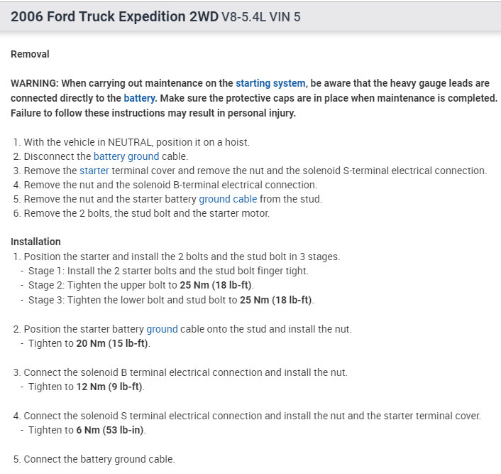

You might want to verify battery is fully charged if it's a continued repetitive clicking. If just a single click you might be having trouble with the starter solenoid on the starter motor.Most local auto parts stores will test your starter motor for free.Here is a tutorial showing what's involved for its removal:
I've attached pictures below as step-by-step instructions and location for your Expedition.Hope this helps and thanks for using 2CarPros.
