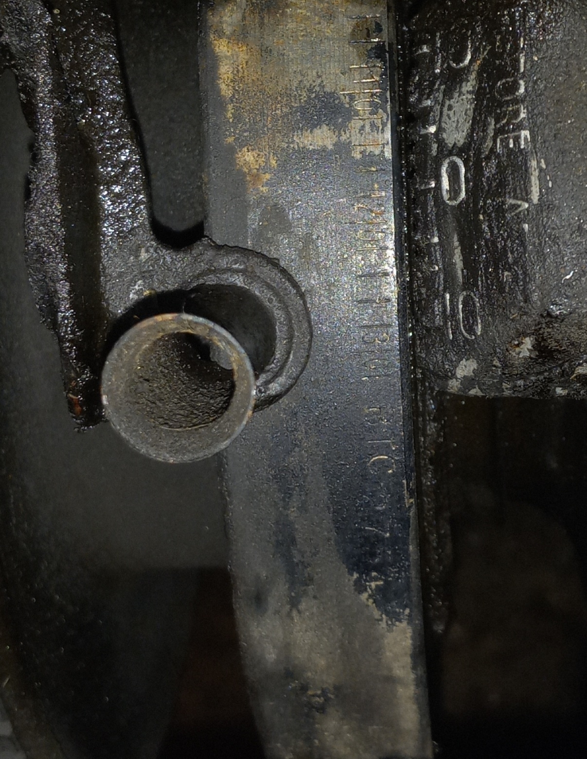

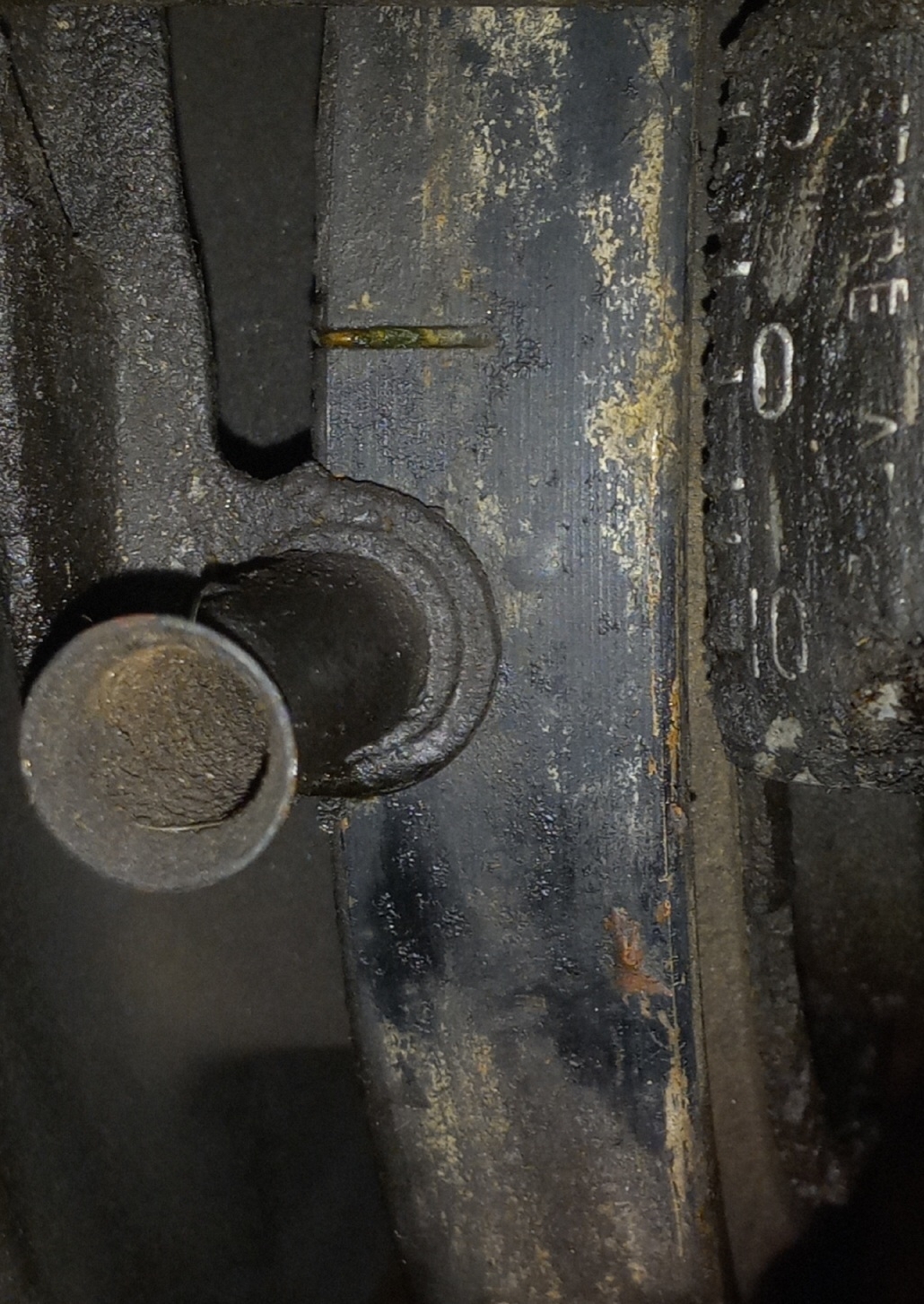

Okay, so there is more than one mark on the pulley. Is one of these the mythical magic mark? I've tried looking for the info elsewhere, but I can't seem to find it.
Jul 27, 2023 at 4:37 AM
  • 110,244 POSTS

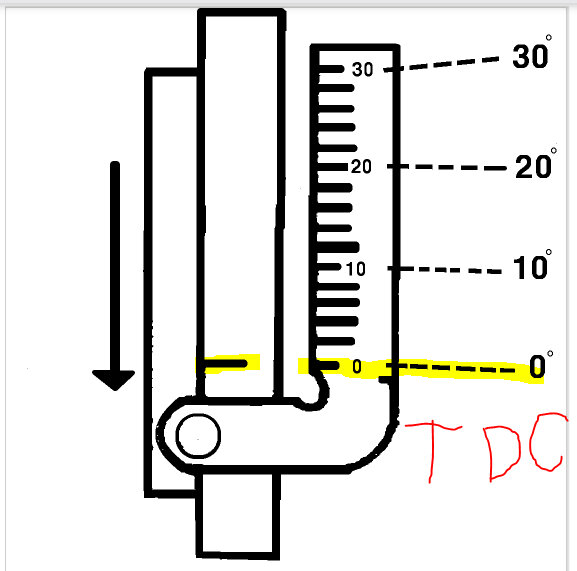

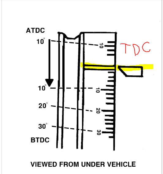

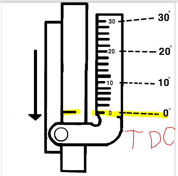

I attached two pics below. Your truck's design could be one or the other. I highlighted the mark on the pulley. When it is in line with the indicator "0" on the pointer, that is top dead center (TDC). Note there are indicators BTDC and ATDC. They simply indicate before and after top dead center.
Let me know if you find it.
Jul 27, 2023 at 1:17 PM
GCROW
  • 57 POSTS
Here is what I see. The first is one of three identical tic marks. The second has a mark that goes does look like its been cut and has all the little tics, etc. I just wanted to ensure it is the second that I am looking for. Either way, the distributor rotor...."sigh"....is 180 off.
Jul 28, 2023 at 6:24 AM
  • 110,244 POSTS

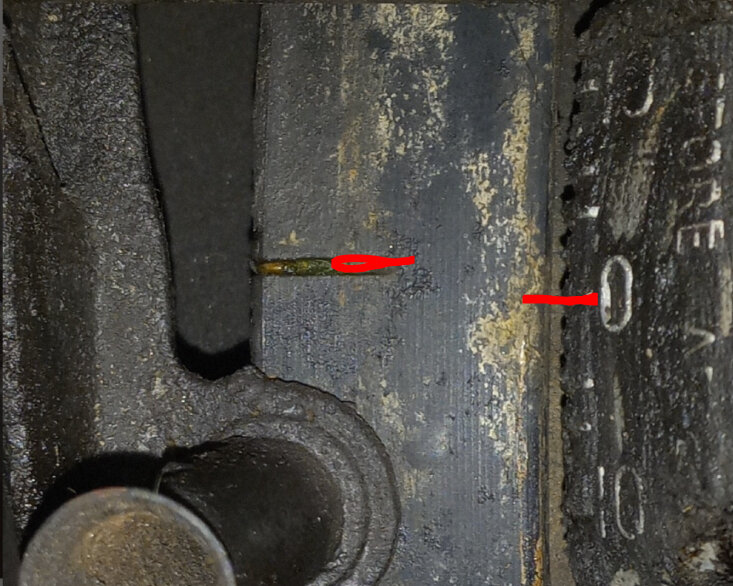

I had a feeling it was timing related. I copied pic 1 of yours. I drew a red line showing where TDC is found. In the pic, it is slightly off. The two lines I made need to be straight across.
If it is 180 degrees out, pull the distributor out and give it a turn to align it.
Let me know the results.
See pic below.

The different marks are indicators for before or after top dead center. And to answer your question, the mark on the pulley needs to be aligned with the 0. If you go one way or the other, you won't get the distributor in the right position.

Greg, your questions are absolutely no problem at all. But, now you have me confused.

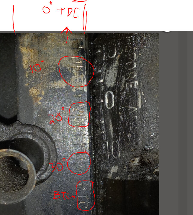

You attached two pics above. In the picture on the left, I only see one mark on the pulley/harmonic balancer. Is there another one?
In pic 2, there are several marks. They all indicate different degrees of timing.
If you look below, I copied your second pic. At the very bottom, it says BTC, which means before top center. As you work your way up, it first indicates 30 degrees, then 20 degrees, and then 10 degrees. If you continue a little further, you should find 0 degrees or TDC.
Sorry for the pathetic drawing. LOL, I didn't know how else to point up further.
See pic below.

Again, I am very sorry for all the confusion. There are just so many marks on the pulley, when I go to line anything up, I get a tad lost. I blame it all on the brain thuds the military says I had. Lol. In all, there are the marks you just outlined, the one you outlined previously, and two more individual marks on the pulley. And like I say, I don't want to line up the wrong one.

No need to apologize for the artwork. Lol. I just want to make sure I am putting the correct marks in the correct place. Of all the marks on the pulley, I have gotten confused on where to focus my attention. Should I use the set with degrees, or one of the three individual marks like in the first picture?
Jul 31, 2023 at 1:06 PM
  • 110,244 POSTS
The first picture is clearer. It shows 0 degrees. That is the one I would use.
