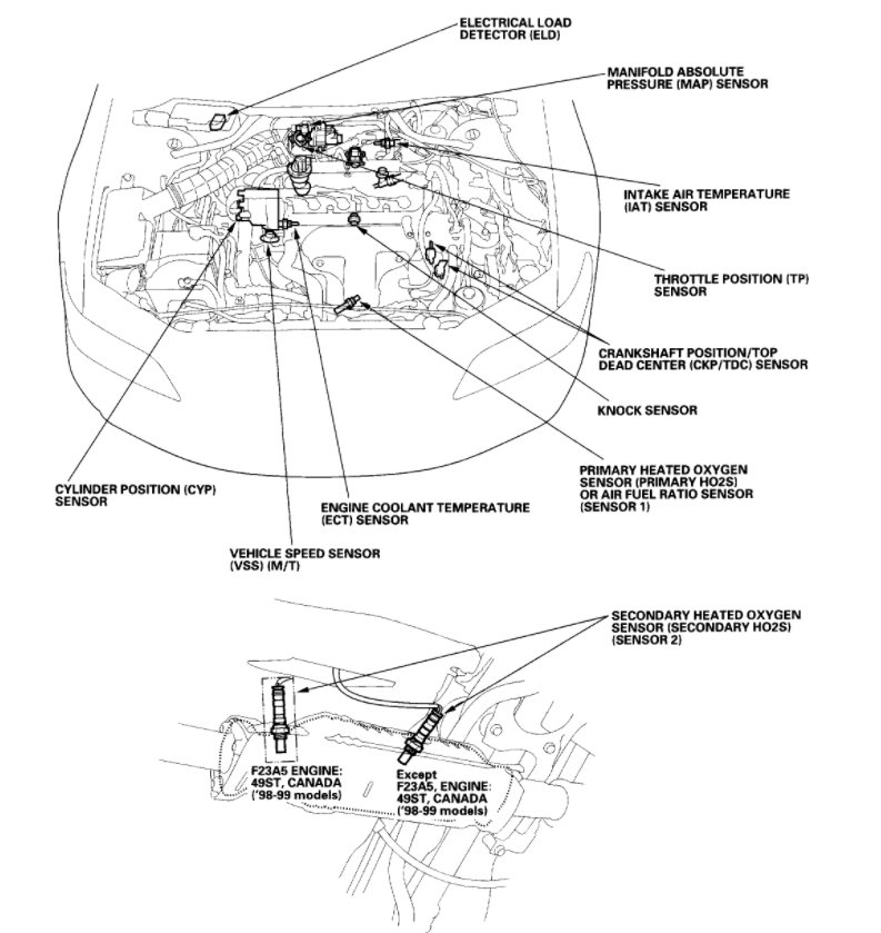

Engine cranks but not getting any gas or spark
210,235 MILES • 2.3L • 4 CYL • 2WD • AUTOMATIC
WAUCZIE

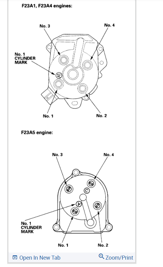

New fuel pump, MAP sensor, IAC, TPS, EGR, Temperature sensor (Rad), Main fuel Relay. Maybe it's something to do with Honda Accord immobilizer. I'm lost now, before problem car run great.
Jun 11, 2022 at 2:00 PM
  • 55,500 POSTS

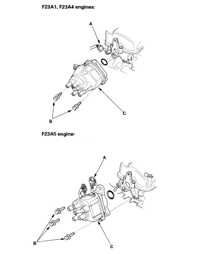

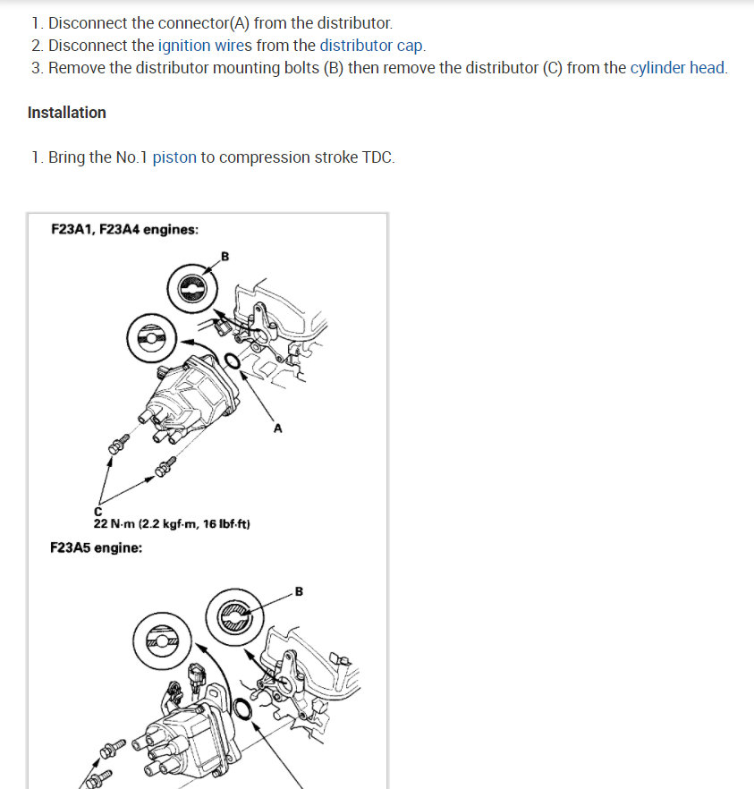

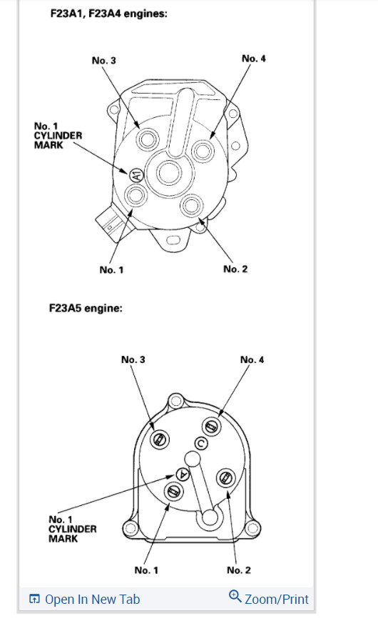

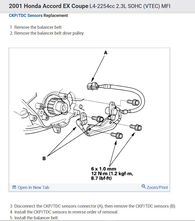

This sounds like a typical crankshaft position sensor. We should run the codes even though when the sensor fails it will not through a code, but you should be able to watch the tachometer move or RPMs on the scanner. Here are two guides to help and the crankshaft position location in the diagrams below:

WAUCZIE
I have the TDC CKP Sensor and will switch out and post the results.
