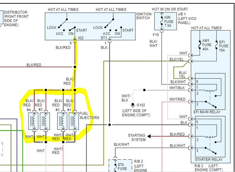

Truck listed above has a2.7L 3RZ. Have 48 PSI at fuel delivery pipe when cranking, Injectors are clicking when cranking according to inspection with long screwdriver to ear, spark and compression seem fine because engine runs for a few seconds when shooting starting fluid into air intake. Just finished a valve job and a thorough cleaning of just about every nook and cranny. Engine was running fine before work but had oil leaking from the oil pump and who else knows where. Didn't mess with crankshaft and pistons but replaced just about every gasket and inspected everything I could while torn down. Installed new oil pump, water pump, harmonic balancer, two coolant temp sensors, EGR valve, spark plugs, plug wires, and injectors. Replaced all vacuum hoses. Thoroughly cleaned throttle body and intake plenum all vacuum valves and sensors and their connections. Crankshaft position sensor test within ohms specs. Cleaned MAF sensor which does fluctuate voltage with air blown through venturi. Distributor coil test within ohms specs. Waiting on OBD2 scanner from Amazon to check error codes. Was certain I got timing chain gears set correctly but now I am second guessing myself. Could timing be off even though engine runs with starting fluid? Could injectors not be firing even though clicking or maybe just not opening enough to pass fuel? I am baffled. What do you think could be my problem??

The idea that you hear the injectors, but it only runs on starting fluid leads me to think there could be a timing issue. However, I would think if it ran on starting fluid, it would do the same on gas.
Here is what I need you to do:
At each injector, there will be a black wire with a red tracer. With the key in the run position, each injector should have 12v at that wire. Confirm that is the case.
If there is, we need to check for a ground path. Take a test lamp and connector the alligator clip side to the battery positive. Probe the other wire (other than the black/red) with the test light and have a helper crank the engine. The test light should flash.
See pic below. Try this and let me know what you find.

I got my scanner early this morning and discovered P0115 and that a coolant temperature sensor circuit was open. Seems I broke the connector when cleaning or reconnecting it. Will change it soon but just reinstalled it for now and have a connection. Great! But not so great :( Engine does start up but only runs for 3 seconds or so. What the heck! Any thoughts?? I am investigating now and will get back to you. Thanks

Still stumped here Joe. Not throwing any error codes. I've been searching forums and thought maybe I installed my distributor off by a tooth, but that seems to be fine. Tried running with MAF unplugged, but no good. Tested and cleaned IAC but still no luck. Like I said it runs for 3 seconds or so pretty smoothly then suddenly shuts down like maybe fuel pressure just disappears. Can crank it again right away and does the same thing. I'll borrow fuel pressure tester again from Orielly's tomorrow and monitor while trying to start.
