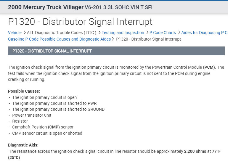

Van will not start, there is no spark. got code with my code p1320. i change the coil, still nothing. can you help me?

You might be having an issue with the CMP (camshaft position sensor) This would be next thing to check since you replaced coil. Here is a tutorial showing how to replace:
https://www.2carpros.com/articles/camshaft-angle-sensor-replacement
I've attached a picture below on what to check for your vehicle.Hope this helps and thanks for using 2CarPros.
