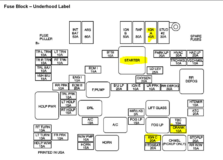

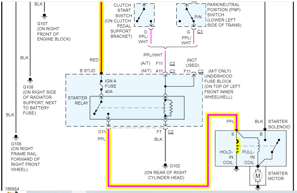

I replaced the starter and the electrical ignition switch, and I turn the key it makes noises but won't start. I have to jump to start a solenoid with a screwdriver and I believe it has something to do with this third little red wire connected to it and then that wire goes to the battery.

Next, if you are able to engage at the starter, then I need you to check a few things. I attached the wiring schematic for the starting system below, so you have a reference.

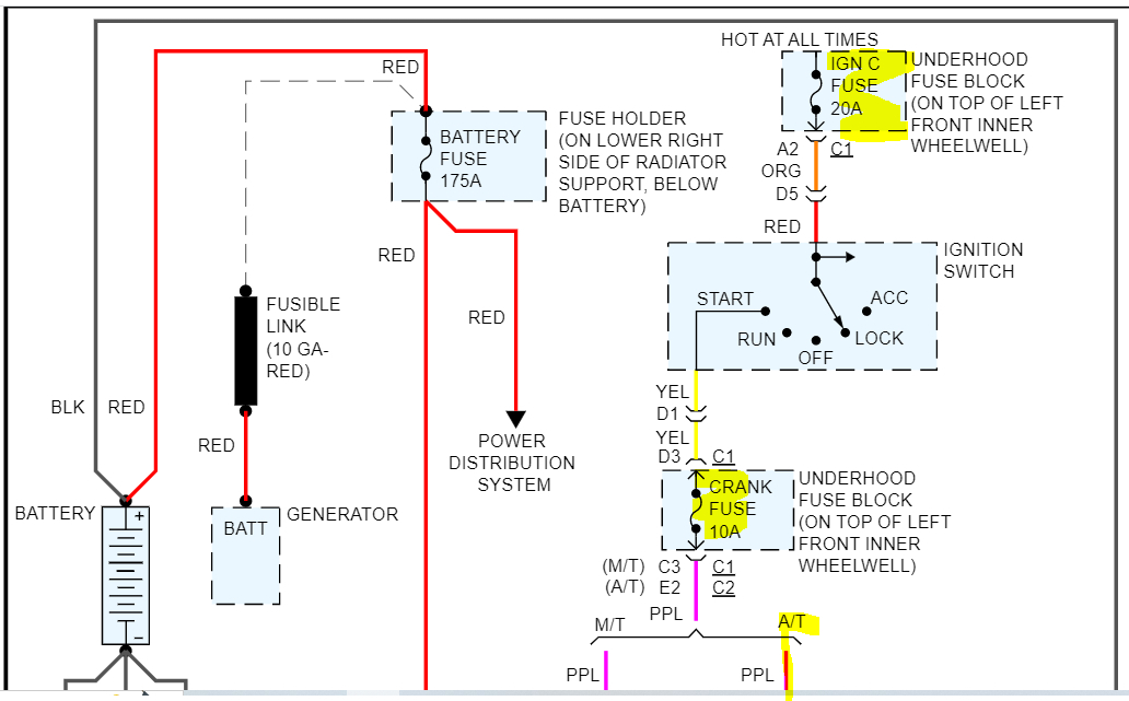

First, in the under-hood fuse box, there are three fuses I need checked, the Ignition C fuse, the Ignition A fuse, and the crank fuse. When you check these, not only do I need you to check the fuses' conditions, but it is important to confirm there is power to them.

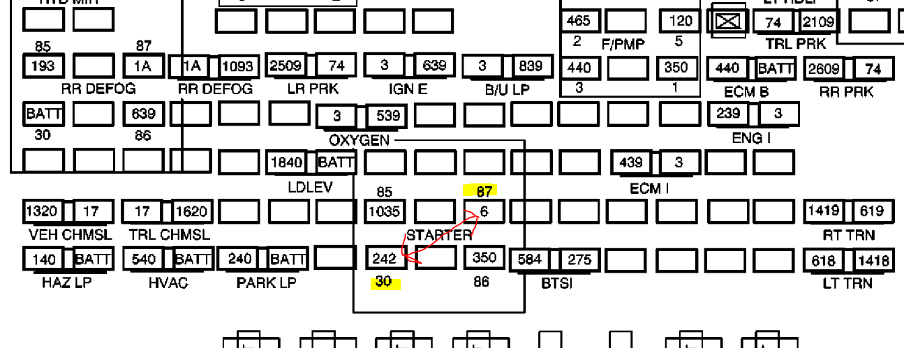

If the fuses are good, remove the starter relay and switch it with a different one having the same part number. If there isn't one, here is a link that explains how to test it:
If the relay tests good, note that there are pin identification numbers on the relay. I want you to take a jumper wire and jump pins 87 and 30. See pic 4.
Pic 3 provides the fuse and relay locations.
