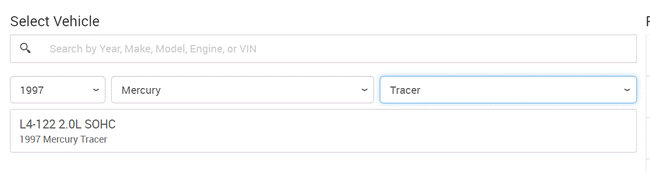

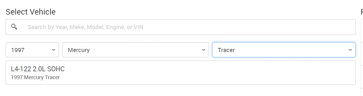

Let me know what you find or if you have other questions. Additionally, I am only showing a 2.0L engine for this vehicle. Can you confirm the engine size for me?
Feb 14, 2022 at 5:51 PM
BUTCH19600
My mistake on engine size. Tried starting fluid earlier with no results. The car shut off as soon as got it off the road and came to a stop.

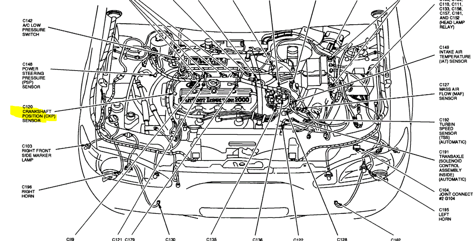

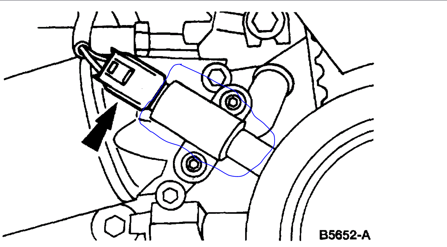

If there was no change, we would have one of two things happening. First, the crankshaft position sensor has been damaged and we lost spark to the plugs (see pics 1 and 2), or the timing is off.
Since this happened when the belt broke, my first suspect is the crankshaft position sensor wiring or the sensor itself has been damaged.
Using the pics below, locate the sensor and inspect the wiring, connector, and sensor
Check that first and let me know the results. Also, if you have a live data scan tool, check to see if there is an RPM signal when cranking the engine or if there is a tachometer in the vehicle, see if it moves a bit when cranking.
If the sensor appears good, do me a favor. Record it cranking and upload it for me to hear. I just want to make sure we haven't jumped timing.
I will watch for your reply.
See pics below. (Pic 2 shows the sensor. It is right beside the crankshaft pulley).
