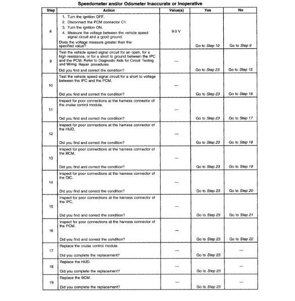

We had the speed sensor change and it drove good for a day or two but the speedometer stop working and now it does not shift out of first.
Aug 4, 2018 at 6:32 AM
Experienced Mechanic
52,796 POSTS
Good afternoon.

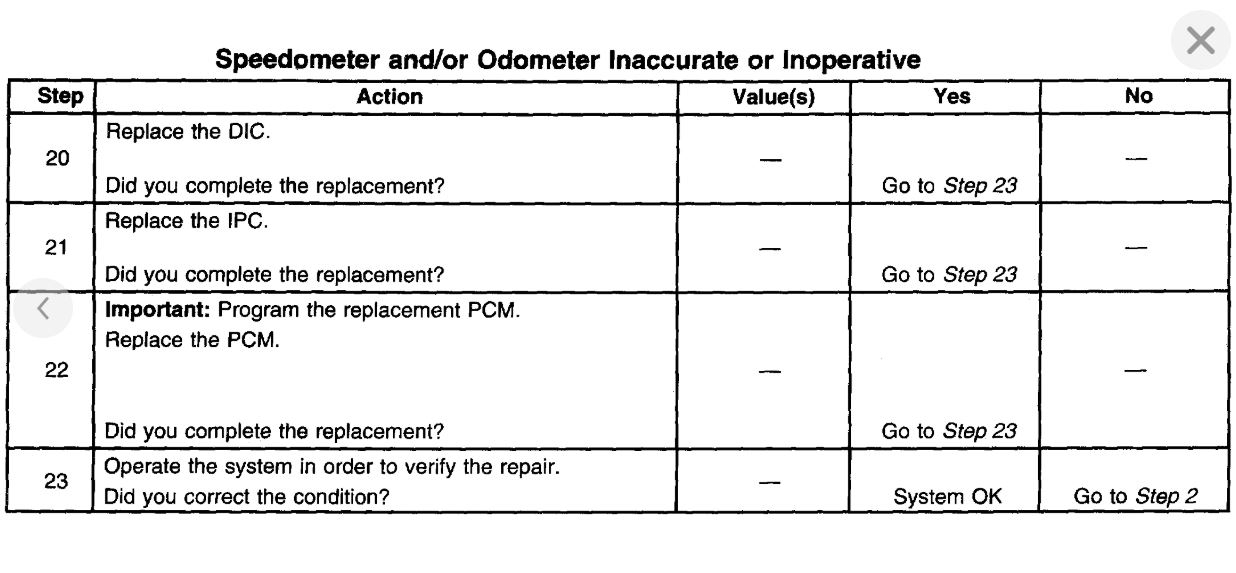

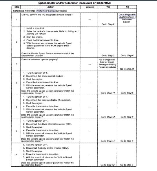

The reason the transmission will not shift is the speedometer is not sending a signal to the PCM.
The first thing I would check is the connector at the sensor. They are common for failing from either loose pins, damaged pins or burned pins.
