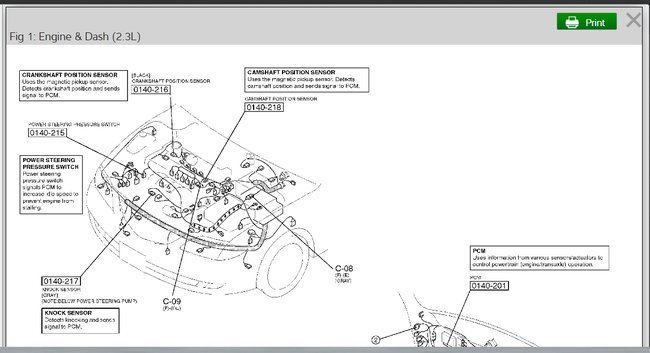

This could be a problem with your vehicle's Crankshaft Position Sensor (CKP). It is used by your vehicle's Power-train Control Module (PCM) to determine the rotational speed of the crankshaft for ignition timing and misfire monitor. Without this signal the PCM will not fire the spark plugs. I have included a few links for you to go to below:
https://www.2carpros.com/articles/how-a-crank-shaft-angle-sensor-works
I have also included in the diagrams down below the location of the CKP for your vehicle. Please go through the guides and get back to us with what you are able to find out.

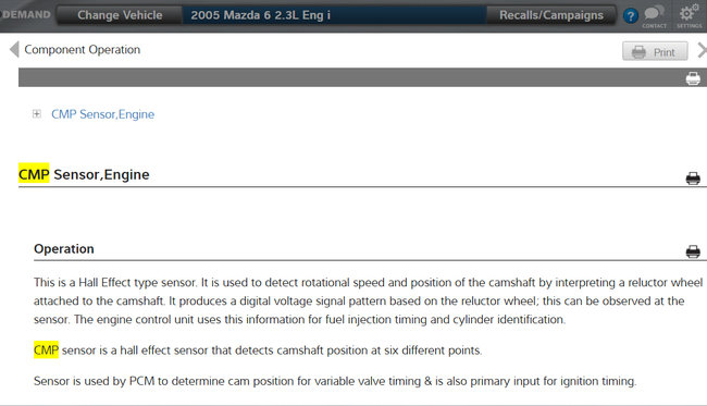

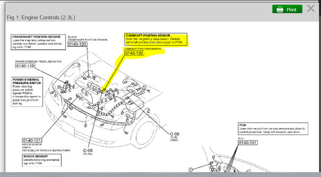

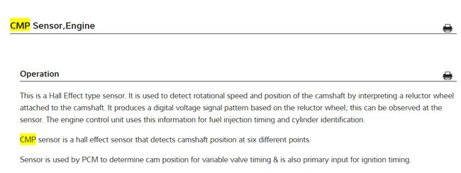

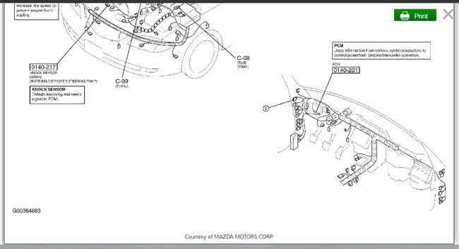

Okay, the CKP is good, so let's move on to the Camshaft Position Sensor(CMP). The CMP detects the rotational speed of your vehicle's camshafts for fuel injector timing and to keep track of #1 cylinder, specifically when it's at Top Dead Center(TDC) of the compression stroke. Without the signal from the CMP the PCM in your vehicle will not know when to energize the fuel injectors and your vehicle will not start. I have included a description of the CMP's operation and location in the diagrams down below. Please go through this information and get back to us with what you are able to find out.

Thank you for your reaponse. The car jas had the alternator changed, the main 100a fuse in the fuse box under the hood because everything eent out on the car. Once ee changed that fuse everything turned on, dashboard lights, signals, stereo, windows, etc except tge car. It will only crank. We then changed the crankshaft position sensor, nothing. Then we changed the coil, nothing. My dad says there is no spark when trying to turn on so there is no energy going thru to give the car enough to turn on. Will the camshaft be the problem? My dad asked another mechanic and he says it could be the computer but the check engine light is on. When he checks why its on it gives him no codes. Should I go ahead and try the camshaft sensor change?
May 16, 2019 at 5:43 AM
SCGRANTURISMO
  • 4,897 POSTS
Yes,
On your vehicle the Camshaft Position Sensor (CMP) is used for the fuel injection and spark timing as per my last answer. I have included in the diagrams down below a description of the CMP for your vehicle. Please go through it and get back to us with what you are able to find out.

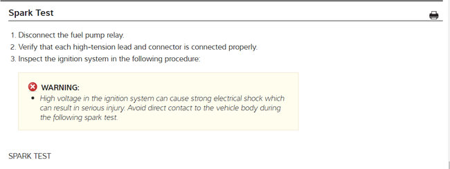

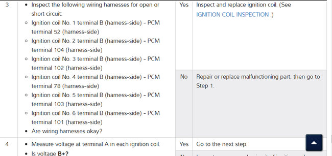

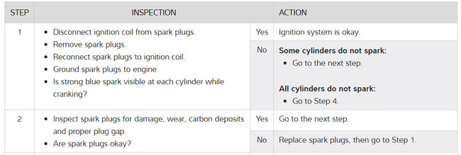

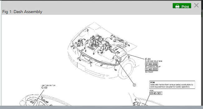

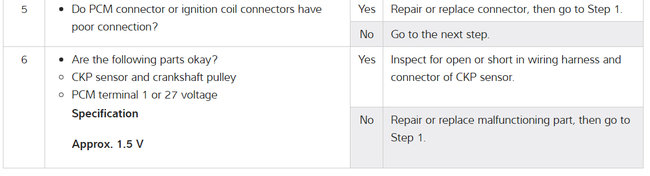

Okay. I'm also thinking that it is going to be your vehicle's Power-train Control Module (PCM) that is at fault on your vehicle. To be sure though, I have included the Mazda factory Spark Test in the diagrams down below. Please go through it and get back to us with what you are able to find out.

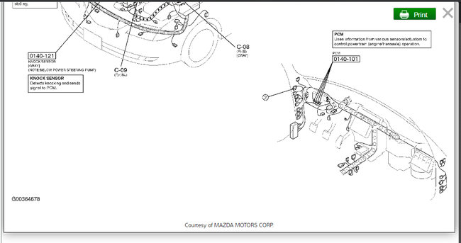

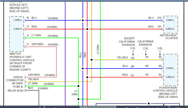

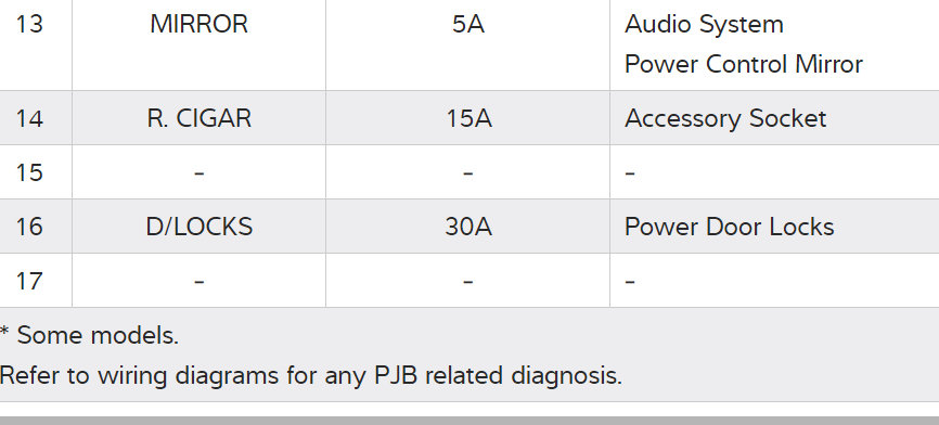

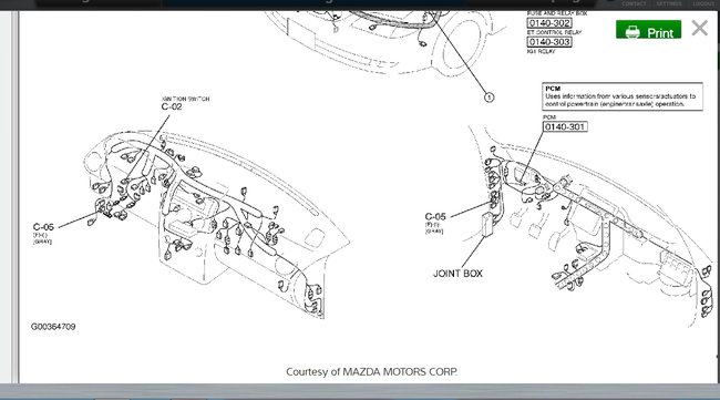

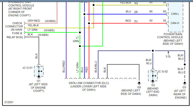

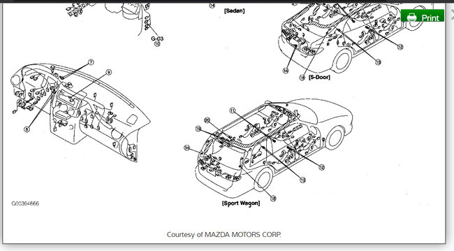

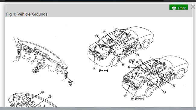

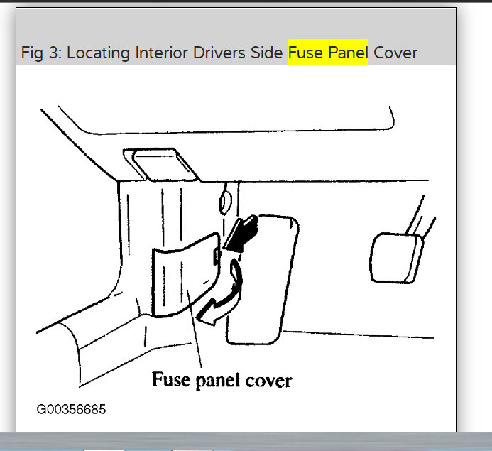

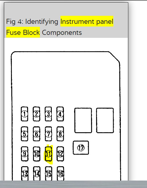

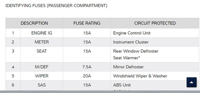

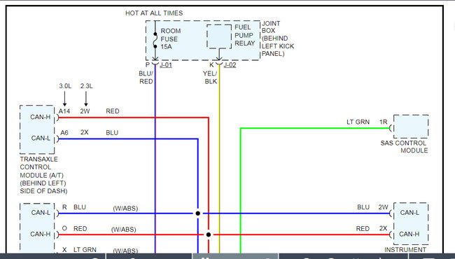

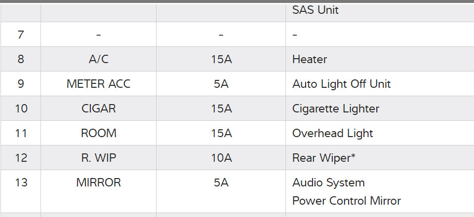

Okay when you turn the key on the "check engine" light comes on and stays on but you can't get a code from the code reader. This does sound like a an internal PCM short, nut lets double check to make sure we're getting power and ground at the Data Link Connector (DLC) just to be sure. I need you to check fuse #11(15A)(Room Fuse) in the Joint Box under the left hand side kick panel and Ground #8 behind the left side of the dash. When checking the fuse make sure that it is clean, tight, corrosion free, and making good metal to metal contact. I have included wiring diagrams, diagrams, and component locations in the diagrams down below. Please get back to us with what you find.
