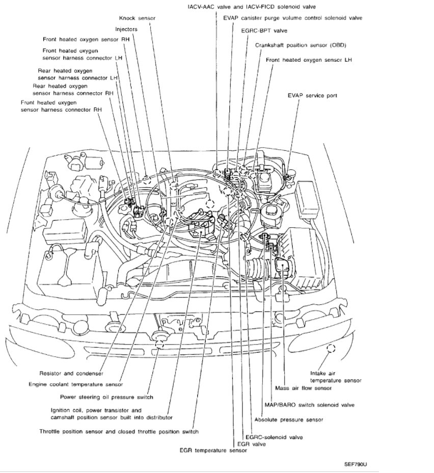

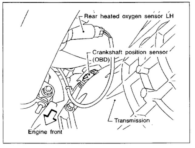

injectors has no spark and the fuel pump runs all the time.
Jun 20, 2017 at 12:58 AM
  • 54,854 POSTS
It sounds like you have two problems, first the fuel pump relay is stuck on and needs to be replaced and for the spark it sounds like you need a crankshaft angle sensor.
Here is a guide that will show you what you are in for when doing the job.
Here are diagrams (below) on where it is in your car.
