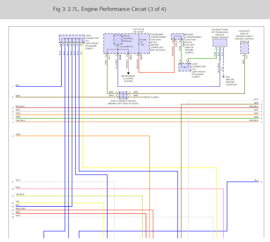

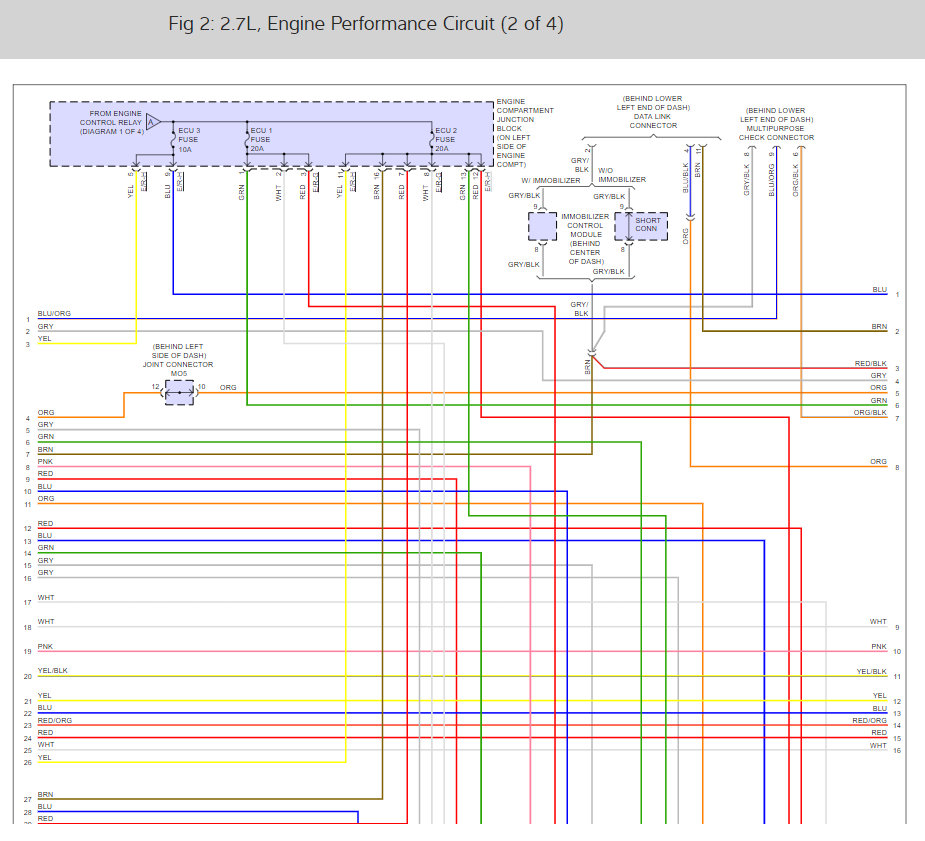

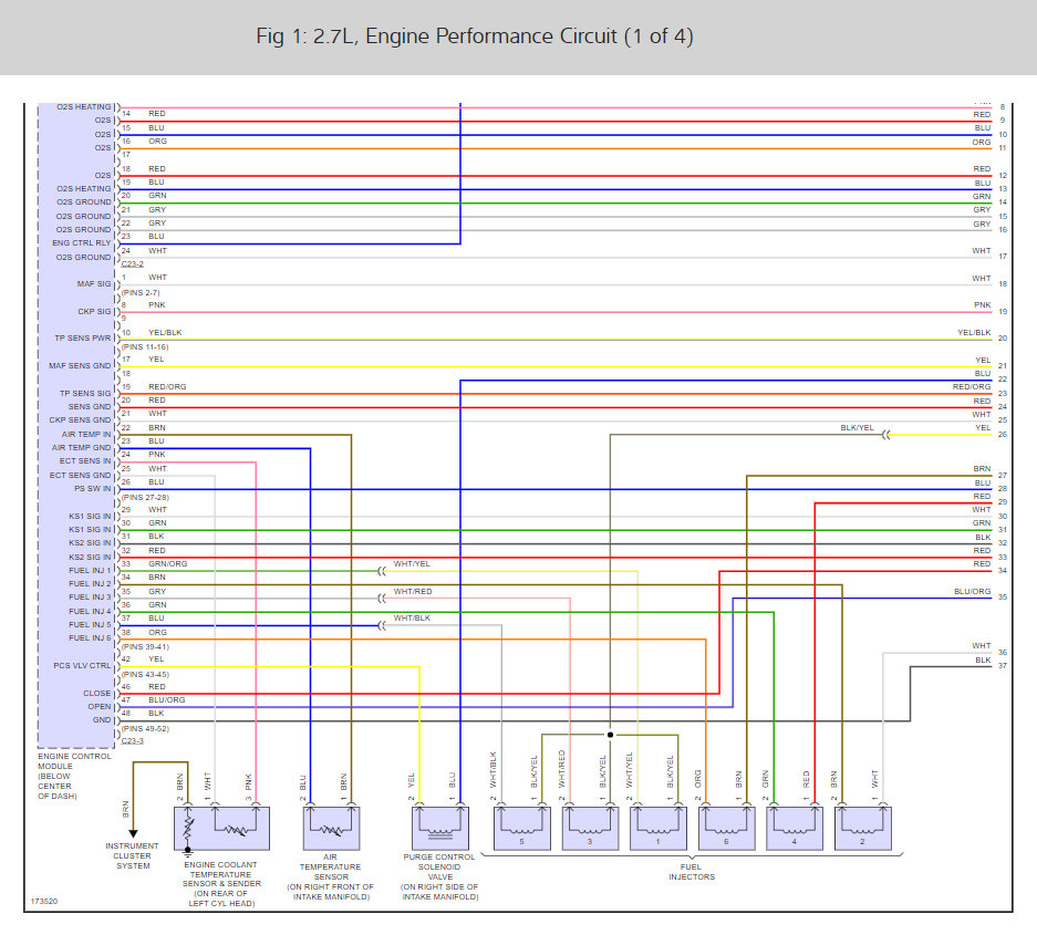

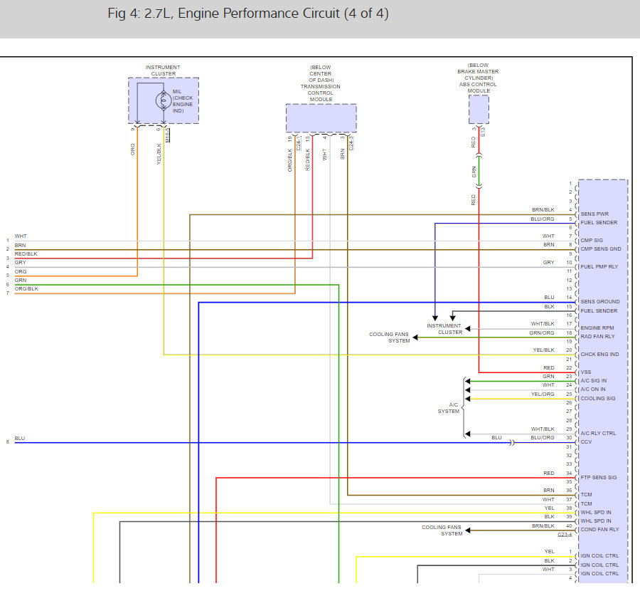

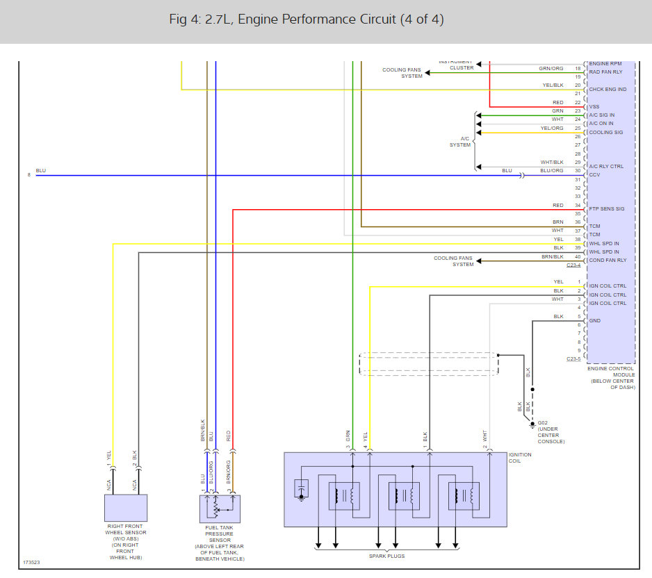

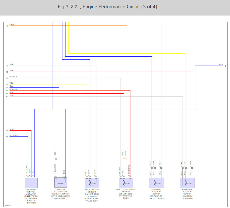

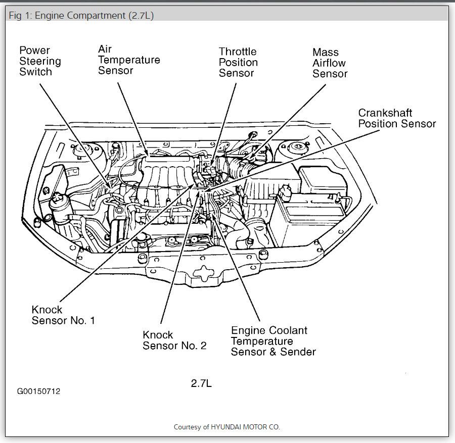

My first guess would be the sensor wiring connector has shorted or has a failed connection, but I would also look around for a ground wire that has been left off during the repair.
Here are the engine wiring diagrams and a guide to help you check the connections:

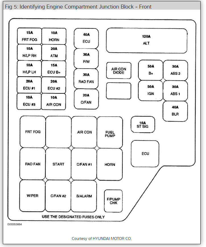

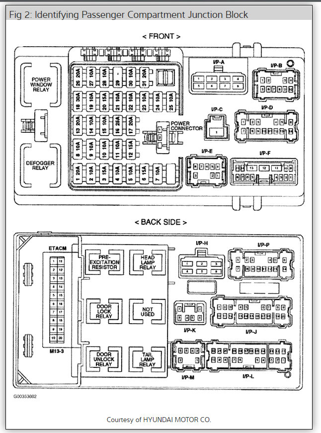

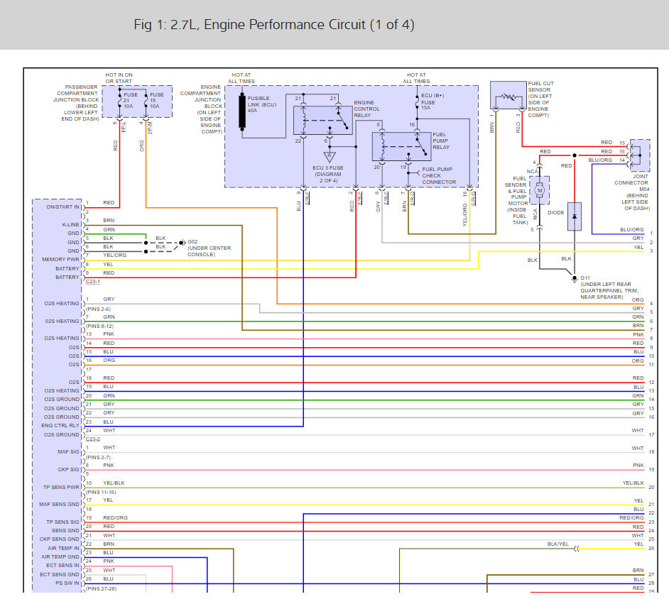

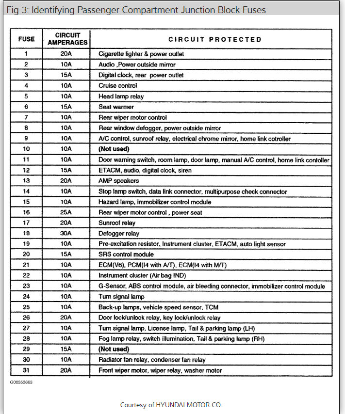

There is also an engine control relay I would test as well. Here are the fuse panel identifications as well. It shows the crankshaft sensor at the rear of the engine?

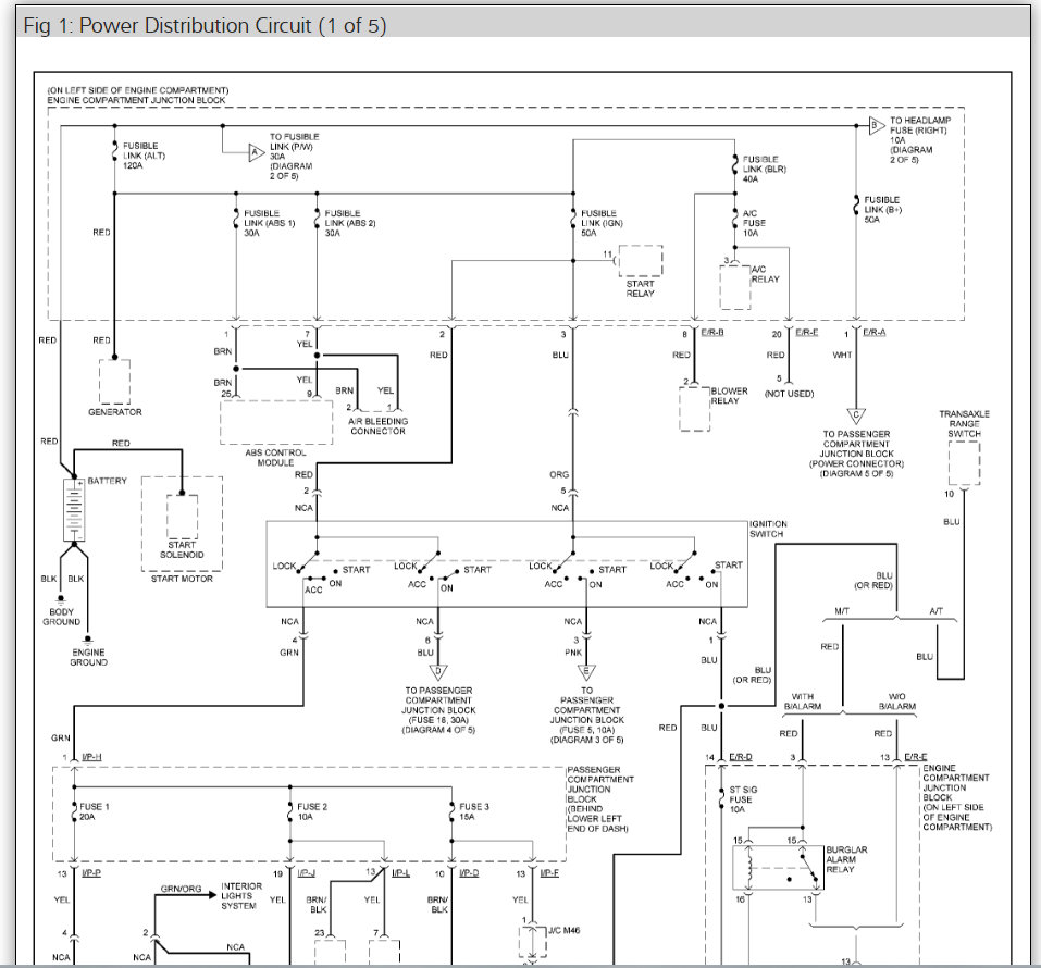

Thanks for the diagrams! So I have got it pin pointed down to the ECU relay not activating. I can jumper the ECU relay slots and the other ECU fuse slots regain power. Without jumping it, ECU fuses numbers 1, 2 and 3 have no power. What tells this ECU relay to activate? I have checked every single fuse, fuse link and relay and they are all good and have power with the exception of the aforementioned three ECU fuses.
Jun 5, 2018 at 5:10 AM
  • 55,381 POSTS

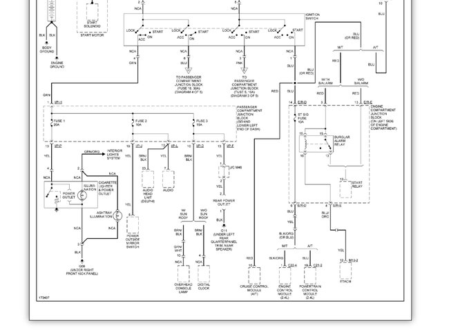

The ignition switch supplies power to the system. Here is a wiring diagram so you can test it. Check for power through the switch.
