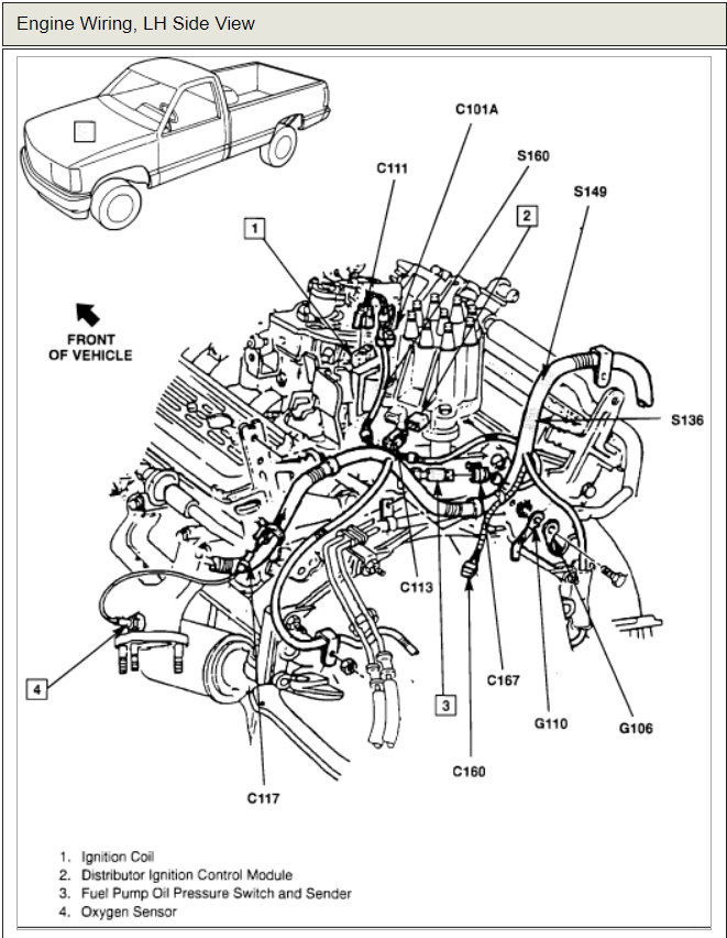

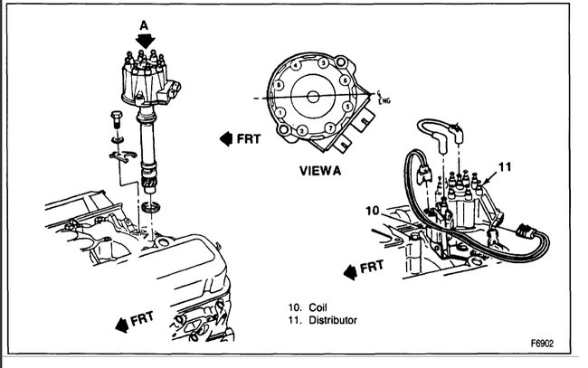

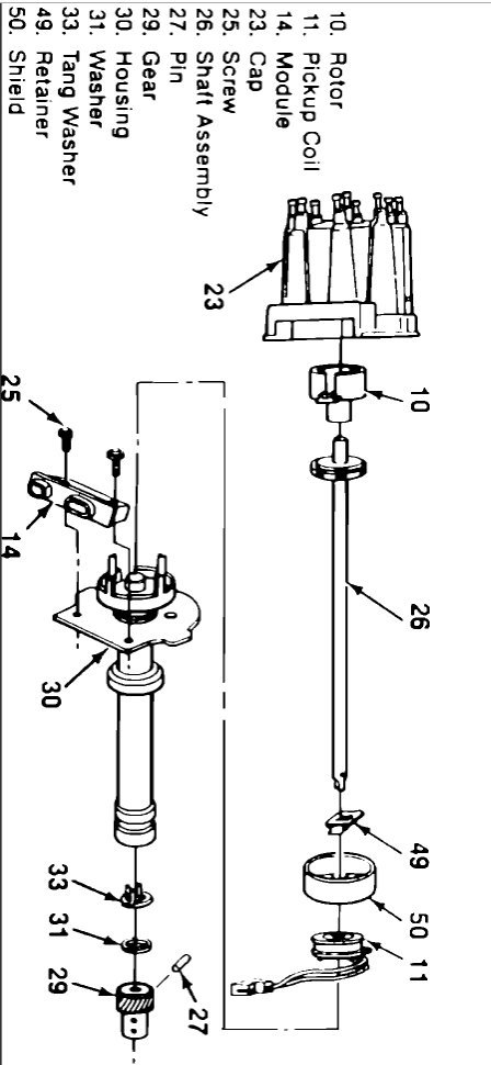

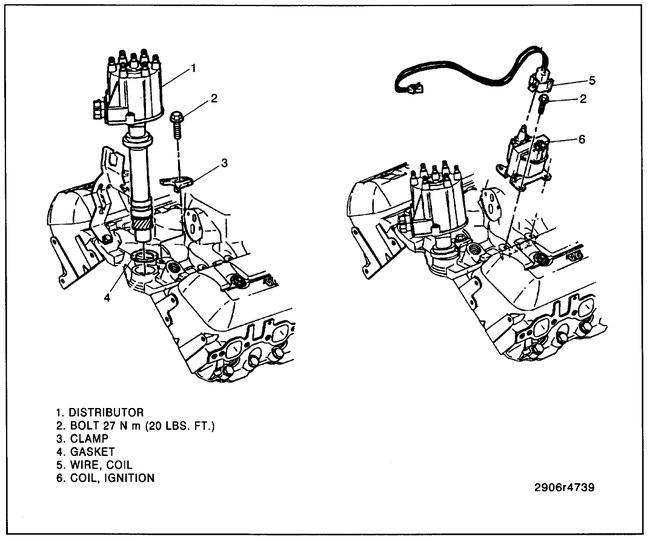

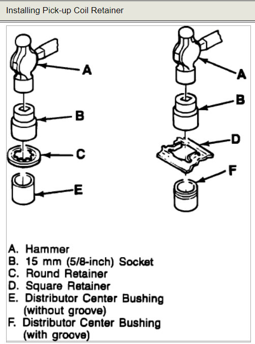

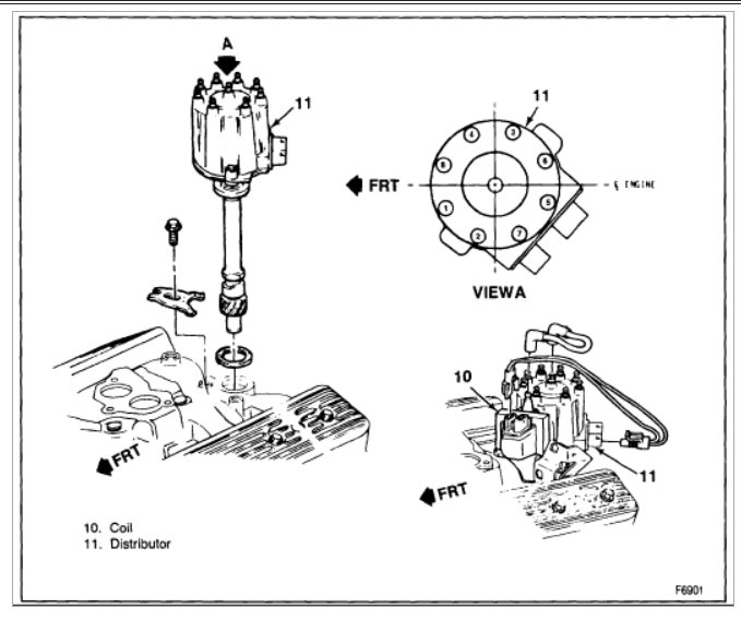

it sounds like you need a rebuilt distributor with new ignition module and pick up, if there is no spark the computer wont turn the fuel pump on. Here is how to change it out. Check out the diagrams (below). Please let us know what happens.
