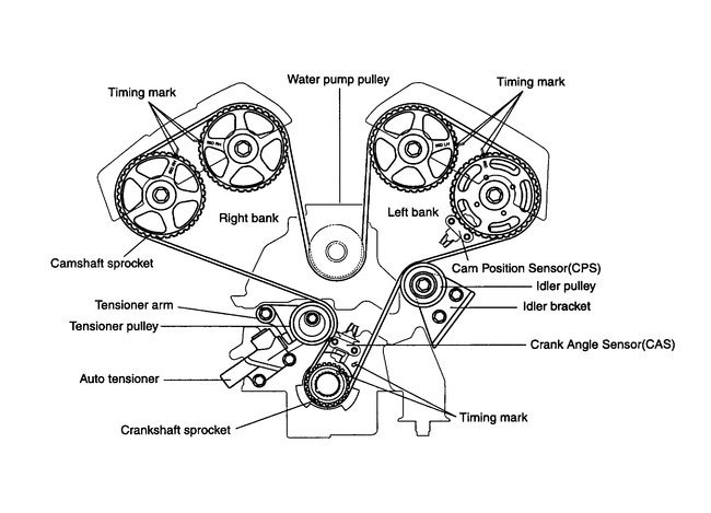

My Kia serento is not stArting i have check fuel,but it has no spark

The first suspect is a failed crankshaft position sensor. Take a look through these links.
https://www.2carpros.com/articles/how-a-crank-shaft-angle-sensor-works
The best way to test if the sensor is bad is using a live data scanner and checking for an RPM signal when cranking. If there is none, suspect the sensor needs replaced.

No problem. I just wanted to be sure. Now, if you can get your hands on a live data scanner, you need to check for an ignition signal from that sensor or an RPM signal while cranking the engine. We need to be sure this is the problem, because it requires removing the timing belt cover to access the sensor. The first picture I attached shows the sensor.

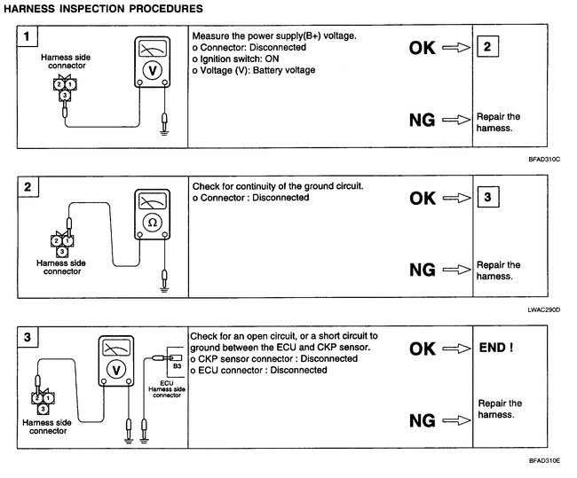

If you use a scanner but get no RPM signal, first try moving the wiring around to the sensor. It may have a bad connection.
If that doesn't help, next I need you to access the sensor and unplug it. You will need to check for a signal from the (PCM ) power-train control module. See picture 2 for specs that should be found. For this procedure, you will need to use a multi meter. Here are a few links to help you through the process:

Picture 3 is a good picture for locating the sensor I am referring to. It is identified as a crank angle sensor.

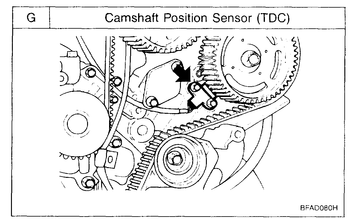

Hi Joe, thanks again. it has started but would not rev pass 3,000 rpm. what can I do now?

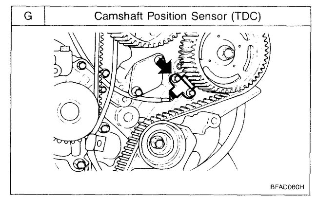

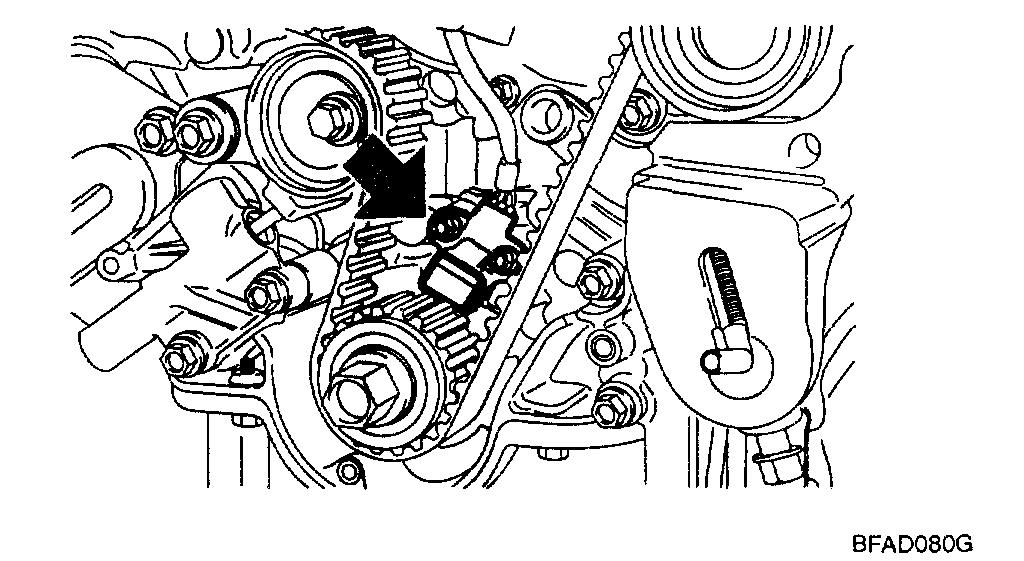

Okay, with that in mind, I need you to check both the crankshaft sensor and the camshaft position sensor. If the camshaft sensor does not operate correctly, sequential injection is may not occur and the engine may stall or run irregularly at idle or fail to accelerate normally. I have a feeling it is one of the two items I mentioned.
Here are the directions for testing this sensor. Also, this sensor is located at near the timing belt too, so the directions are similar to the crankshaft sensor.
________________________________________

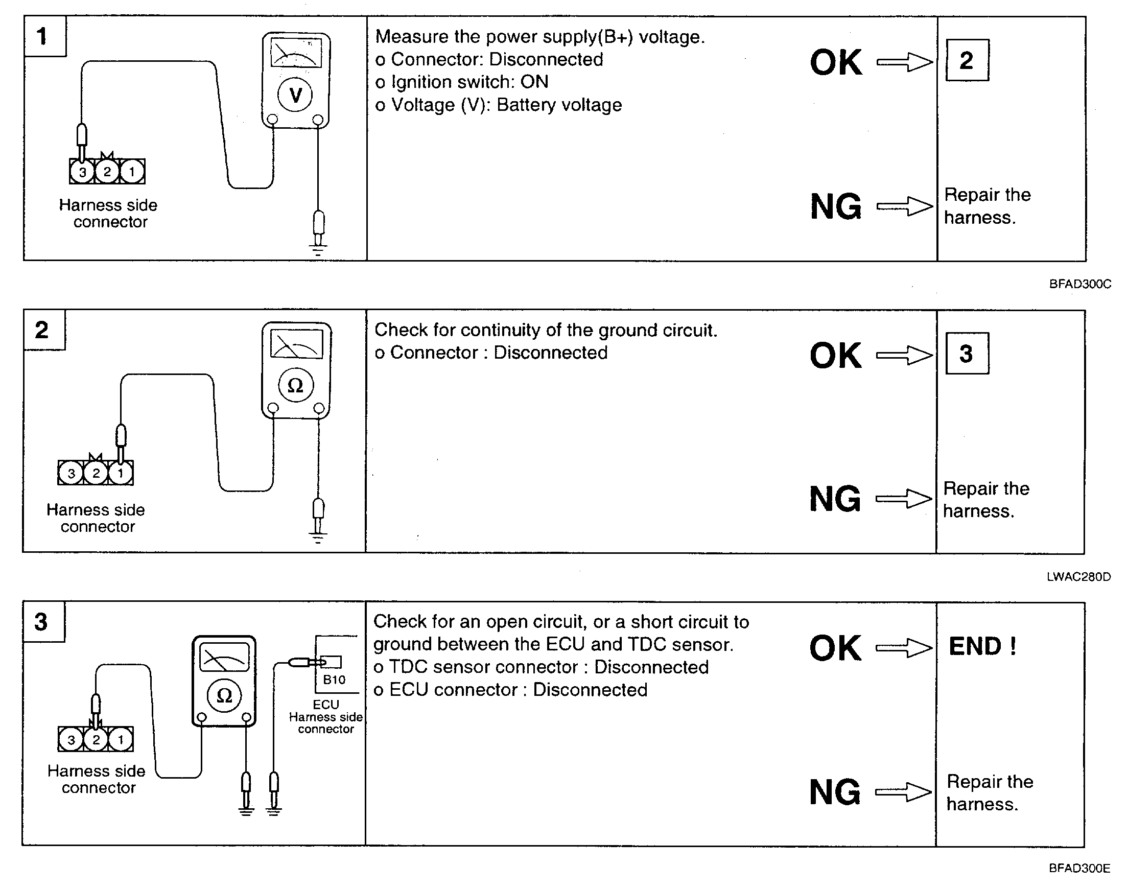

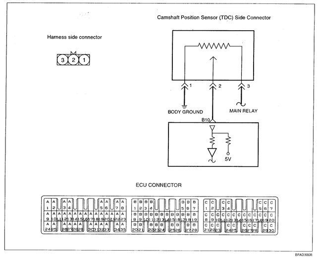

Picture 1 shows location, picture 2 is a circuit schematic, and picture 3 shows specs for harness inspection.
Let me know what you find. Also, if the check engine light is staying on, you need to scan the computer for diagnostic trouble codes. That will point us in the right direction.
