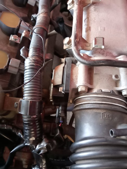

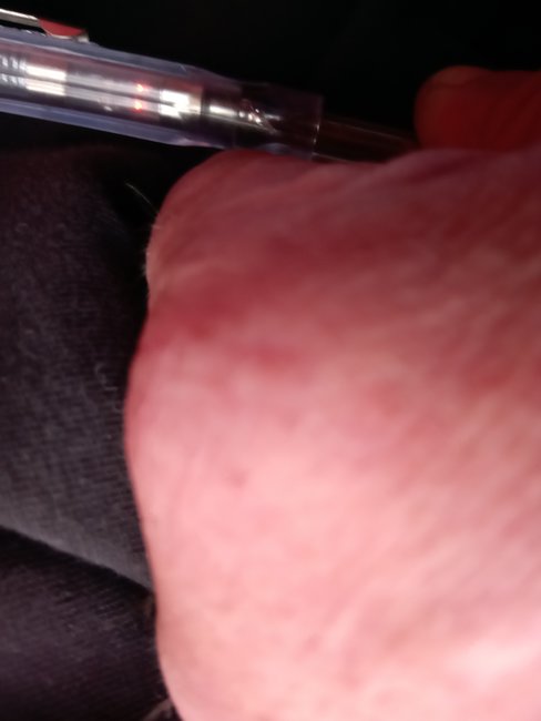

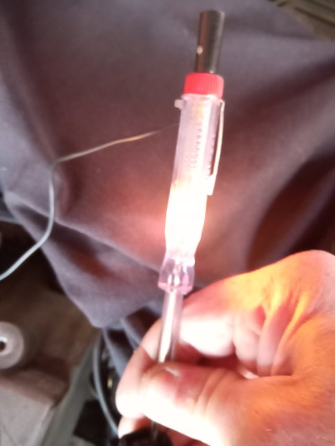

Thanks for your reply and help. great news about the ECU not having to be re programmed. Did find something interesting this morning though, while going through the sensors with a circuit tester the plug that goes to where the fuel injection is has almost no power (see attached) compared to the camshaft position sensor it's very bright. so something could be wrong there?

Did you check this at the fuel injector harness or the injector?
You should have power with the key to the on position.
Did you say that the engine was getting fuel?

fuel injector harness with the key to the on position. When you turn the key to the on position usually you can hear the fuel being primed, I don't get that noise at all.

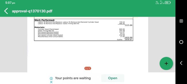

ADSEY
  • 5 POSTS
Mobile mechanic showed me the timing belt is missing more than a few notches and no compression in 3 out of the 4 and the one that did have compression only registered 25.
