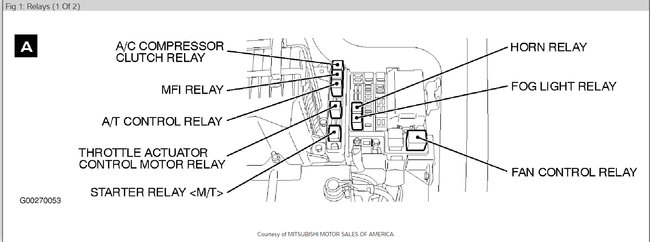

No spark no fuel, cranks but no start
2004 MITSUBISHI LANCER
200,000 MILES • 2.4L • 4 CYL • 2WD • MANUAL
DYLAN HENDON

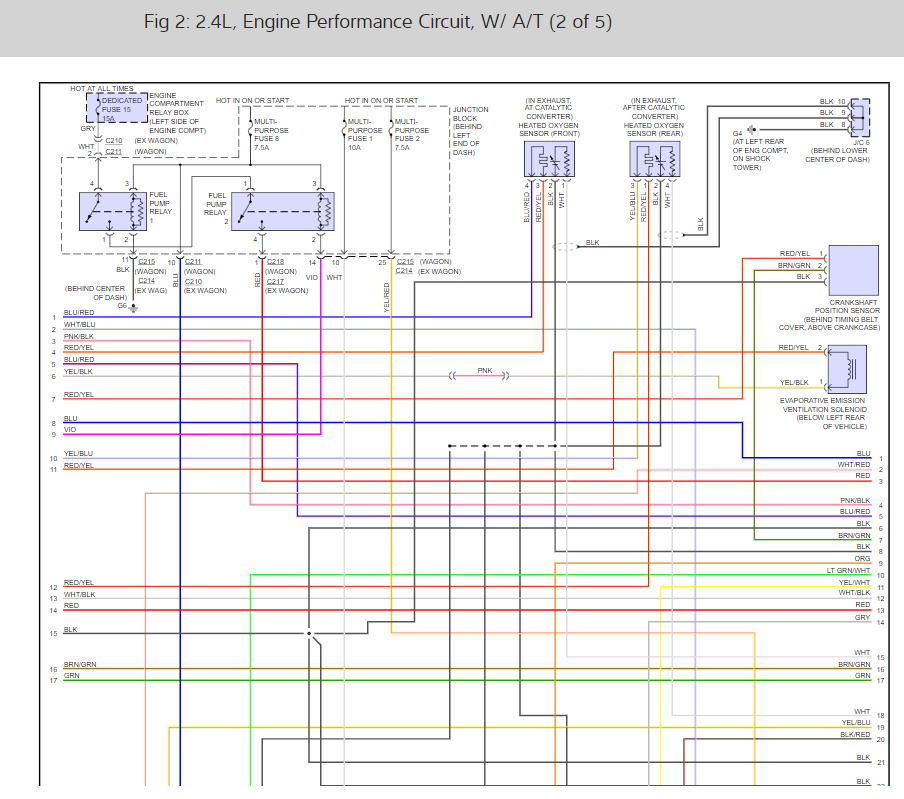

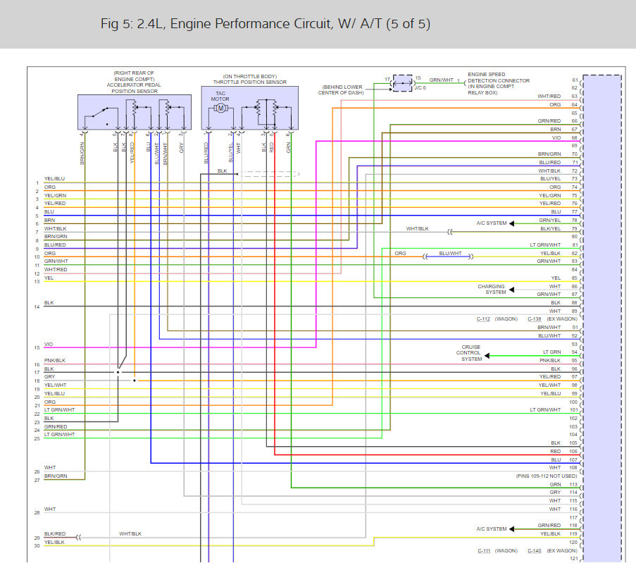

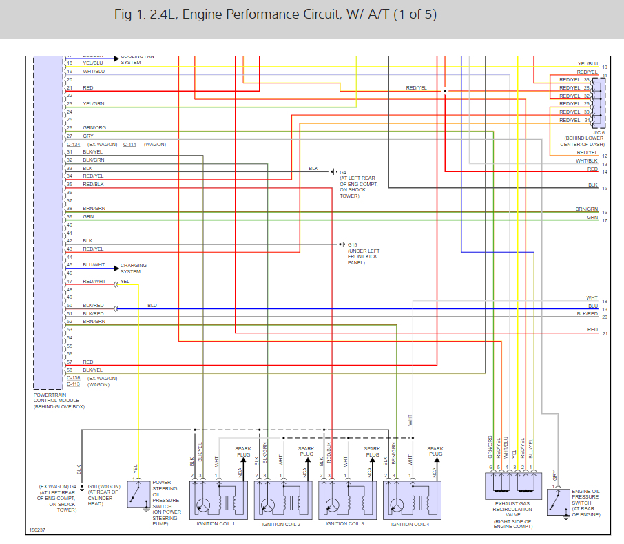

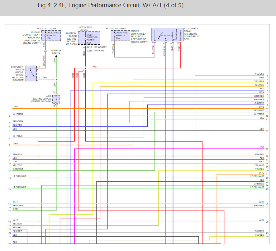

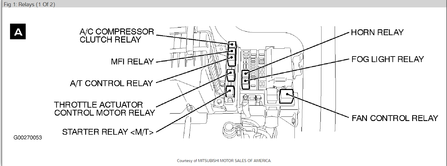

I have pulled the coil pack to see if the car sparks when I turn it over (yes the spark plug was connected to cp). I have checked fuel pump it gets no power, no engine light. I have hooked a code reader to it and throws no codes. All fuses are good. I have checked crank and cam sensor, they are getting no power. Please help. :)
Sep 18, 2018 at 9:30 PM
  • 54,837 POSTS

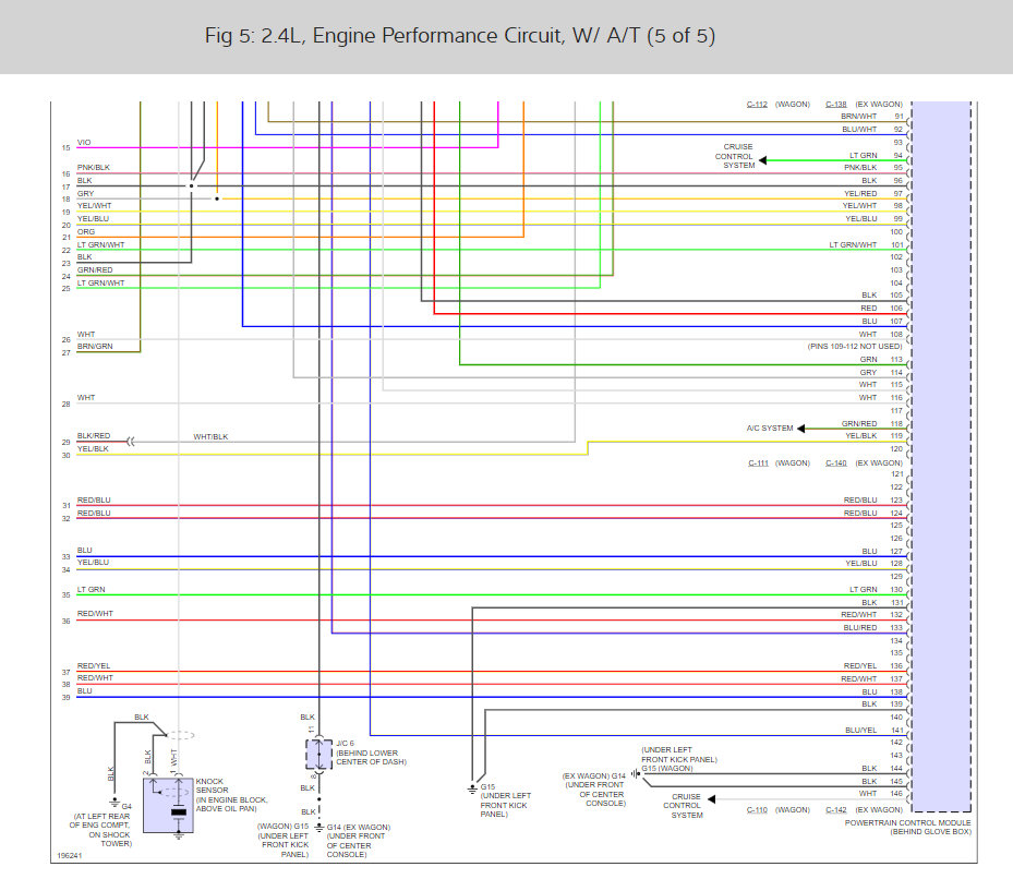

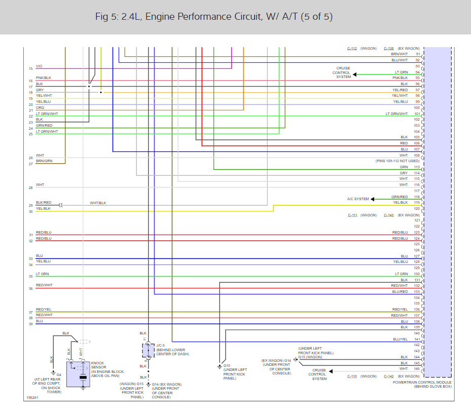

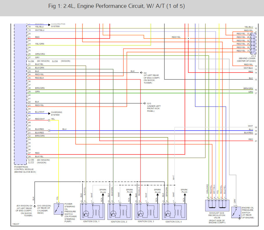

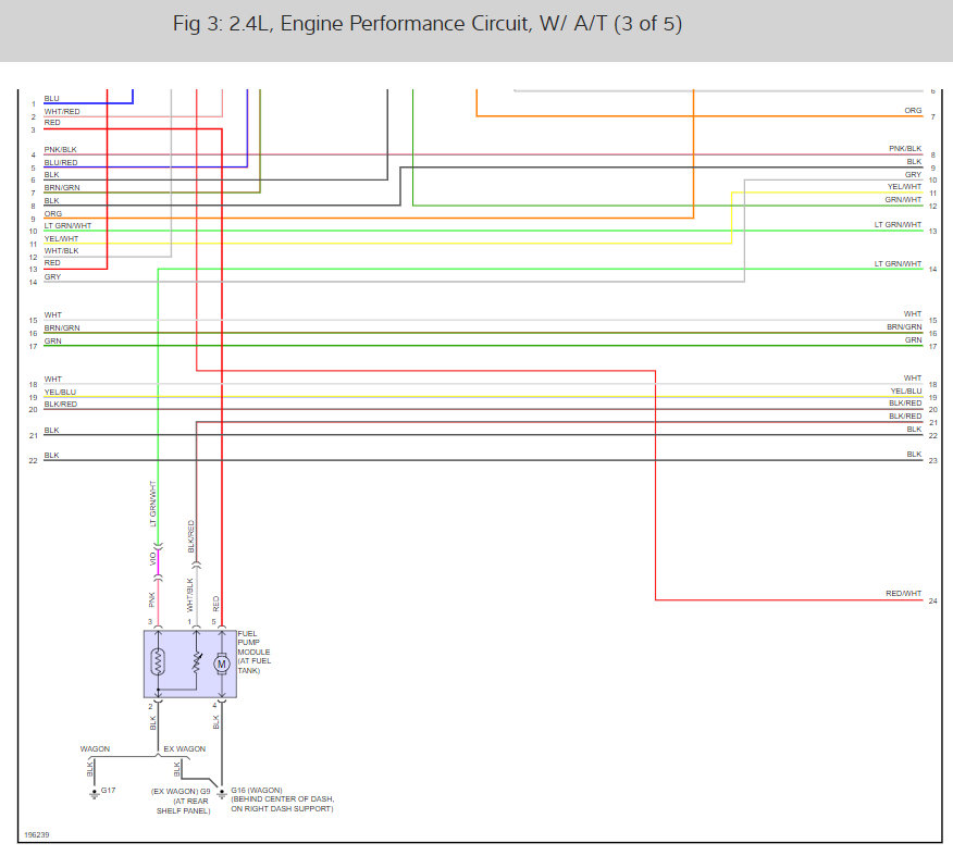

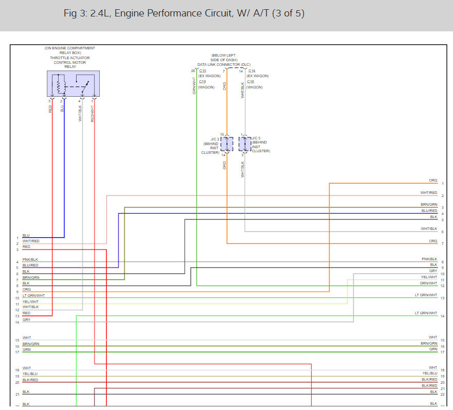

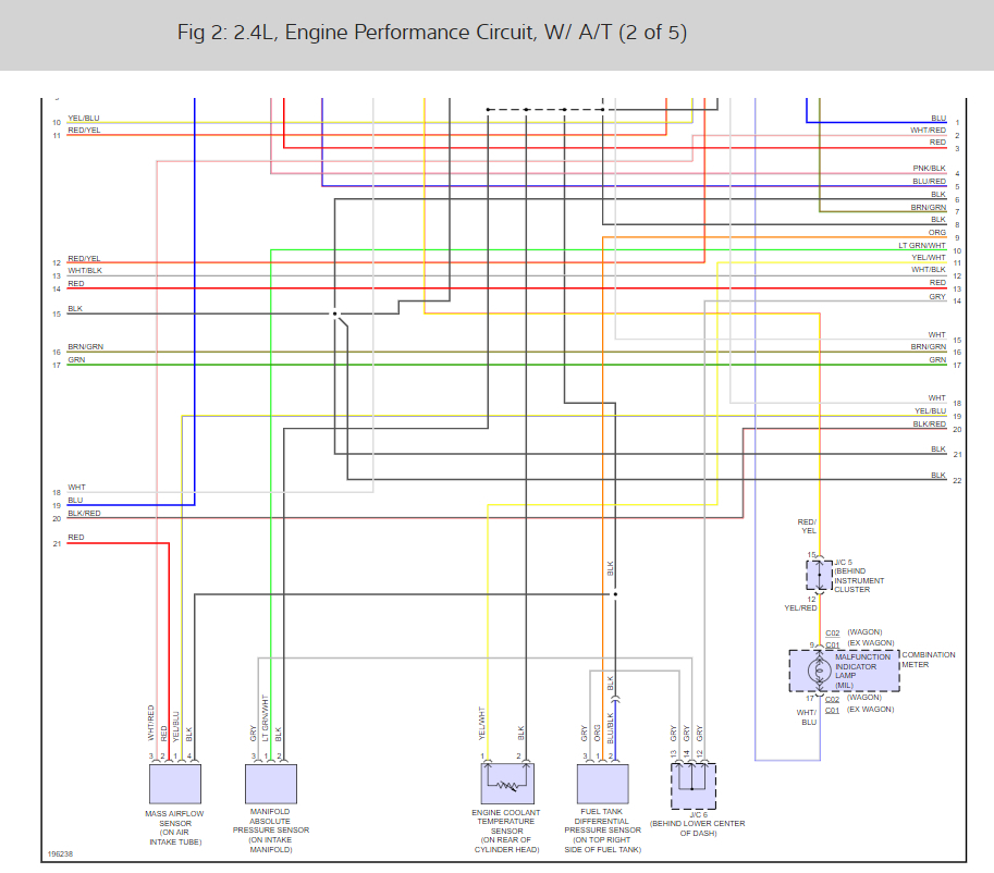

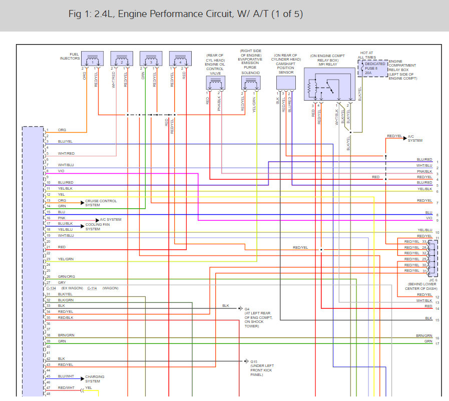

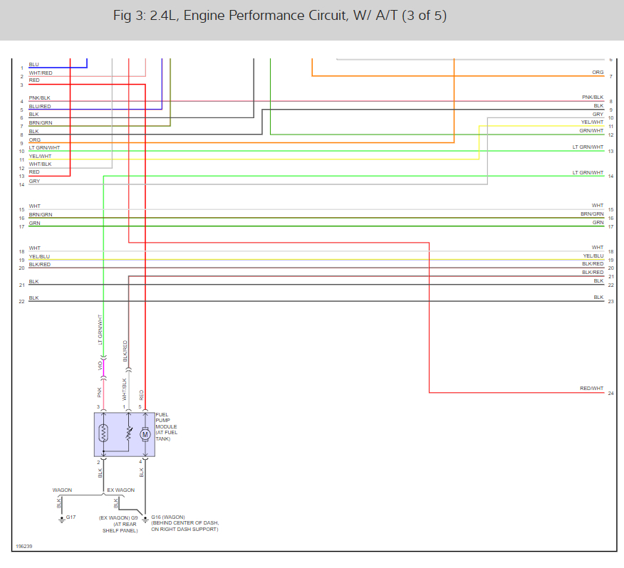

It sounds like the MFI relay is not working, but to be sure here is a guide to help check the relay and the MFI relay location along with the engine wiring diagrams so you can see how the system works:
