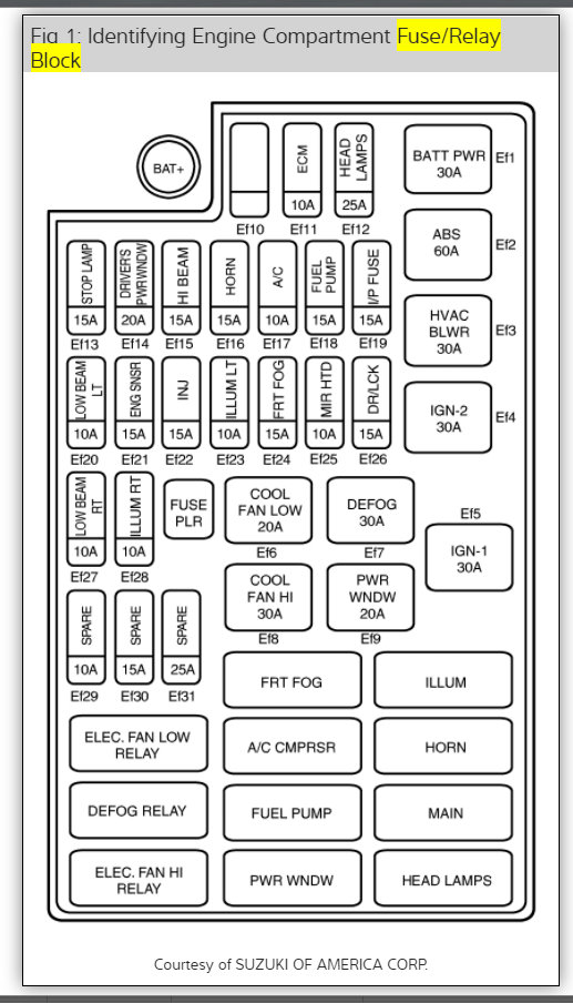

Not finding that relay under the hood here is a picture of the relay box. But, I do want to add that when cranking the engine the i get hit and miss power to the fuel pump as well as spark. Car will start with starting fluid but shuts off immediately.

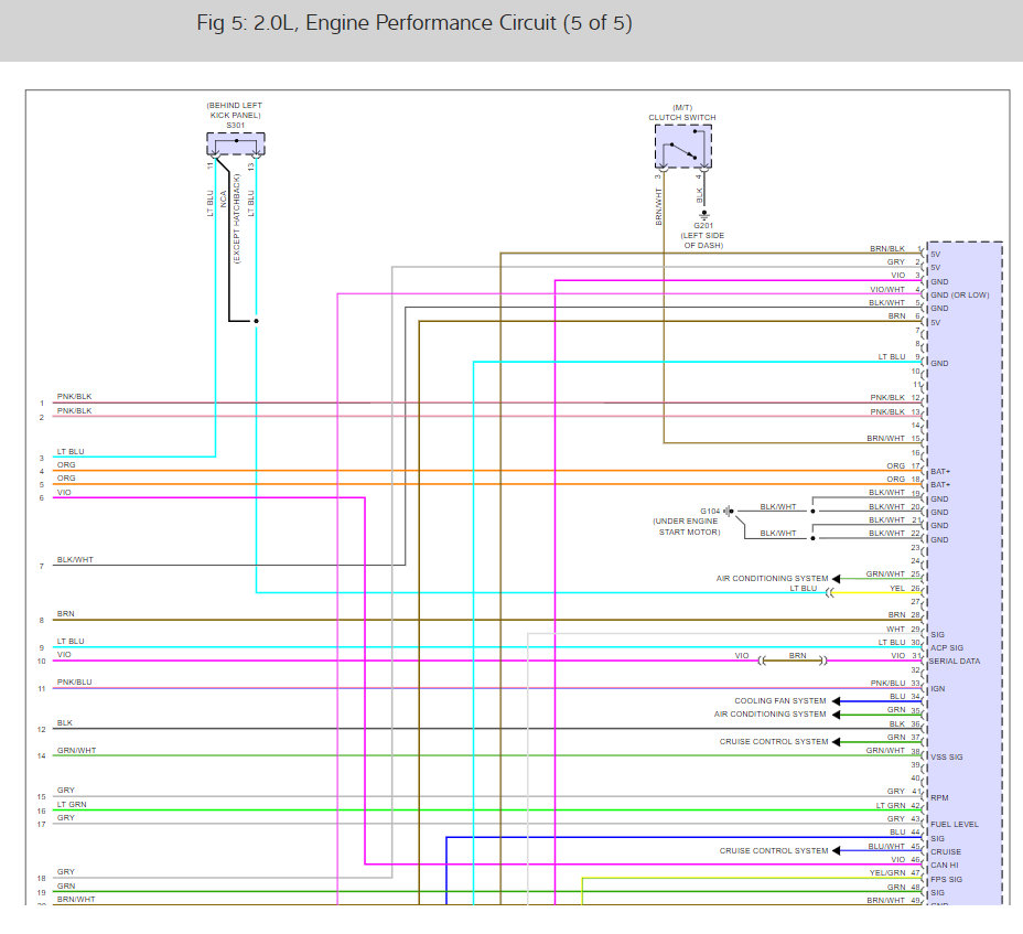

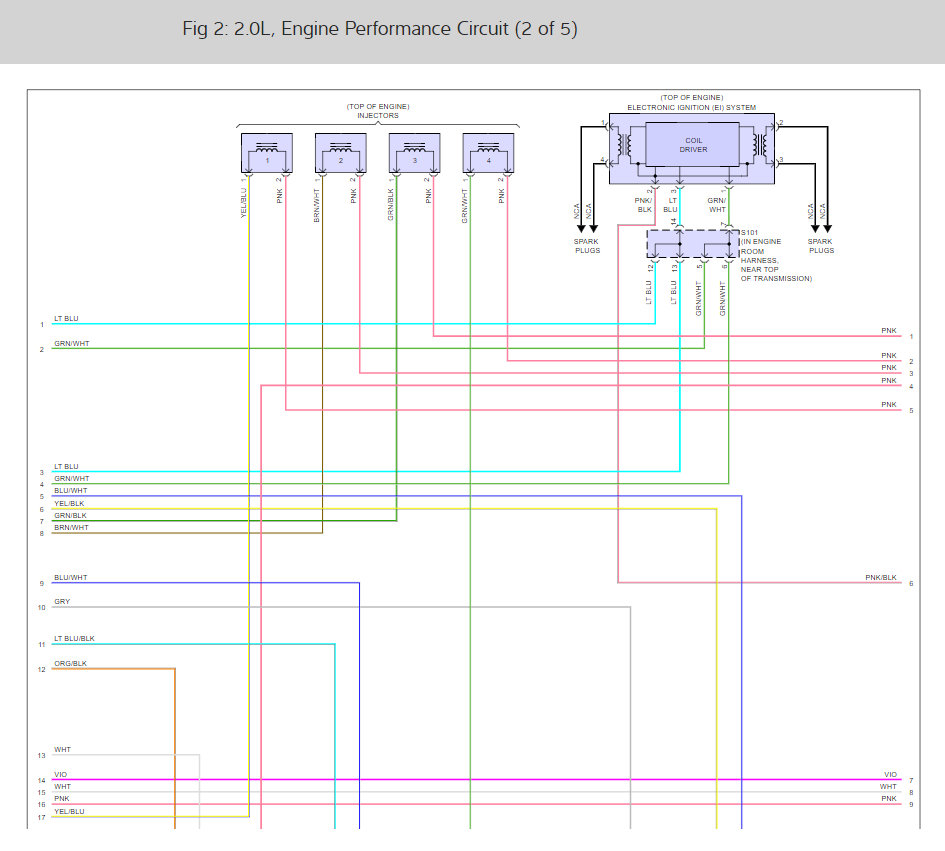

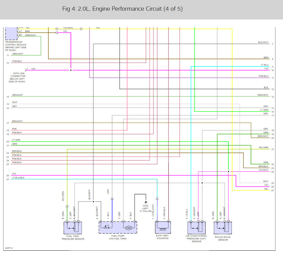

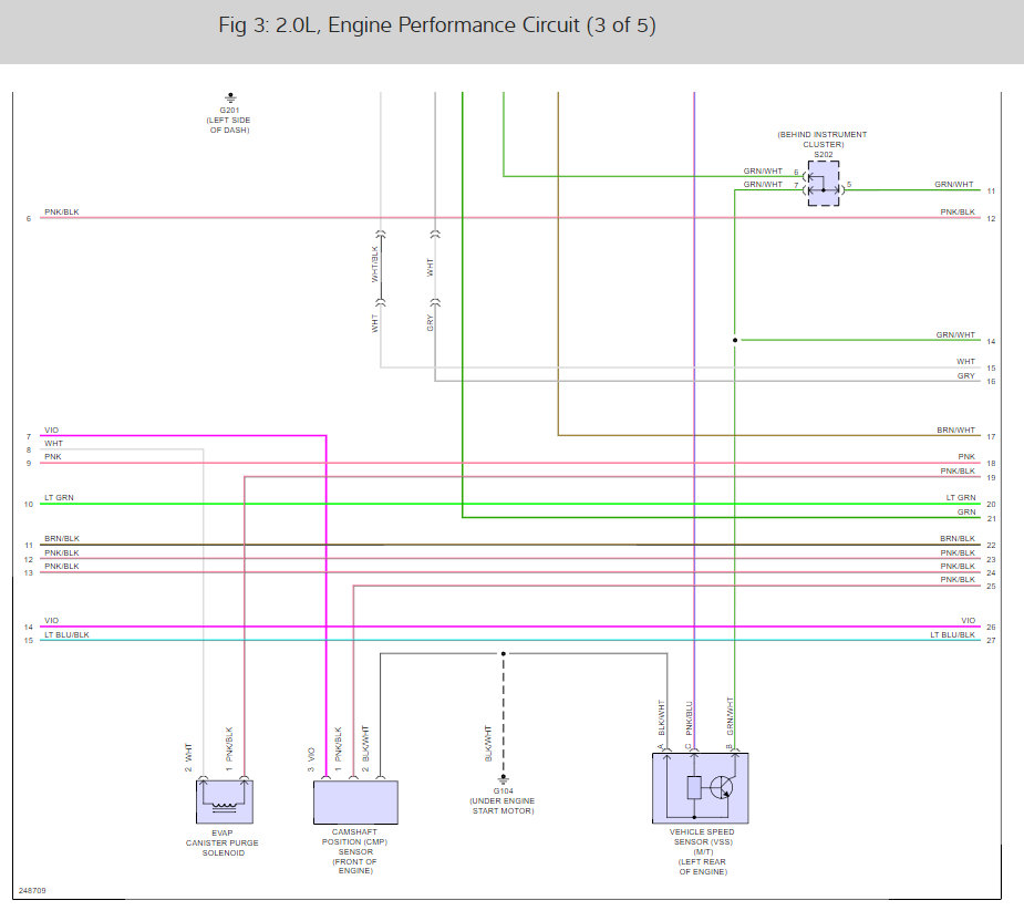

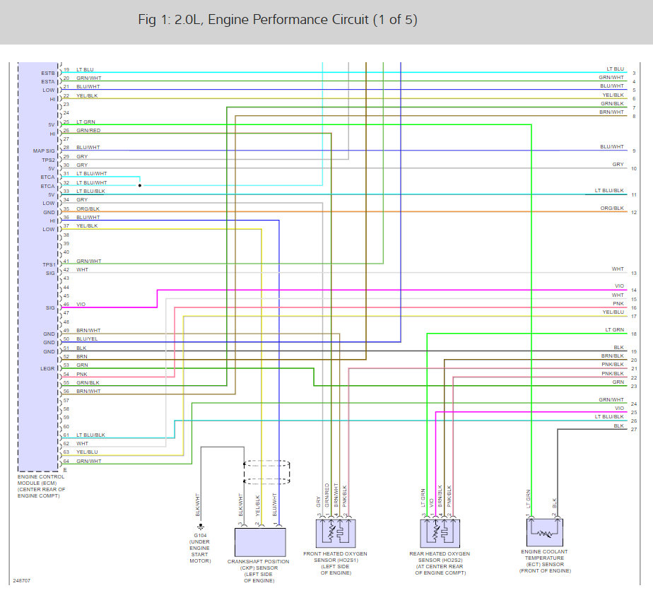

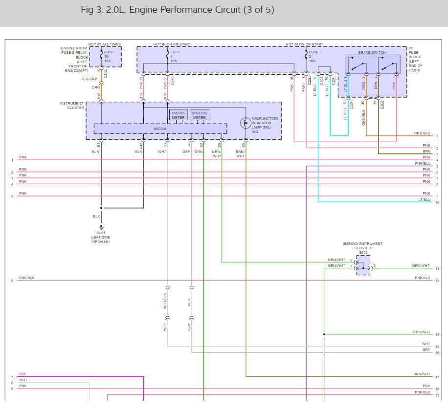

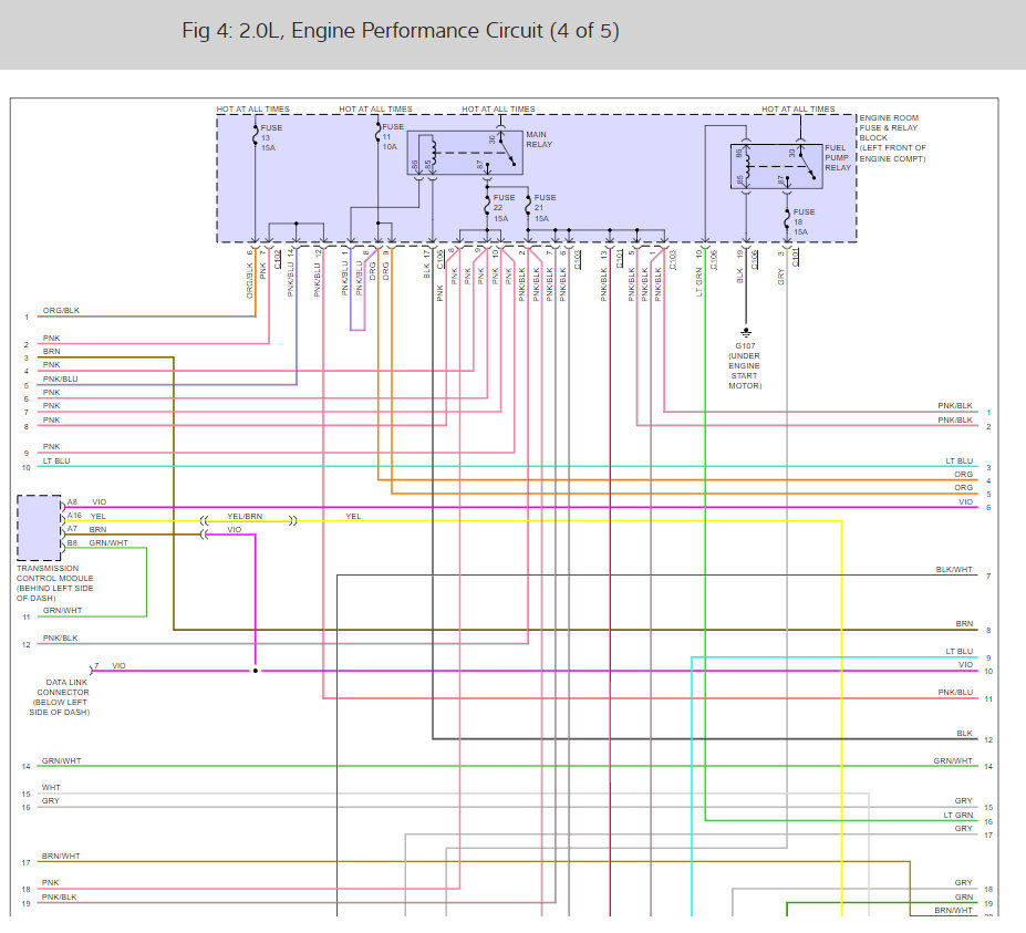

Did you upload a picture? I think what JACOBANDNICKOLAS ment was to check the MAIN relay becasue it runs the system. Here are some engine wiring and fuse panel diagrams to help you see whats going on with a couple of guides (below)
and
Dec 17, 2017 at 7:07 AM

Checked all fuses and relays everything is checking out good.

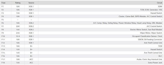

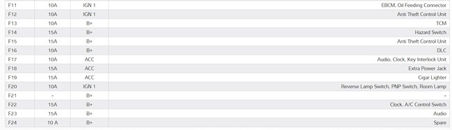

here is the pic i have of the lid of the panel hope this helps
Dec 26, 2017 at 3:48 PM
  • 55,684 POSTS
Yes we have the right car. You said that you don't have park but when you spray fluid the engine will run until the fluid runs out? This is telling me we have spark but not fuel. Can you try testing for power with the key on at the fuel pump relay?

LYLE GIBSON
  • 9 POSTS
in the photo i sent its the fuse below N1sticker bottom fuse labeled IGN COIL thats the one that has no power with key on or cranking

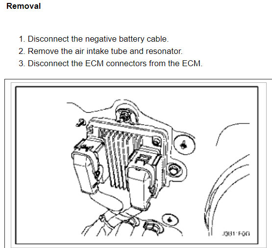

  • 55,684 POSTS
If the main relay is going out it will cause the problem have described. If that ends up being okay I would say it is the computer issue which will need to be programmed at a shop.
Here is the ECM location.
