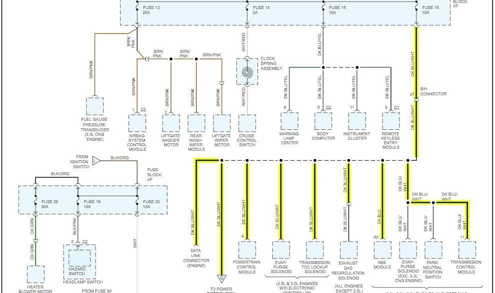

Was driving to work van stopped running, try to start but no start, no spark, no fuel pump. Ignition fuse keeps blow every time I try to turn it over. can’t check relays under the hood because when try to turn on key fuse blows.

What fuse number is failing? so I can look for a diagram of what the fuse controls so you can search your failure.

On the inside fuse panel it is fuse 16 that says ignition feed 15A. please I need help.

Okay, I attached a diagram of all that fuse 16 controls. You need to unhook all the components that are controlled and then see if the fuse still blows. If It does, it is a wiring harness issue. If it does not then you need to plug one component back in, one at a time until the fuse fails. Then you know the failure.

Oh, my this may that a while. but I may have to take it to a garage or have someone look at it that’s just more then I know how to do.
