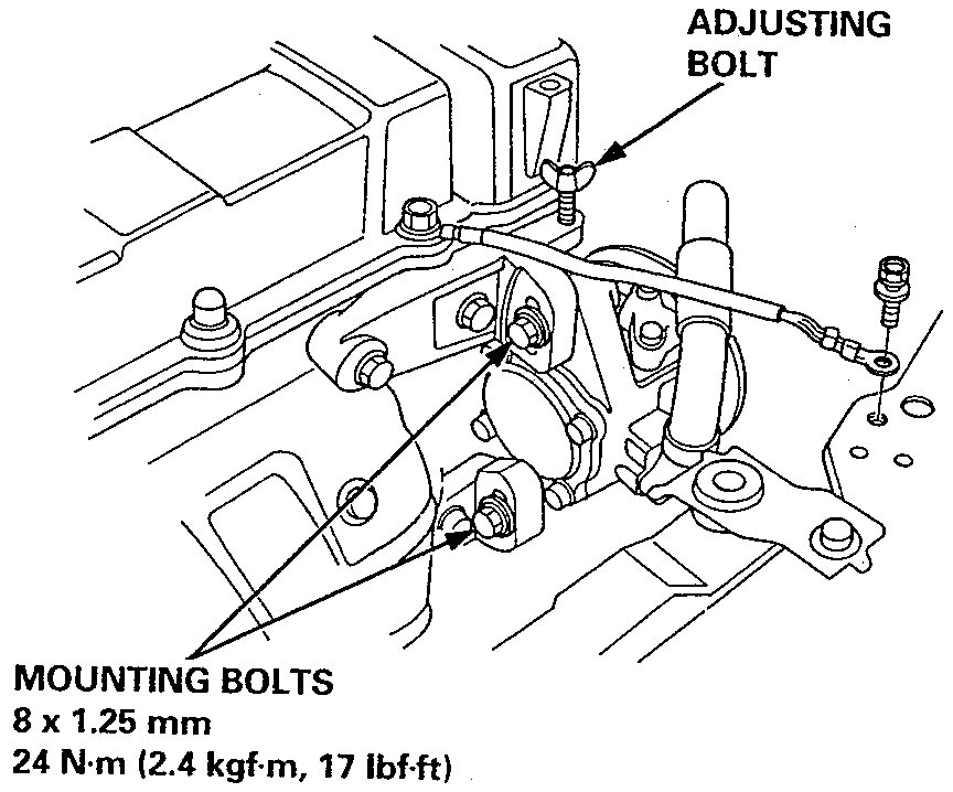

2.Loosen the adjusting bolt and mounting bolts, then remove the P/S pump belt.
pic 2

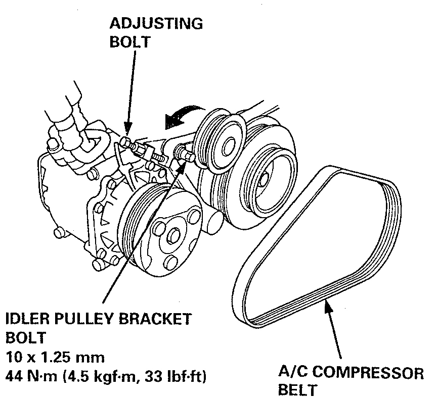

3.Loosen the adjusting bolt and idler pulley bracket bolt, then remove the A/C compressor belt.
pic 3

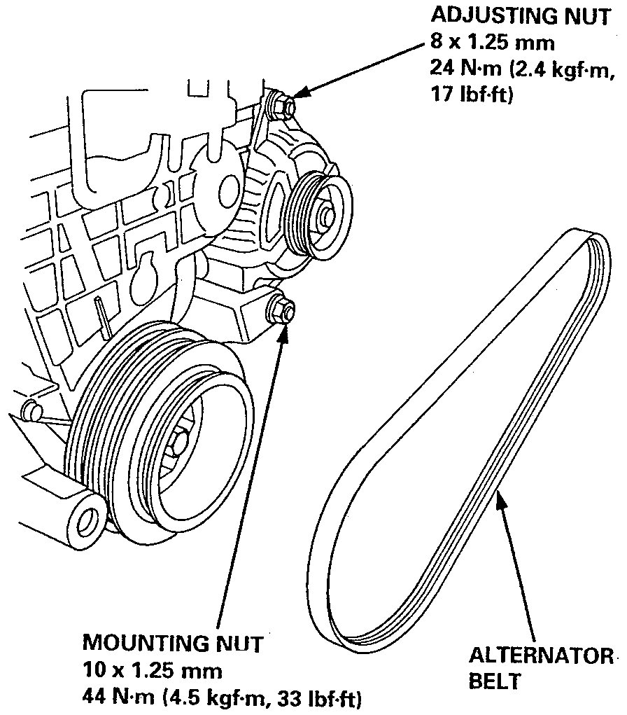

4.Loosen the adjusting nut and mounting nut, then remove the alternator belt.

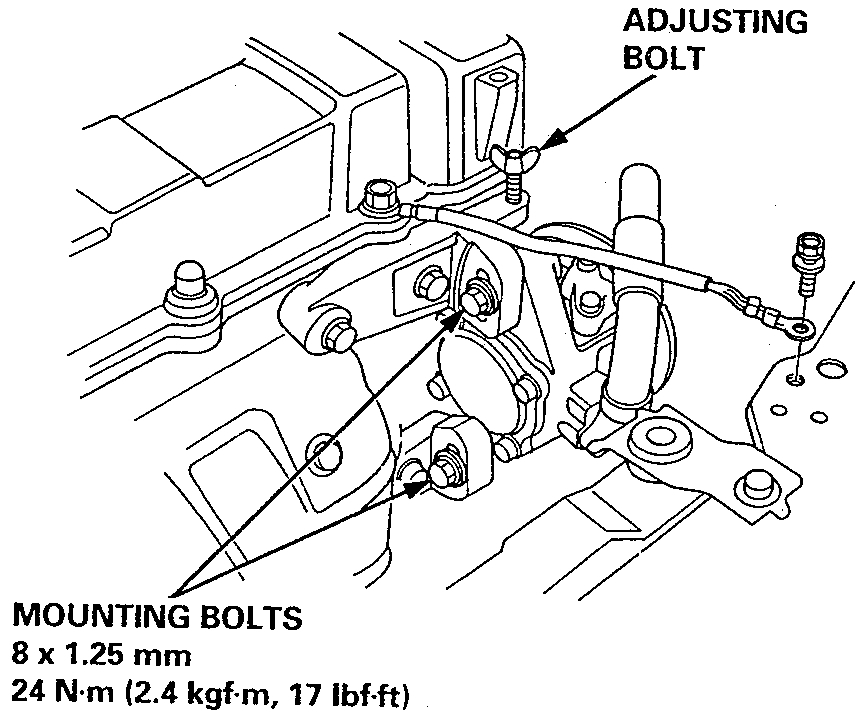

7.Remove the middle cover and the lower cover.
NOTE:
^ Do not use the middle cover and lower cover for storing removed items.
^ Clean the middle cover and lower cover before installation.
pic 4

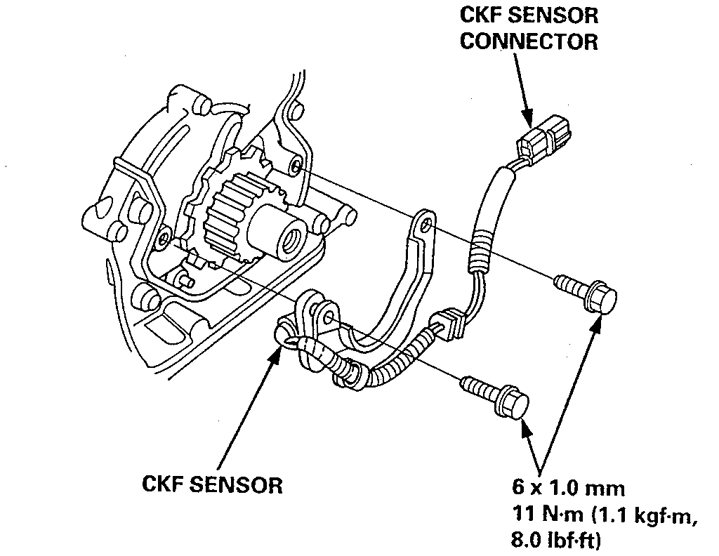

8.Disconnect the Crankshaft Speed Fluctuation Sensor (CKF) sensor connector, then remove the CKF sensor.
9.Install the CKF sensor in reverse order of removal.
