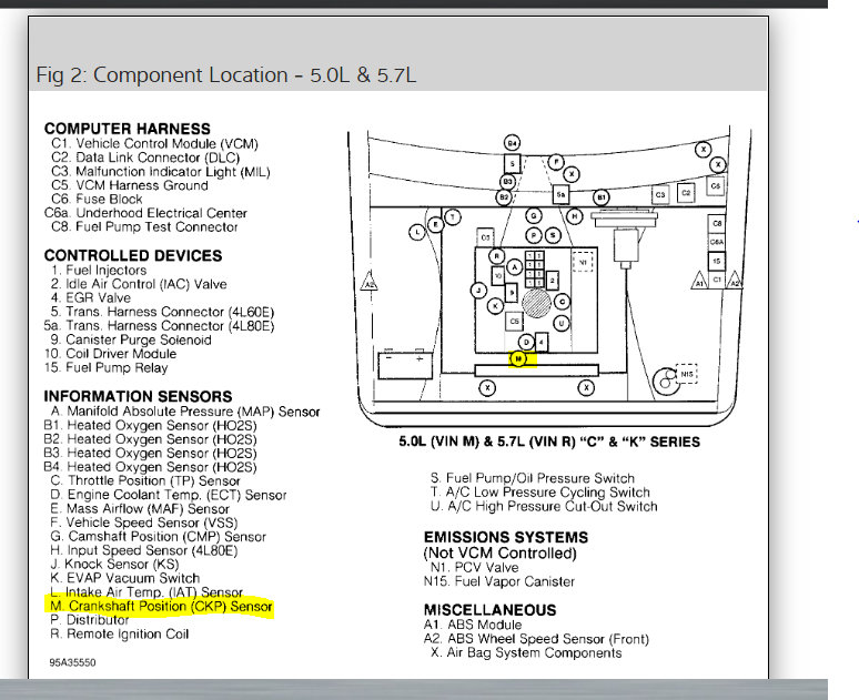

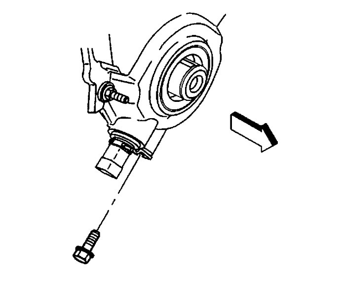

All of a sudden wouldn't start after shutting it off at the gas station. Checked for spark on the coil and the distributor and there was no spark at all. Bought a brand new coil and new distributor/rotor and still no spark. Can someone help lead me to where else I should be looking?

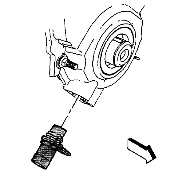

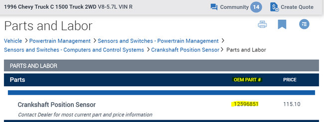

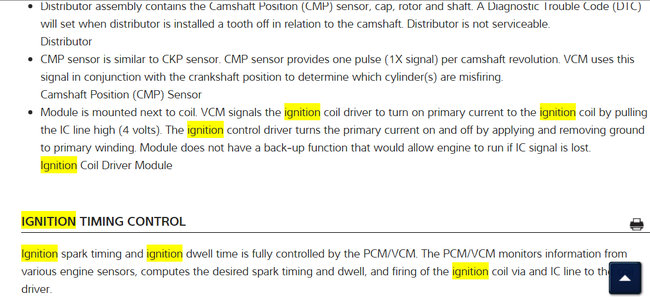

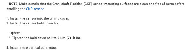

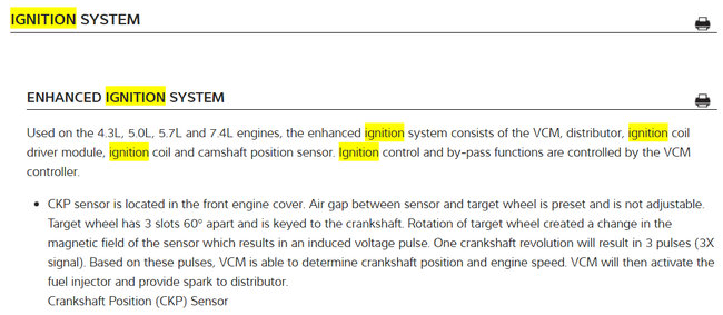

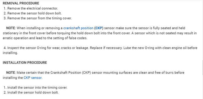

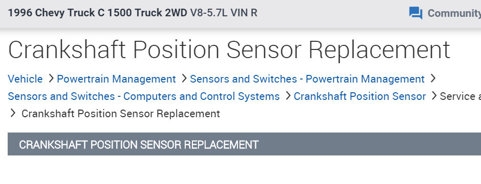

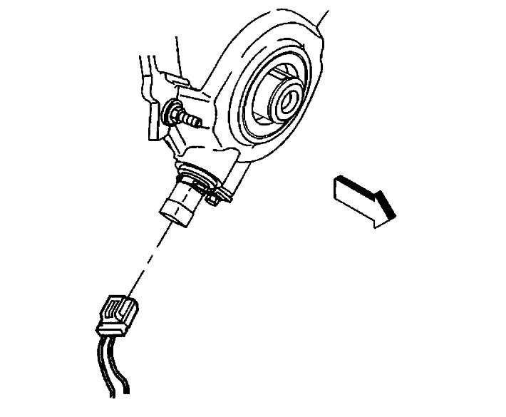

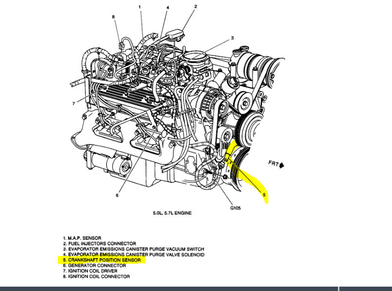

Hello again,
This could be a problem with your vehicle's Crankshaft Position Sensor (CKP). In the diagrams down below I have included the description of how your vehicle's ignition system works. Here are a couple of links for you to go to as well down below:
https://www.2carpros.com/articles/how-a-crank-shaft-angle-sensor-works
Also in the diagrams down below I have included a diagram of the location of the CKP, Original Equipment Manufacturer(OEM) part number, and the instructions for the removal and installation of your vehicle's CKP. Please go through these guides and get back to us with what you are able to find out.
