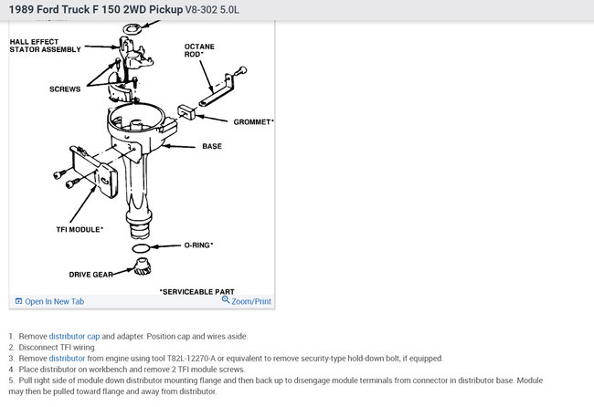

My truck listed above shut off while I was driving, and I couldn’t get it started back up. I tried jumping it, tested the fuel pressure, and then finally checked to see if there was spark. I was getting no spark from the coil pack, double checked the module and 12 volts were going in, but no spark was coming out. I figured it was probably the coil pack and bought a new one and replaced it yet still no spark coming out of the ignition coil. What could be the problem?

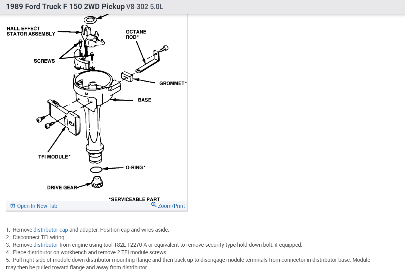

The TFI ignition modules go out all the time on these trucks. here is the location and how to change it out. You can get a new one from amazon for $43.00. (Delphi)
