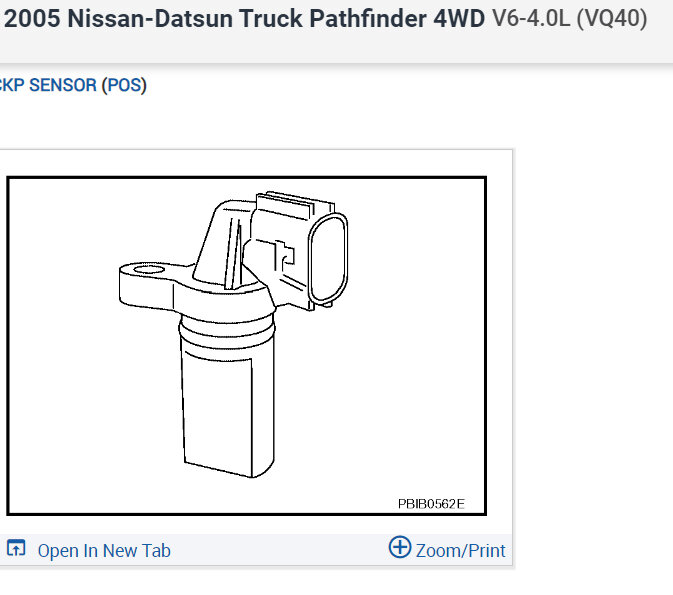

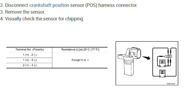

I have fuel coming up to injectors, but I have no spark in any cylinder and injectors won't turn on either. I suspect they work together with the spark into cylinders.
Oct 15, 2024 at 6:51 PM
  • 54,837 POSTS
Most of the time when this happens it will be the crankshaft angle sensor, but can I ask if you have checked the fuses, are there any trouble codes?
The crankshaft position sensor (POS) is located on the oil pan facing the gear teeth (cogs) of the signal plate. It detects the fluctuation of the engine revolution.
We need more information to help you. Check out the images (below). Please let us know what happens.
