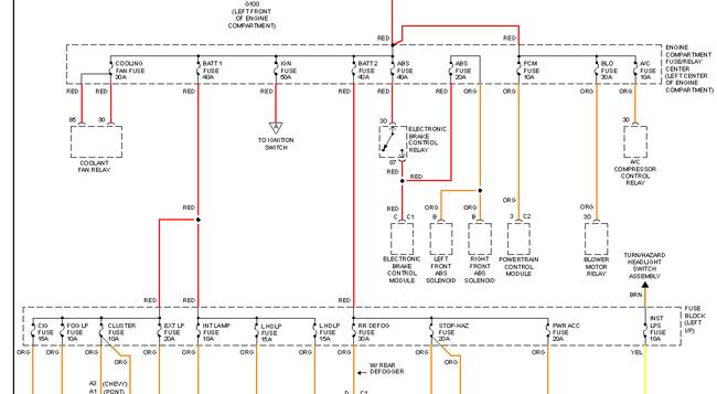

Looking for scematics of ignition wiring and fuelsystem.

Checked all voltages in fusebox under hood, they were fine, checked all under dash and I got 1.75V on: Turn-BU, ERLS, Alarm, PCM/IGN, IGN, F/P-INJ, AIRBAG.
These are the front 2 rows from bottom up. Had a look and seems like the entire dash has to be removed if you want to check out the cables behind the fusebox?
Anyone got a common diagnostic or where this cable leads in positive side? Directly from fusebox under hood?

neither one of those codes match anything it should be like a p0255 but there isn't one and nothing with a vtd it has to be a p-b-or c code. hiere is pic for power supply for I/p fuse box.

thnx for the Pic, will see into it on weekend.
