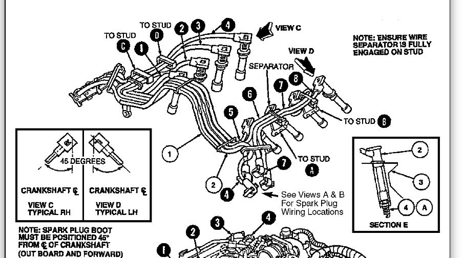

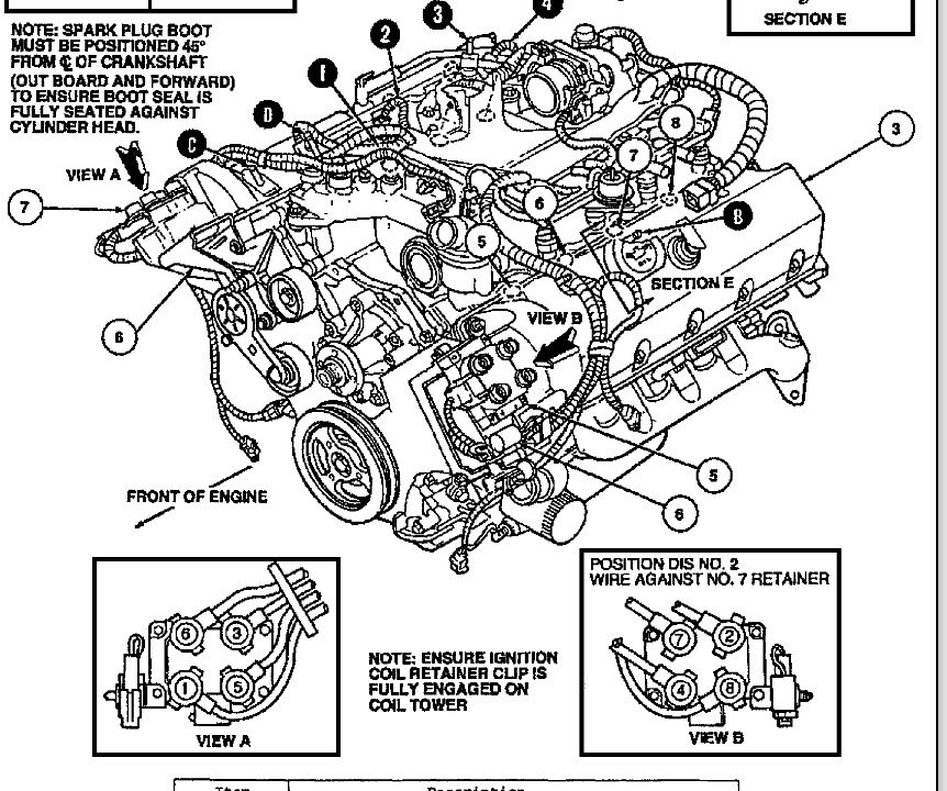

before you disconnect the battery scan for codes first. see pics for firing order and coil hookup that may be your only problem that wouldn't cause the timing chain to jump unless it was a very hard backfire. see pics for routing etc. pay attention to coils where wires plug in also #1 is on right bank not left.

As far as wiring diagram, thank you. However I have it from the chilton and the original shop manual I got from faxon. I triple checked my work and had my neighbor who used to be a shop foreman for NYC bus transit check it as well. I think I am wired up right now.

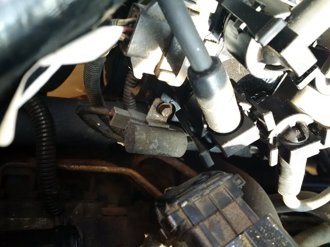

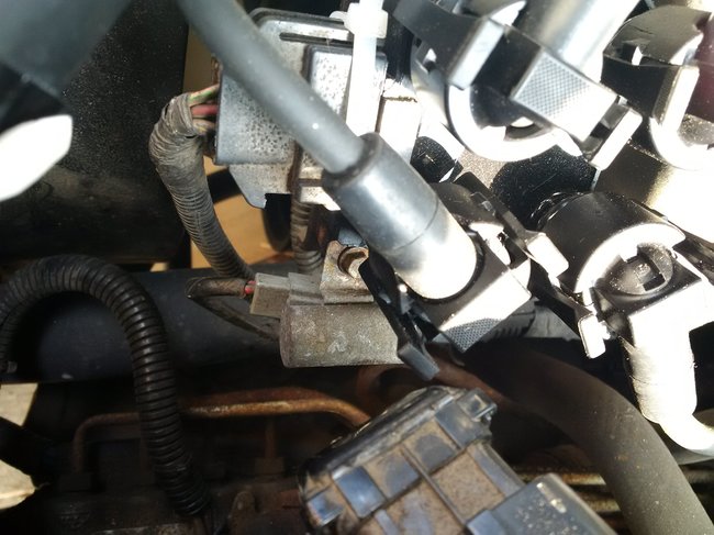

Hmac...... the ignition condensers. Left and right. My shop foreman friend and I reviewed the electrical schematic and came to the conclusion, this is the only reason why there would be no spark, short of a break in a wire at this point. These condensers are the ground for the coils and store the energy for each electrical pulse. When I had changed the spark plugs and wires, ( I had iridium plugs in previously) 40 k miles looked like 150k. The plugs were 13 thou over spec and the little electrodes were virtually gone. 40 k city miles is like 150k highway so I learned! The car has 140k but 40 is new York city driving so the car has like 250k miles even though 140 is on the odometer. I had denso wires on it before with ngk iridiums. The condensers got stressed with having to jump those gaps. I know when u put hotter coils on gm ignitions from the old days, u blow out condensers. Don't know if there are condensers to handle it. Anyway, I ordered the condensers today from the dealer for 25 bucks and am hoping for the best. I would have changed them previously but the friggin chilton said they were just radio capacitors. I didn't have a prob with the radio so I left them alone. I noticed those sobs right from the beginning and researched them with the radio bs info.

Put in all Motorcraft parts and its up and running again.... thanks for the help
