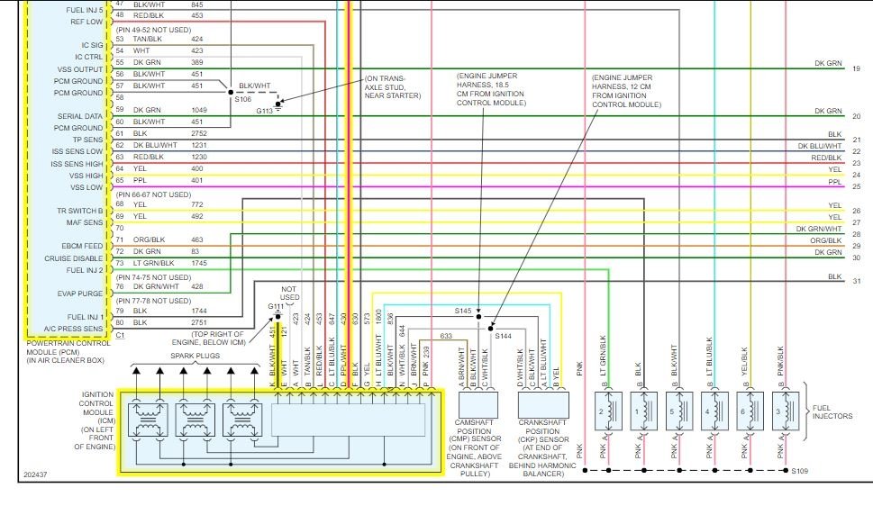

It will turn over. the car has no spark at all. I have checked and recheck everything that I can thank of. it has been a long time time since I worked on a car cant afford to take it to shop.
Dec 20, 2019 at 11:51 PM
Good afternoon,
What and how did you check it?
When you crank the engine, does the tachometer move up a little? That will tell us if the crank sensor is sending a signal to the PCM.
Did you verify power to the control module?
