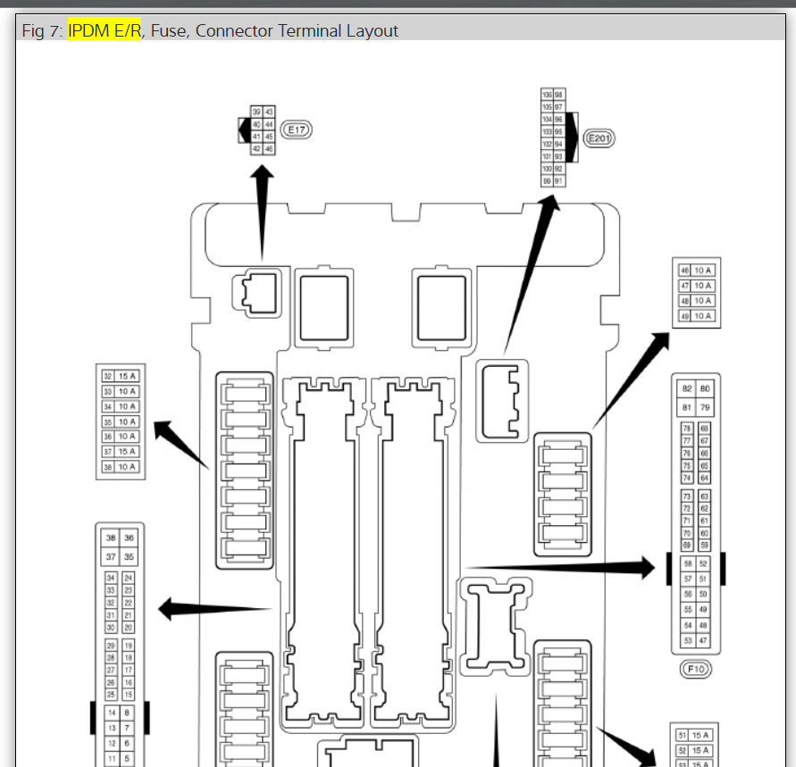

Does not start after shutting off while driving?
2013 NISSAN ALTIMA
30,000 MILES
SAMIYAH
I was driving my car and it suddenly stopped working. We thought it was a fuel pump. But my mechanic just said there’s no spark going to the coils, or the spark plugs so the car won’t start up.
Aug 11, 2023 at 4:06 AM
  • 55,433 POSTS

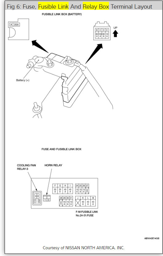

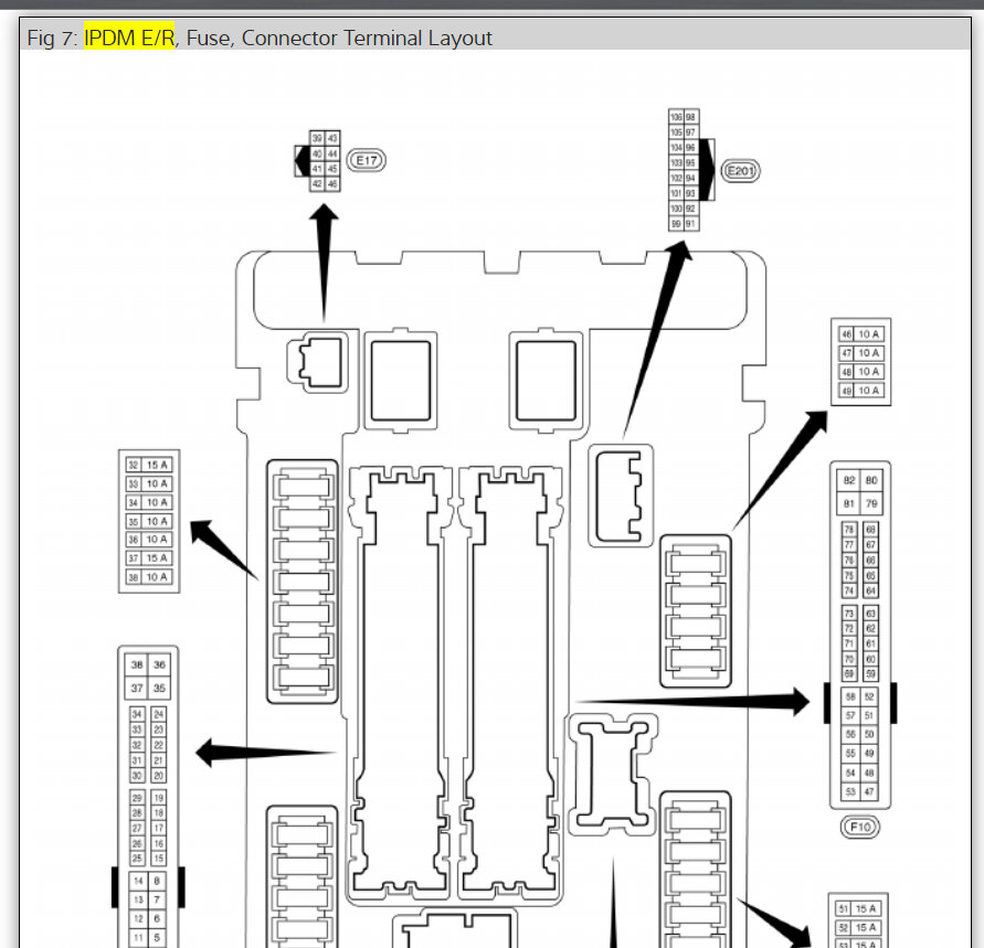

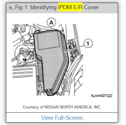

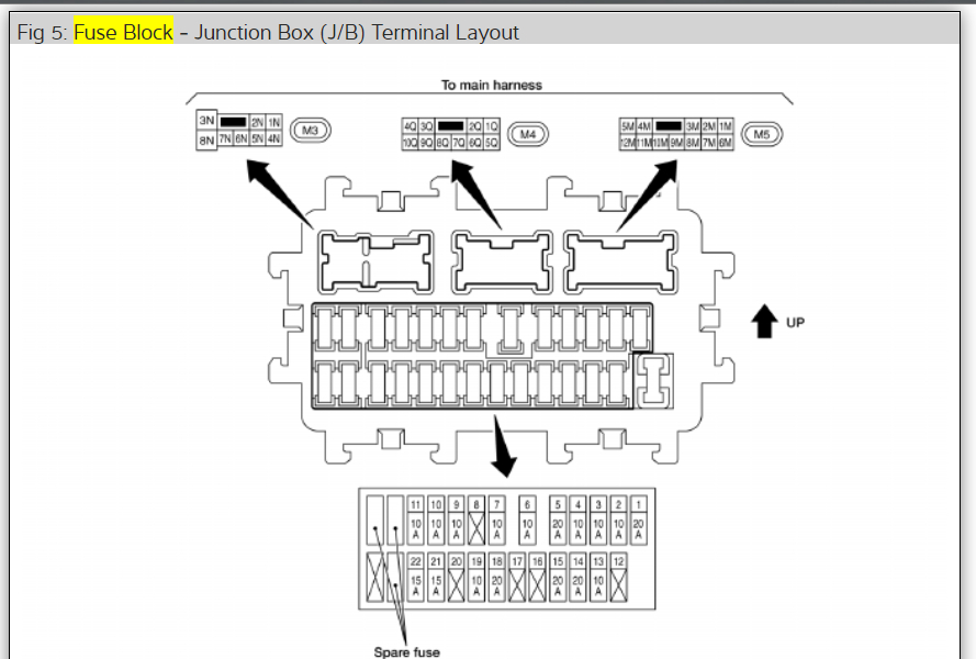

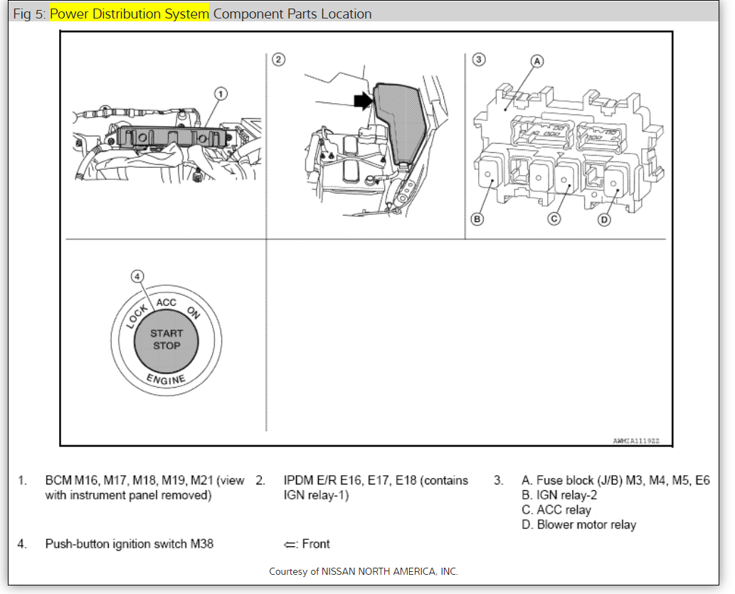

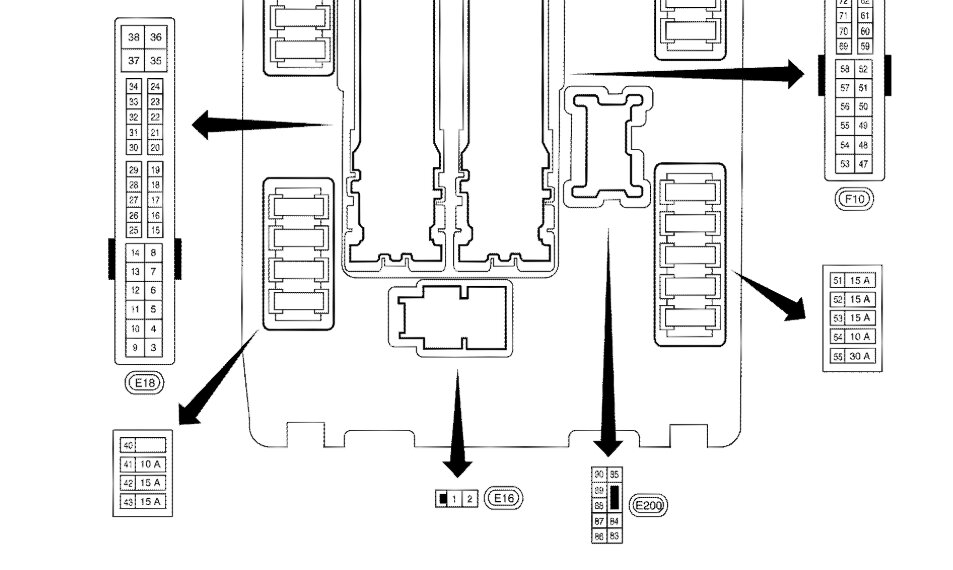

It sounds like the crankshaft sensor has gone out, but to be sure we should check all fuses, here is a guide that will help:
Here are the fuse locations in the images below, if the fuses are okay, we should do a CAN scan, you can get a CAN scanner (Controller Area Network) which will work on most cars from Amazon here is a video to show you how.
https://youtu.be/u-4syLc-ifQ

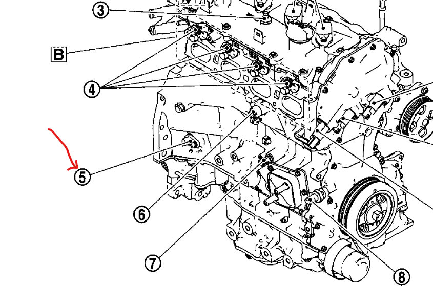

Here is how to change out the crankshaft sensor as well in case you need it. Check out the images (below). Please let us know what happens.
