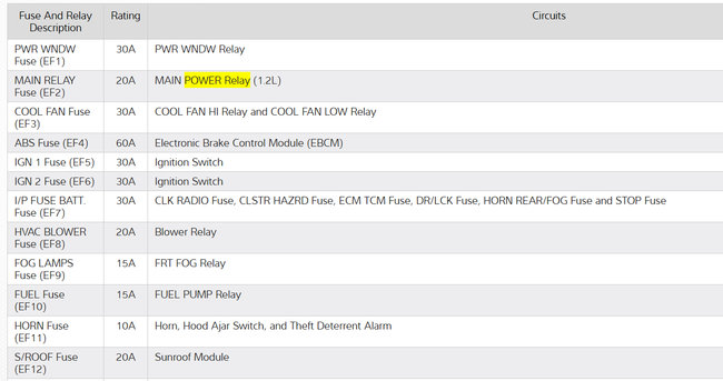

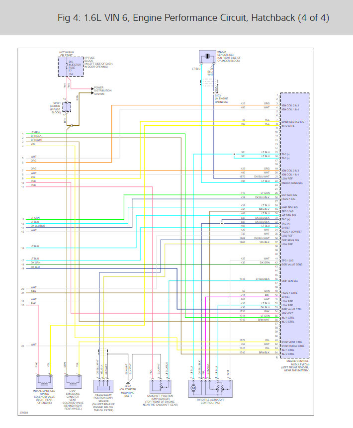

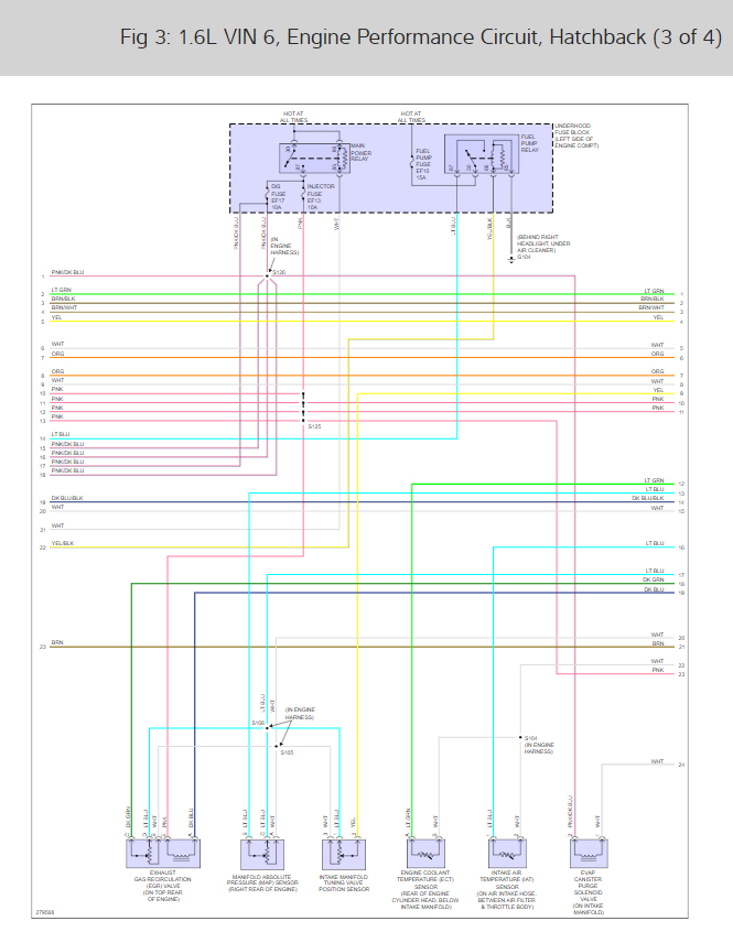

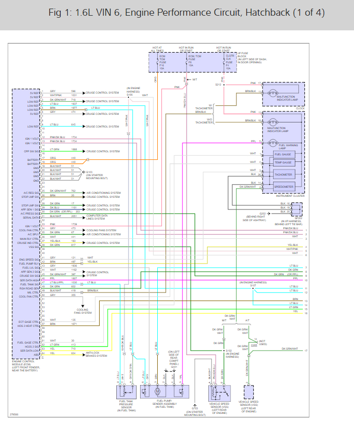

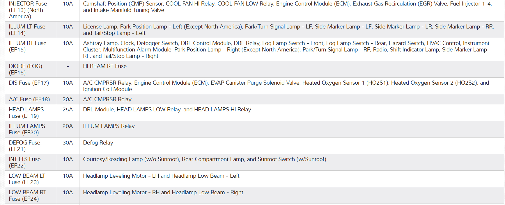

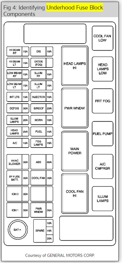

Car was running then shut off. Will turn over, has gas, but no spark. Replaced coil pak and crank sensor.
May 3, 2018 at 6:11 PM
Experienced Mechanic
55,594 POSTS

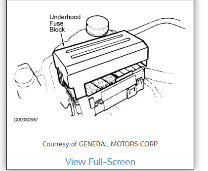

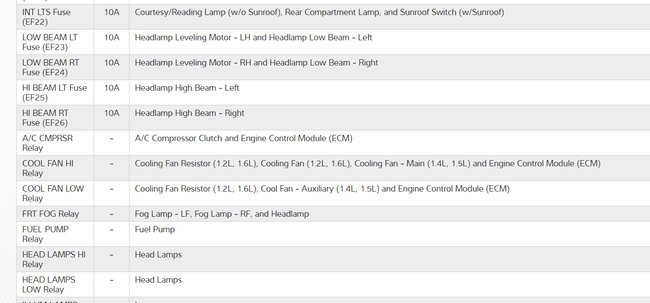

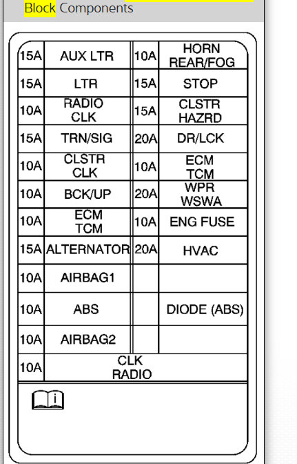

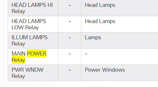

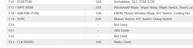

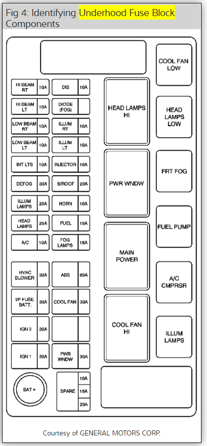

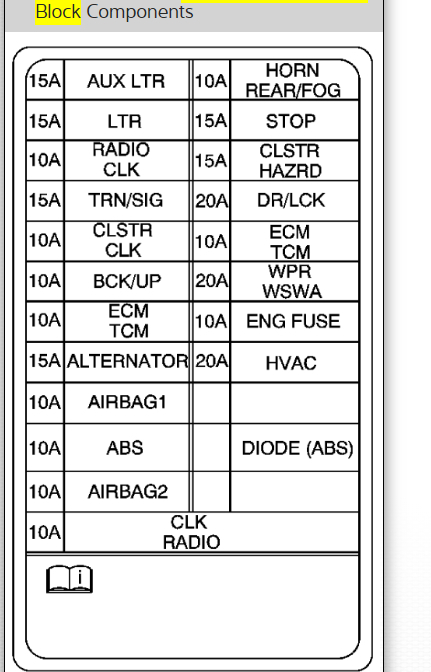

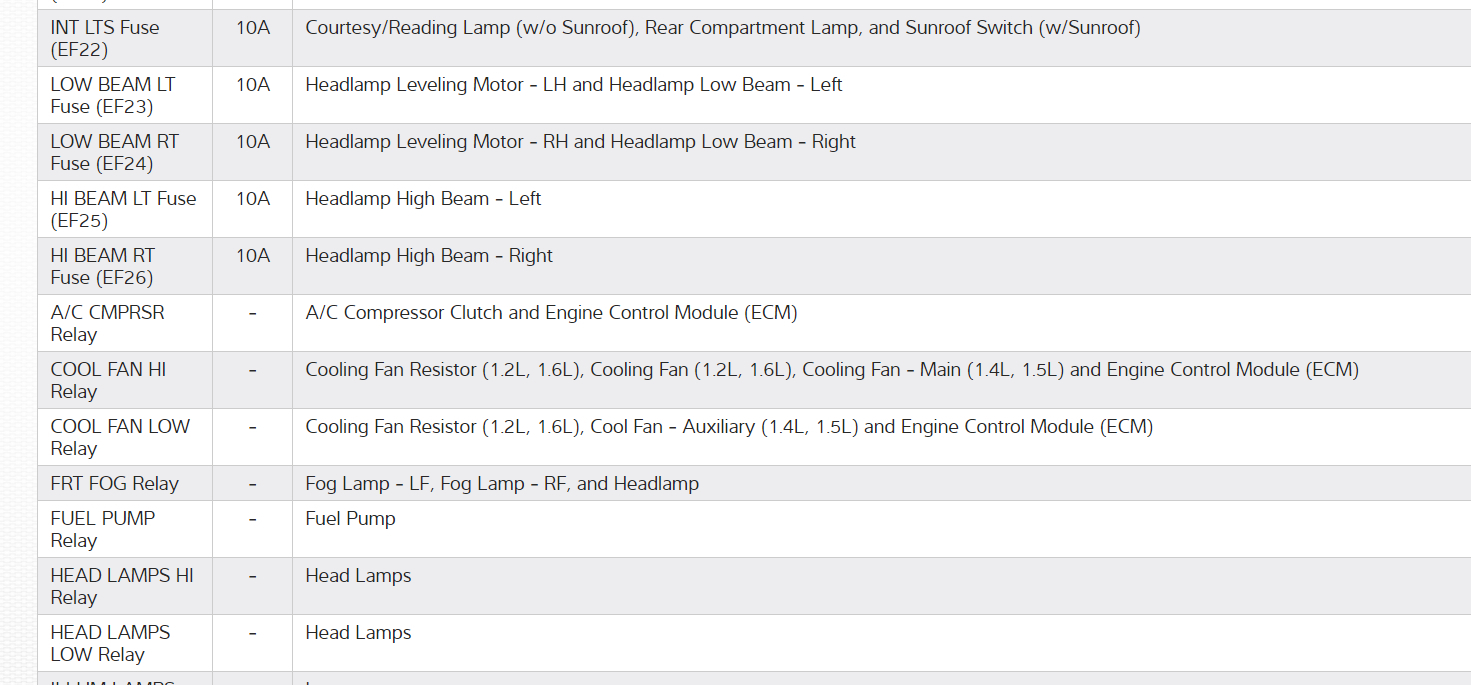

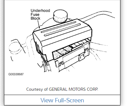

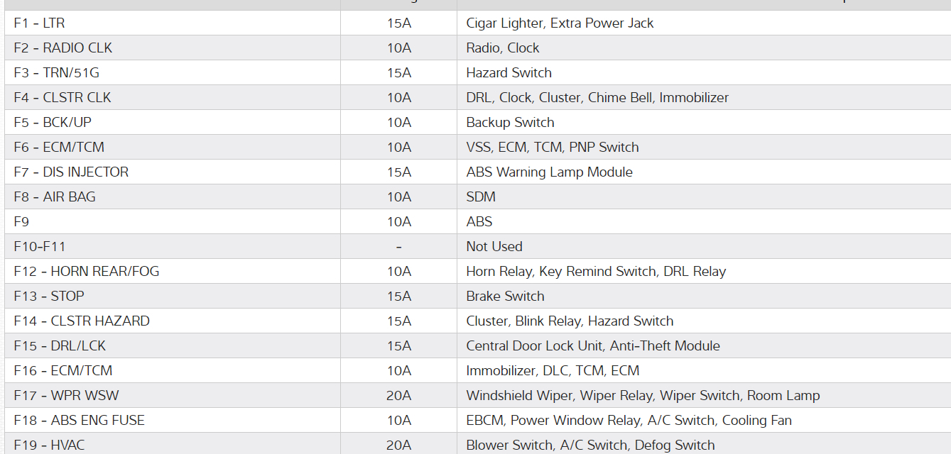

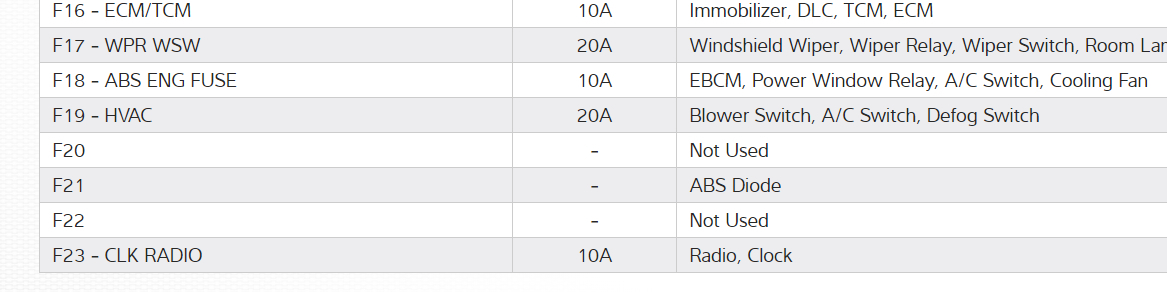

It sounds like the main power relay is not working. Here is a guide to help you test the relay:
Here are the fuse panel and relay locations for your car. Check out the diagrams (below).
