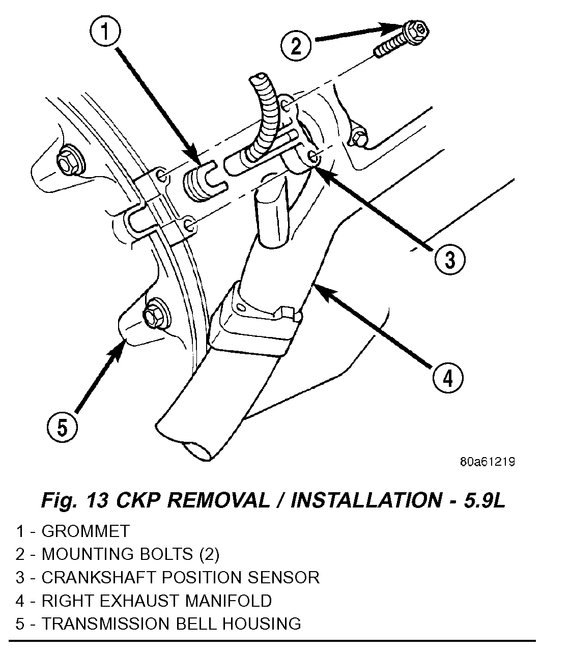

My truck just quit running while idling. Thought it was out of gas. After putting gas in it still will not start. Tried starter fluid engine acts like it wants start but it doesn’t. No Spark. Fuel was super low that morning and my husband said he doesn’t think it is moisture in the tank. Any ideas?

If you lost spark, chances are it is the result of a bad crankshaft position sensor. Take a look through this link:
Since it doesn't start with starting fluid, chances are you are correct, there is no spark. Here is what you can do. First, if you can get a live data scan tool, connect it and crank the engine to see if there is an RPM signal. Or, if the truck has a tachometer, see if it moving when cranking. It should show between 100 and 200 RPM's. If it doesn't move or there is no RPM signal, my first suspect is the aforementioned sensor.
Here is a link that shows in general how one is replaced:
Here are directions specific to your vehicle. The attached pic correlates with the directions. Note: The Crankshaft Position (CKP) sensor is located near the outer edge of the flywheel (starter ringear).

Fig. 13 CKP Removal/Installation - 5.9L
see pic 1
REMOVAL
The sensor is bolted to the top of the cylinder block near the rear of right cylinder head.
1. Raise vehicle.
2. Disconnect crankshaft position sensor pigtail harness from main wiring harness.
3. Remove two sensor (recessed hex head) mounting bolts.
4. Remove sensor from engine.
INSTALLATION
1. Position crankshaft position sensor to engine.
2. Install mounting bolts and tighten to 8 Nm (70 in. lbs.) torque.
3. Connect main harness electrical connector to sensor.
4. Lower vehicle.
