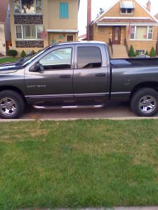

EVERYAN2003
Trying to find out what would cause my Ram to overheat within a mile of driving.
I tried last night to disipate some of the heat buildup by turning on the heat and noticed there was still cool/cold air coming from the vents. After about 15 min hot air started coming out. I checked the oil when it cooled down and saw it was a quart low. Would being a quart low cause my engine to overheat that fast at low speeds or does this seem to be a thermostat issue?

DOCFIXIT
  • 18,828 POSTS
Hi
Thermostat replacement is good idea also consider flush at that time. Check to see if fan clutch is locking up when at op. temp. ie. should be hard to turn by hand.
Let me know

EVERYAN2003
Turned out to be a hairline crack in the radiator frame. Replaced the radiator as well as the thermostat and all is good. Autozone had a direct replacement that made the swap really easy. Thanks for the response and informative website.
https://images.2carpros.com/forum/automotive_pictures/561486_080707_195756_1.jpg

DOCFIXIT
  • 18,828 POSTS
Glad it worked out those plastic tanks make it hard to find a leak. Join us again
