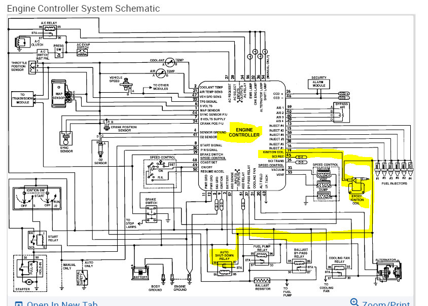

i have a 1994 jeep Cherokee that i put a motor in out of a 1991 Cherokee, swapped engine harness and all plugged everything back in. I am not getting spark i have replaced the crank sensor and checked the distributor still nothing can't find a diagram to tell me where the coil pulls power from

The ignition coil is powered by the ASD relay and controlled by the engine controller. I attached the only schematic I could find below. I highlighted the relay, the power wire to the coil, and the coil.
