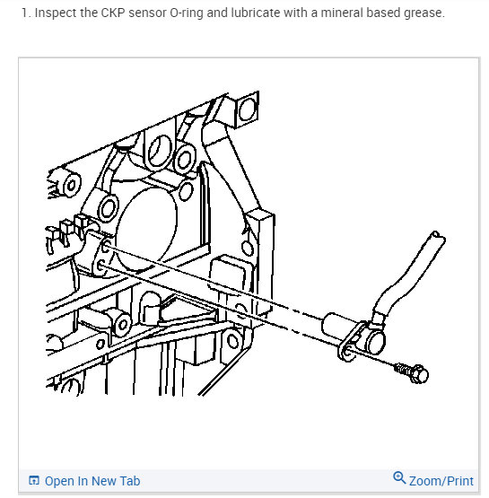

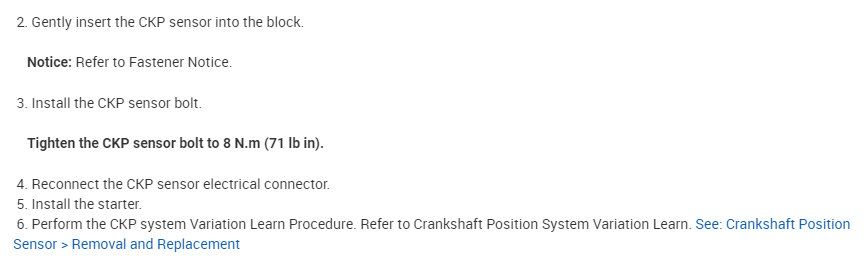

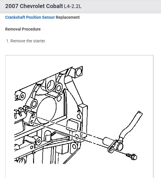

I agree with you. If you have no spark and the tach isn't moving, the first suspect is the crankshaft position sensor.
Here is a link that explains in general how to replace one:
If you look below, I attached the directions specific to your vehicle. On this engine, you will need to remove the starter motor to access the sensor.
