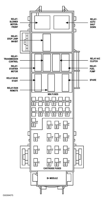

Changed the battery in my vehicle tried to crank it would not start. The next day it cranked every time. went out the next morning to warm up the truck by the time I went out to get in it had shut off and has not cranked since. We replaced the cam sensor and the crank sensor but still not getting spark. it turns over but it is not catching.
Dec 19, 2017 at 10:40 PM
PATENTED_REPAIR_PRO
  • 1,853 POSTS
Check fuse #10 in the power distribution center (PDC) located under the hood, left (drivers) side.
If that fuse is okay, try a new automatic shutdown relay in that same PDC or swap a non important relay of the same type into that spot and try again.
The front blower motor relay looks the same and is right next to that ASD relay, see the diagram below.
