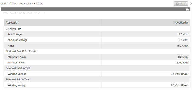

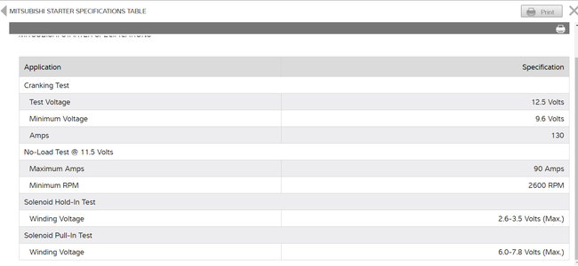

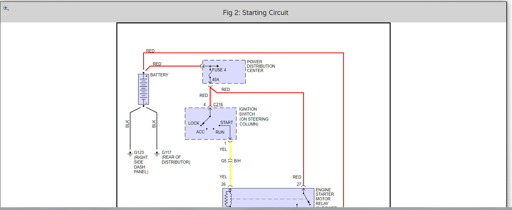

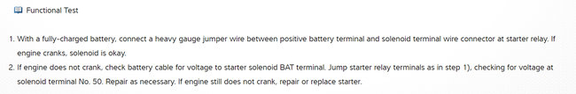

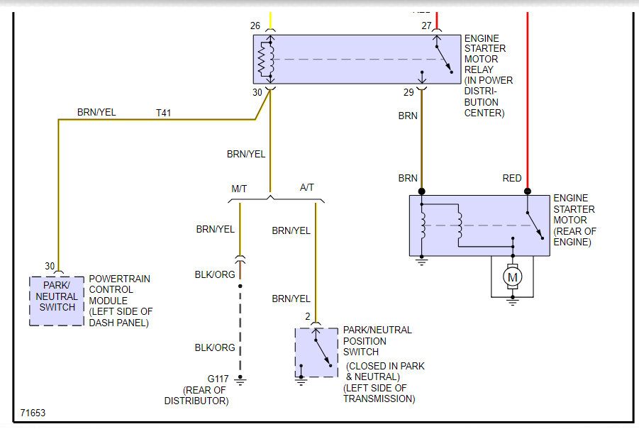

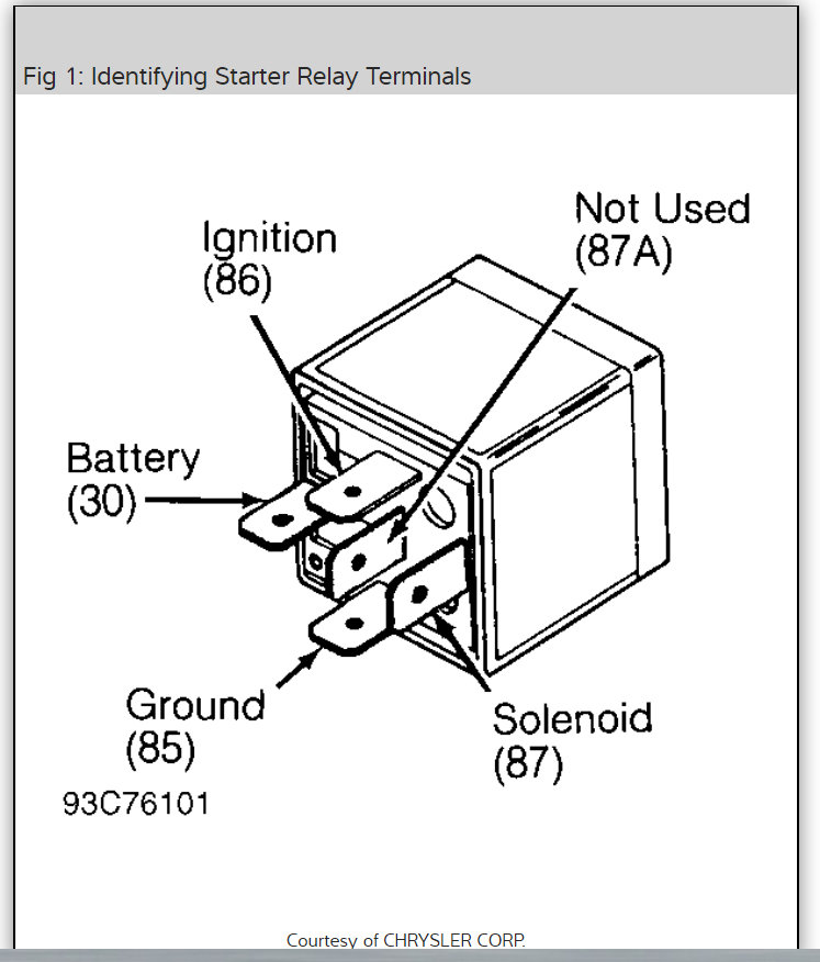

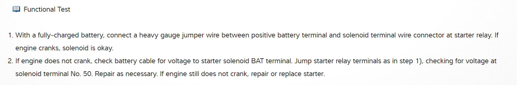

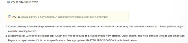

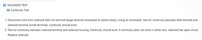

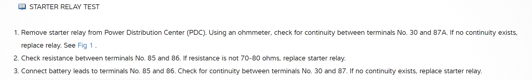

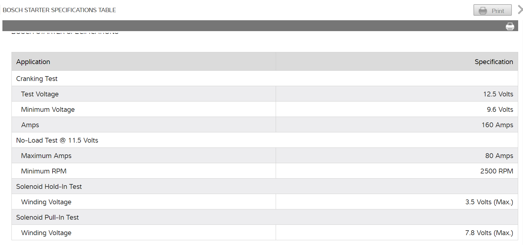

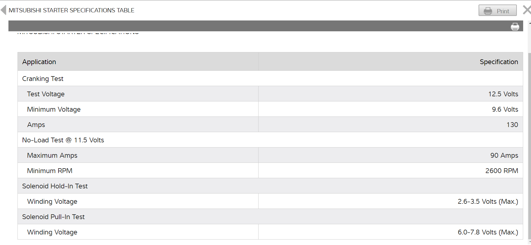

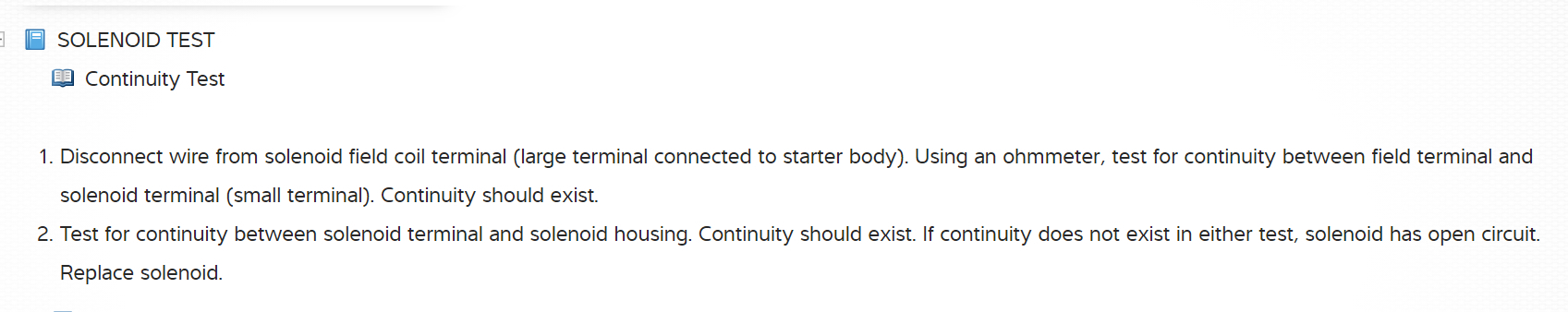

This could be a problem with the wiring going from the Underhood Junction Box to the starter itself. I have included in the diagrams down below a troubleshooting guide for your vehicle's Starting System as well as wiring diagrams. Please go through it and get back us with what you find out.

Okay, wire seems to be good.
