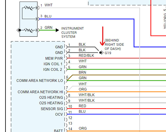

No spark after replacing clutch. The first code said crankshaft position sensor. we replaced still no spark.

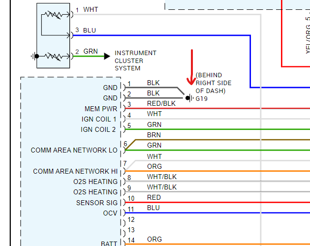

The number one reason for no spark after repairs is one of the system grounds has been left off and is not connected. The only thing is, it says the PCM grounds are at the right side of the dash, did you do any work in that area? Check out the images (below). Let us know what you find.
