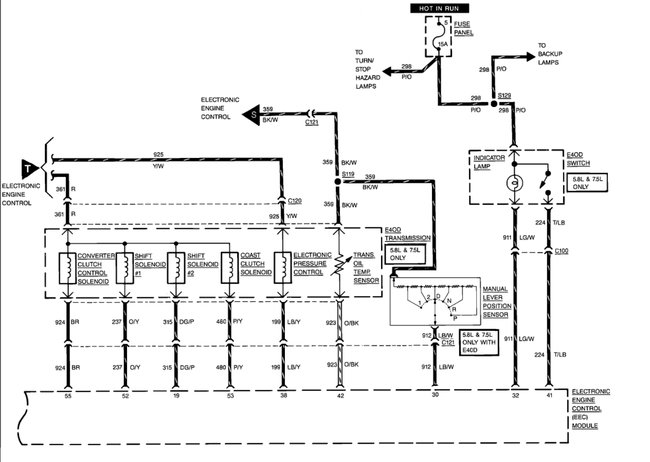

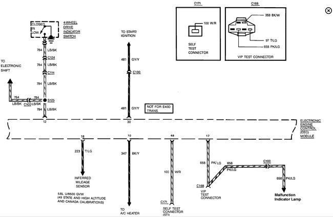

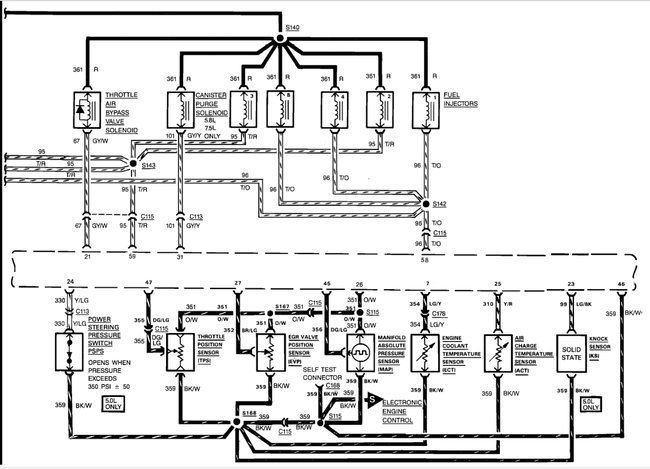

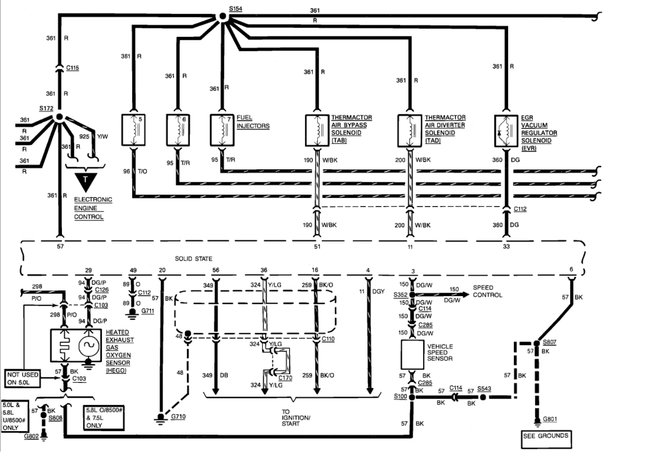

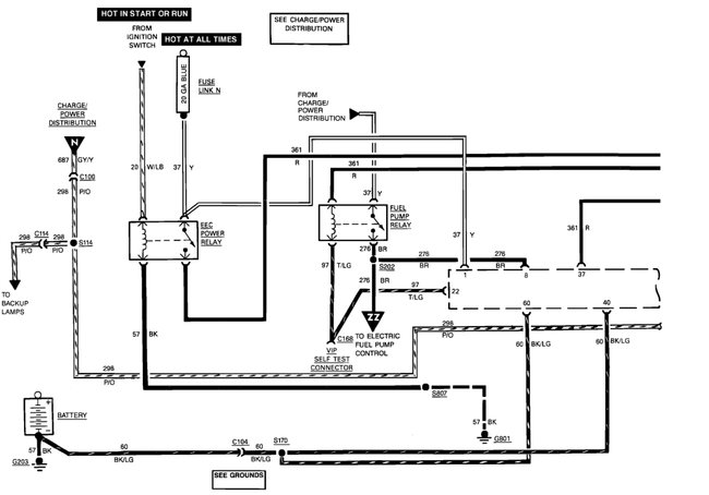

It does sounds like you have a wire that is grounded here is a guide and some wiring diagrams so you can do some testing.
Please let us know what happens and upload pictures or videos of the problem.

Did some checking while waiting for a diagram. Found a burnt fusable link by starter relay. Touched it back together with key on and it gets hot. Did tracing and came down to the ecc relay if unplugged while turning key on the fuseable link doesn't get hot. Thats as far as I got and need time to get back at it and look at the diagram you sent me. Thank you
