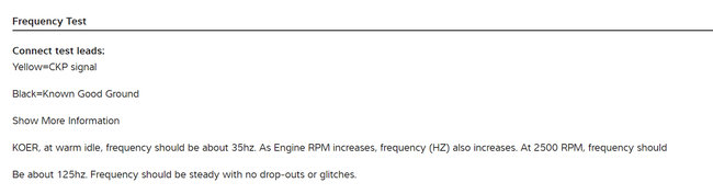

I have injector pulse, fuel pressure, had multiple misfire code 300, when it ran for a day power to coil 2 pins, no pulse from coil lead. all fuses good, relays good, no sensor codes. just bought it. feels like a bad coil when running, all sensors look like they have been replaced, timing on top dead center. coil is in distributor. how do I check coil values/crank sensor/ PCM/cam sensor no spark at plugs ?

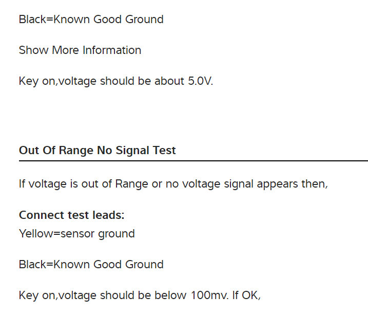

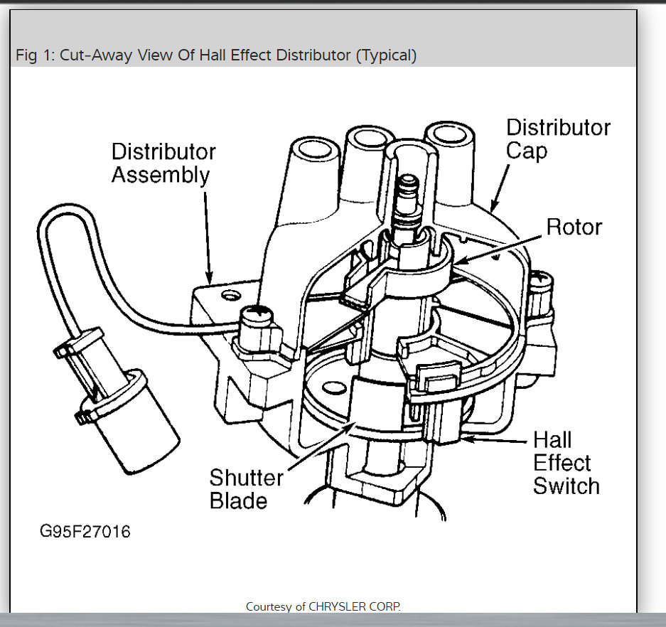

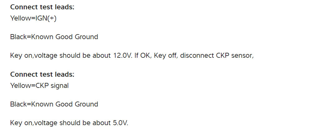

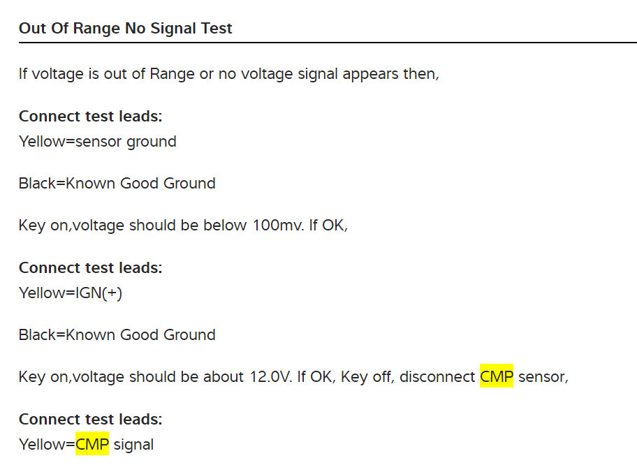

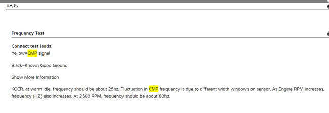

This could be a problem with your vehicle's Camshaft Position Sensor (CMP), which is located in your vehicle's coil assembly. I have included a description of your vehicle's CMP and factory diagnostic troubleshooting procedures for testing the CMP in your vehicle down below in the diagrams. Please go through this guide and get back to us with what you are able to find out..
Thanks,
Alex
