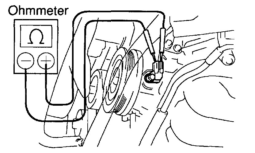

No spark from coils, no rpm on rpm gauge. Had multiple misfire code and -40 on coolant temperature sensor with code.

If there is no RPM signal, the first thing I would check is the crankshaft position sensor. Take a look through this link:
Here are directions specific to testing the one on your vehicle. The attached pics correlate with the directions.

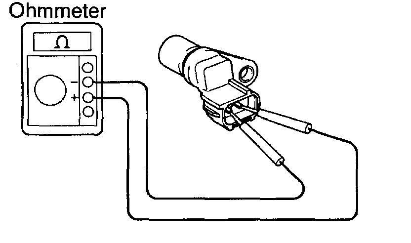

INSPECT CRANKSHAFT POSITION SENSOR RESISTANCE
Using an ohmmeter, measure the resistance between terminals.
Resistance:
pic 1
pic 2
pic 3
RESISTANCE
If the resistance is not as specified, replace the crankshaft position sensor.
