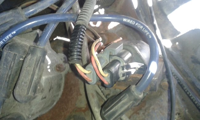

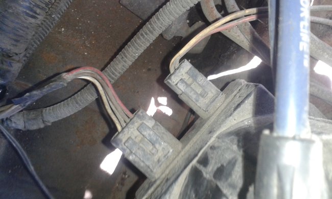

Engine start but no sparks. I check the coil but no sparks. The coil has four terminal post on it. Two pink and two white. The pink wires has twelve volt on them. But the two white have nothing.

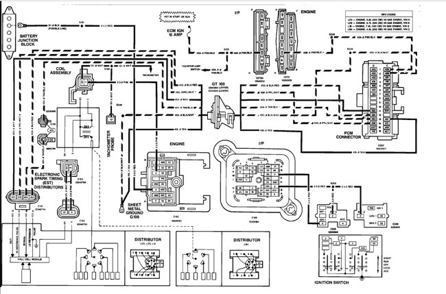

It sounds like the ignition module has gone out but to be sure here is a wiring diagram and a guide so you can check for power, if power is there I would replace the module.
Diagram below
Let me know what happens.
