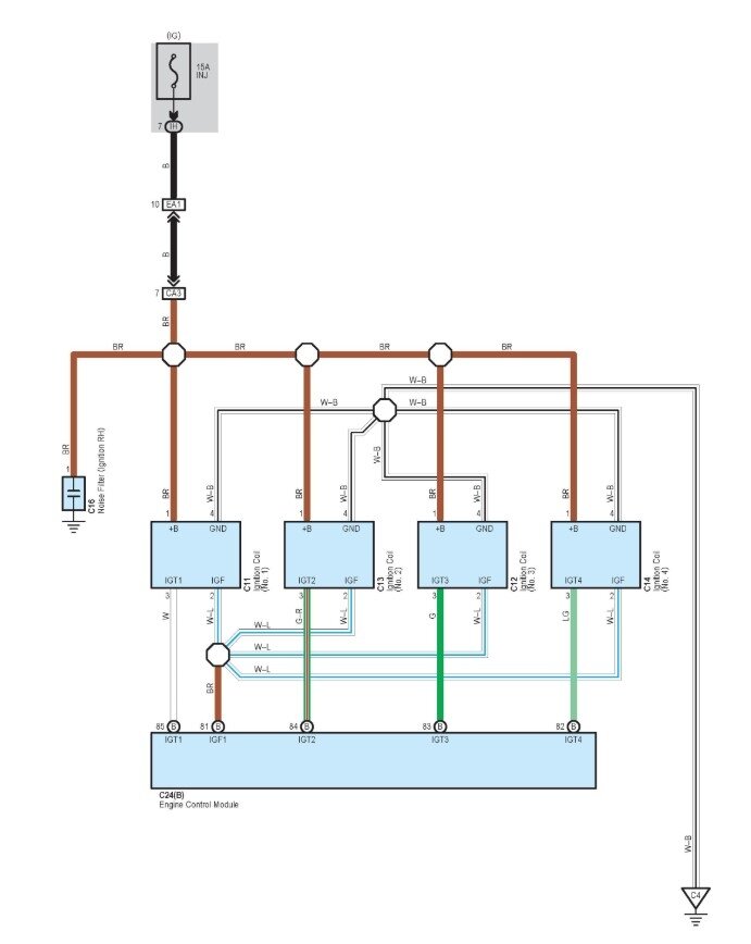

engine crank but want start no spark to the spark plugs no spark from all the coils what all can cause no spark from the coils?

No spark from all the coils can be caused by a bad ground, bad power or no signal from the ECU. Refer to the attached for the powers and grounds. To test for power you can use a test light. Connect it to battery negative, then turn the key on and probe the Brown wire, if there is power then connect the light to battery positive and test the White wire with black to see if there is a ground. If you have both the power and ground then the next thing would be to test the ECU for it's powers and grounds to see if it failed in some way.

there is no power at the brown wire when I connect my test light to it. this is what I did I disconnect the wire connector from the coil and turn the key on and connect my test light to the brown wire at the coil my test light didn't light up.

Okay, take the light and test the 15 amp injector fuse in the left side dash fuse box. Key on it should have power to both sides. If it does go to the noise filter at the top rear of the engine and unplug it, do you have voltage at that plug? If yes, check at a couple injectors. If not and the fuse was good you have a break in the brown wire.

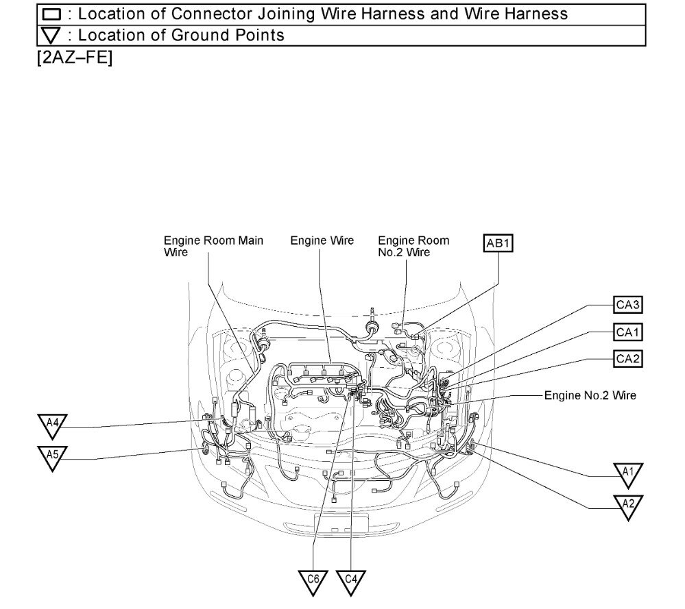

I don't under what you mean about noise filter? what does it look like? I really do need a book with the engine control wiring diagram that will show me where the wires run to from the coils, fuel Injectors, crankshaft position sensor, camshaft sensor and more.

The noise filter is a capacitor that absorbs the electrical noise created as the coils fire. They can short internally and normally cause the fuse to blow. The nice thing about this vehicle is that is the entire power system for the coils and injectors and it should have power with the key on. Do you have any type of aftermarket alarm or kill switch installed? If not and key on you have no power there but the fuse is OK you could try running a bypass wire for testing. Just use a wire with a 15 amp inline fuse and connect it between the battery positive and the brown wire and see if it now starts. If so then the wiring has an issue. They don't really tell you where the wires run, just that they are in the harness. Attached is an example of the engine harness.

It runs to the injector fuse in the dash fuse box. There are a couple connectors in the line as well and it feeds power to a couple items, but the power to the coils is a single circuit that is fed from the fuse without going through anything else.

I Unplug all the coils and use my test light and connect it to battery positive, with the coils unplugged I touch the test light to the brown wire on the coil connectors the test light didn't light up. I replace a 15 amp Injector fuse in the fuse box inside the car and turn the key to run and took my test light and connect the alligators clip to the negative battery post and the other end to the brown wire at the coil connector and my test light came on and I also connect my test light to the white wire with a light blue stripe next to the brown wire in the connector and the test light came on do power suppose to be in those two wires when key in in the run position? a few minutes later the coil and connector start smoking.
Nov 17, 2025 at 10:35 AM
STEVE W.
  • 15,349 POSTS
OK the brown wire having power with them all unplugged shows that you have at least one bad coil, The blue/white wire is ground. From those tests I would say you have two problems, the smoking coil(s) are bad and the driver for the smoking coil is bad. That is inside the power control module. With it stuck on it holds the power on full time to that col and has burnt it out, OR the coil failed and took out the driver transistor, either way is possible. So you need a PCM and I would replace the coils as well.
