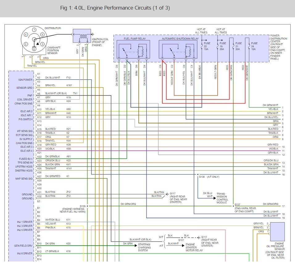

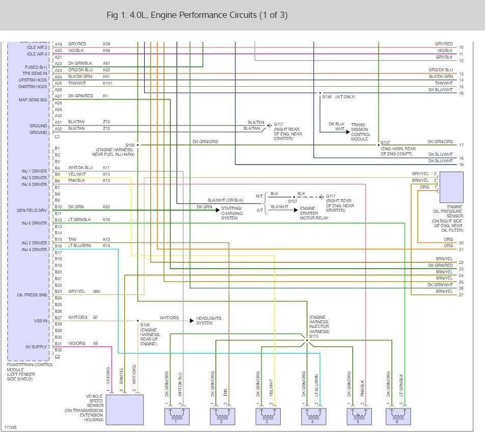

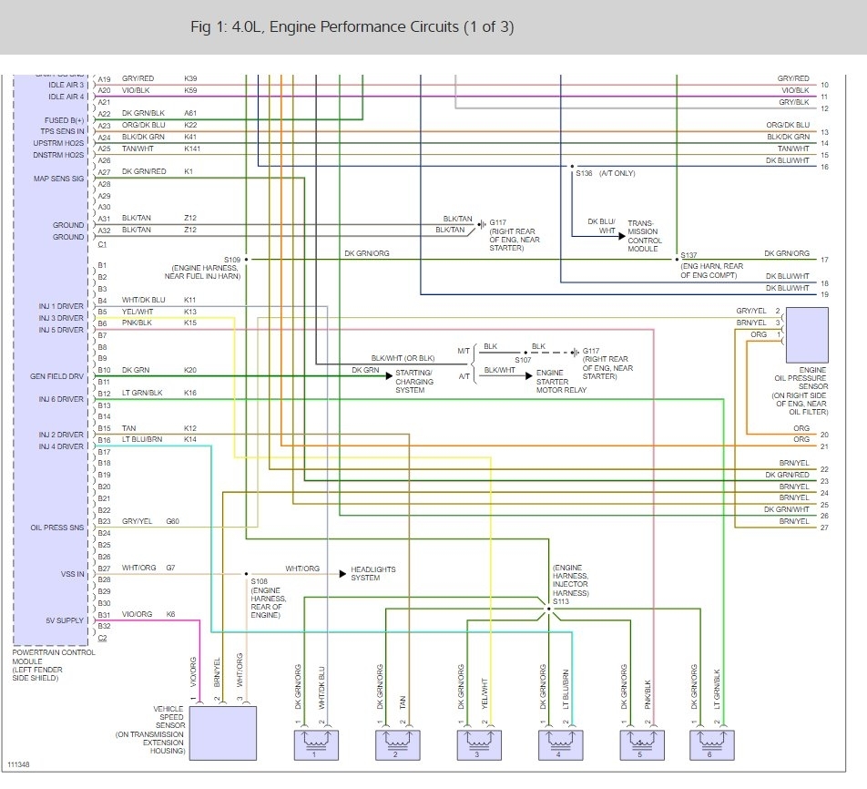

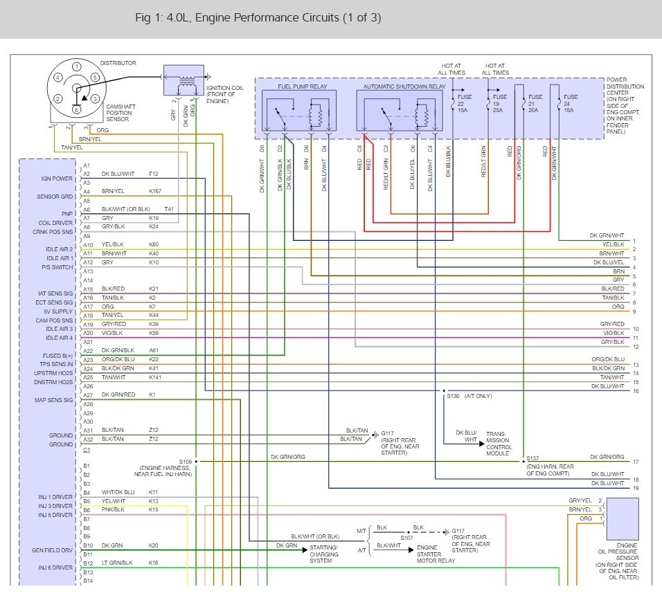

Turns over but no spark. replaced coil pack and crankshaft sensor, but still no spark.
Jun 16, 2017 at 10:05 PM
  • 55,711 POSTS
It sounds like you have an ASD relay that is not working. Here is some wiring diagrams (below) and a guide to help you do some testing, Also there are fuses that run the system as well.
and
and
Please let us know what happens, we are interested to see what it is.
