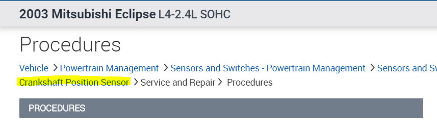

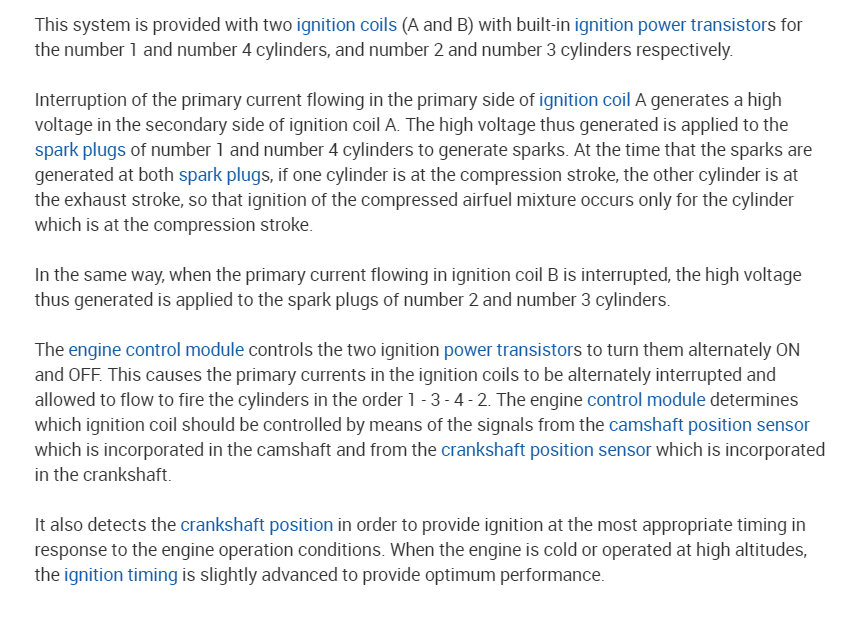

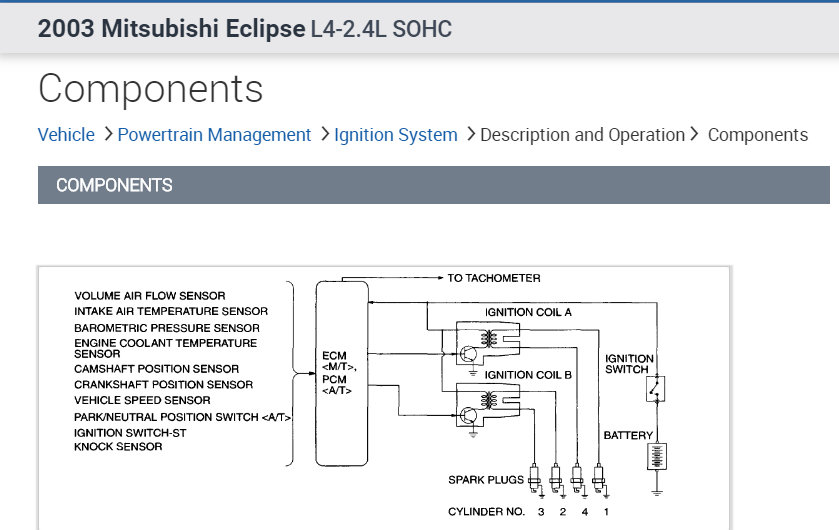

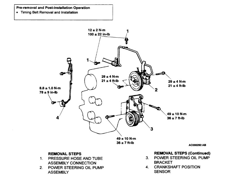

This could be a problem with your vehicle's Crankshaft Position Sensor [CKP] which is responsible for sending a signal to your vehicle's Power-train Control Module [PCM] telling it where the crankshaft is in the engine's 4 stroke process. The PCM uses this information to synchronize the ignition timing for the spark plugs and for the misfire monitor. In the diagrams down below I have included a wiring diagram of the CKP sensor circuit and a diagram showing your vehicle's CKP. Here is a link describing how to change it below:
